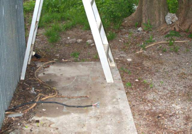

This is what was feeding the shop, 150 feet of 10-3 indoor wire just laid on the ground. Some of it was buried only because it had been in place for years and leaves turning to dirt covered it.
The wire you see not terminated ran to a large 220 compressor that sat on the cement pad. The previous owner had a large MIG welder, a Bridgeport mill, a large 220 volt 3 phase lathe with phase converter and several other pieces of machinery and welders running off this mess. Have no idea how he kept from having a fire. Heck the lights would dim when the air conditioner would come on.
Needless to say it's all fixed now.
