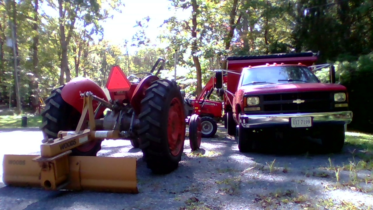

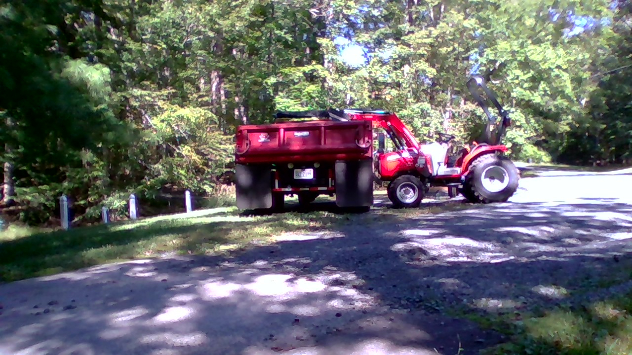

I myself never thought about a dump trailer. I came across a good deal on a 1999 Chevrolet 3500 1ton dually with a very nice Heil dump bed, That I use on my property for gravel, top soil, fill dirt & to hall away yard debris . I have a 2003 Silverado 1/2 ton that I use to pull my travel trailer & a 18 foot car trailer I also had 2 boats that i was not using since I acquired the travel trailer & the 1 boat was free a 1977 the other a 87 & they needed some work to get them running again , Long story short I traded the 2 boats & gave him a couple grand for the dump truck & the mileage was at 52,000 & at the time it didn't need hardly anything done to it & I have had it for 5 years now & over that time I've put a grand into it normal wear & tear items & I still get offers for way more than what I've paid for it.1 other thing I like about having a small dump truck I can pull either one of my tractors with it & still be able to haul a load in the dump bed. & I'm not saying this is the way to go , But for me it was Because I didn't have the space for another trailer & I got rid of stuff I wasn't using & it was cheaper for me than buying a new dump trailer. 1 other thing check into insurance rates, If I had the choice I would go the same way the truck has a 5.7 Vortec (350) with a 4 speed auto. trans.
