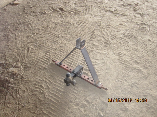

Here is one that I did as an early welding project. The welding could be a lot better, but it will give an idea of one approach. Note, the weight and pull is on a heavy duty drawbar, so it should hold. My welds are just keeping it upright.
   / Want to make ball hitch attachment for the three point lift, Any made? #6
Here's the thread I posted after making mine: My 3 point trailer hitch project
If I were to do it again, I would put the hitch on the inderside, then bolt through the drawbar into a plate on top, which I would weld the vertical part.

You either need to get one like others have posted, or you need an anti-rotation bracket if you only use the lower arms like you are talking about doing

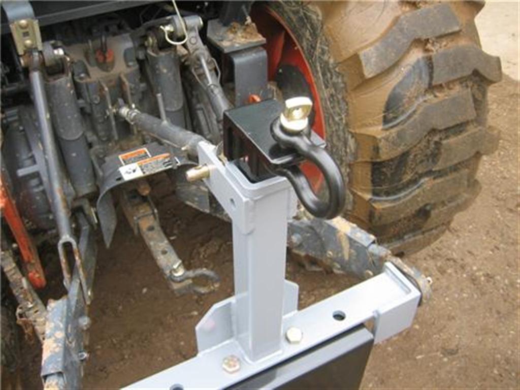

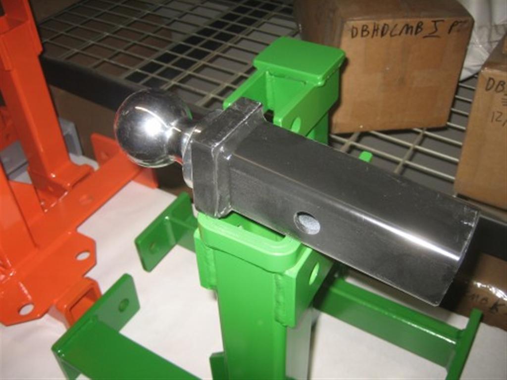

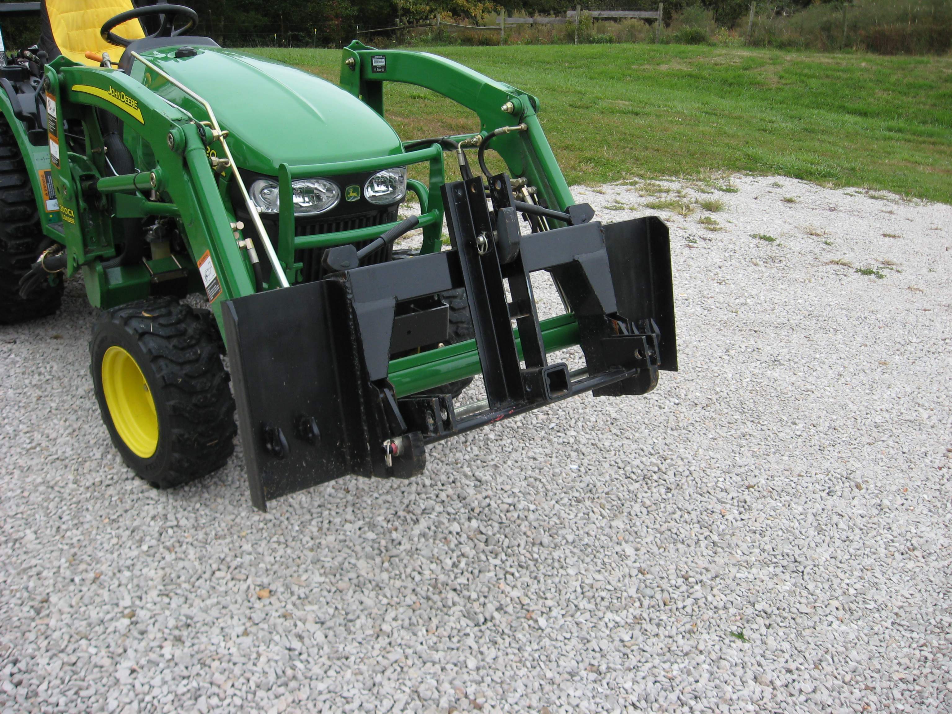

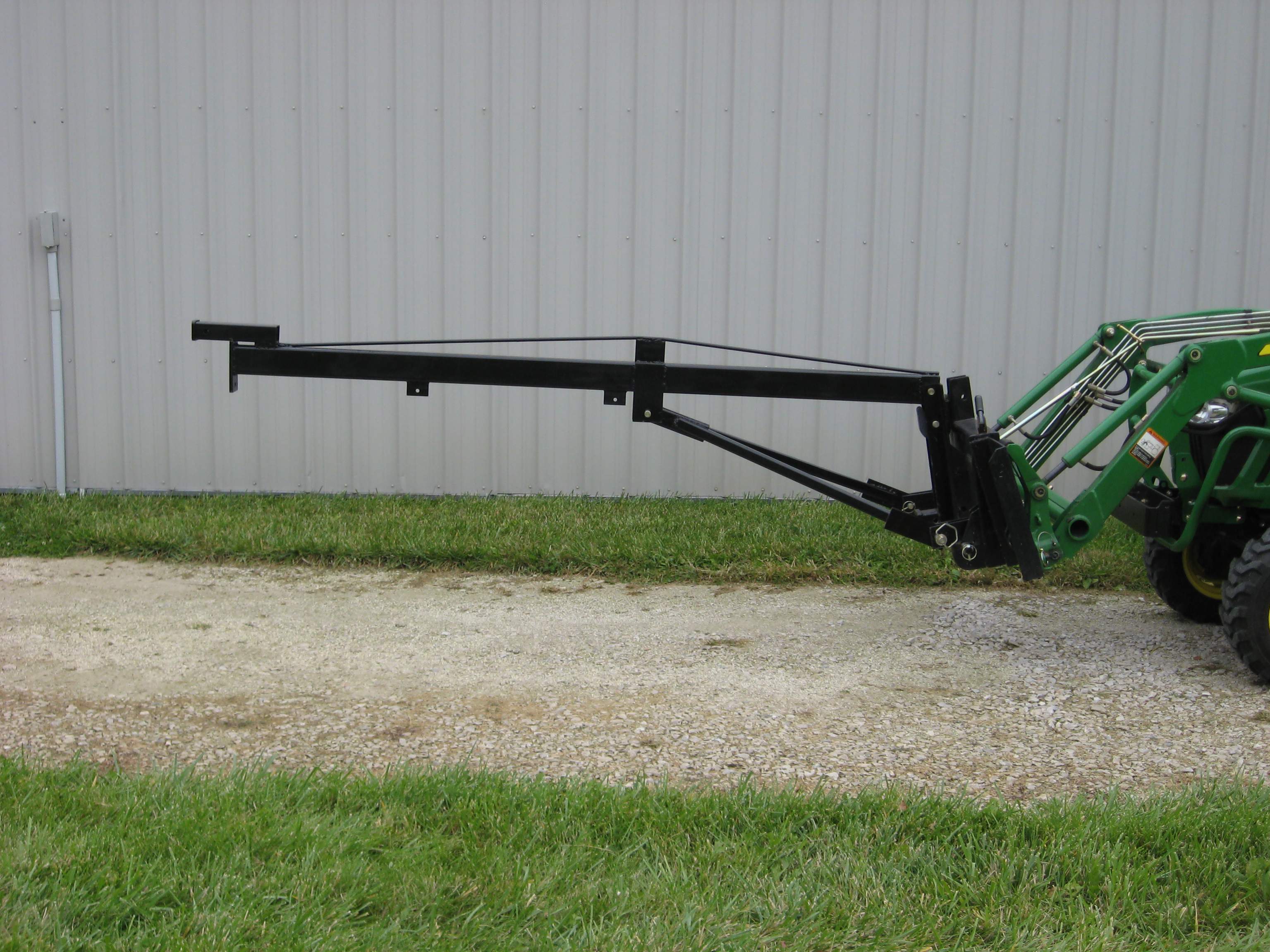

I liked this design so much that I bought one! :)
The top receiver makes it very versatile.
Got it from: OMNI Mfg LLC
