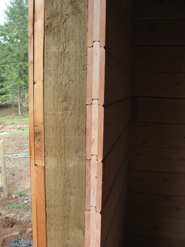

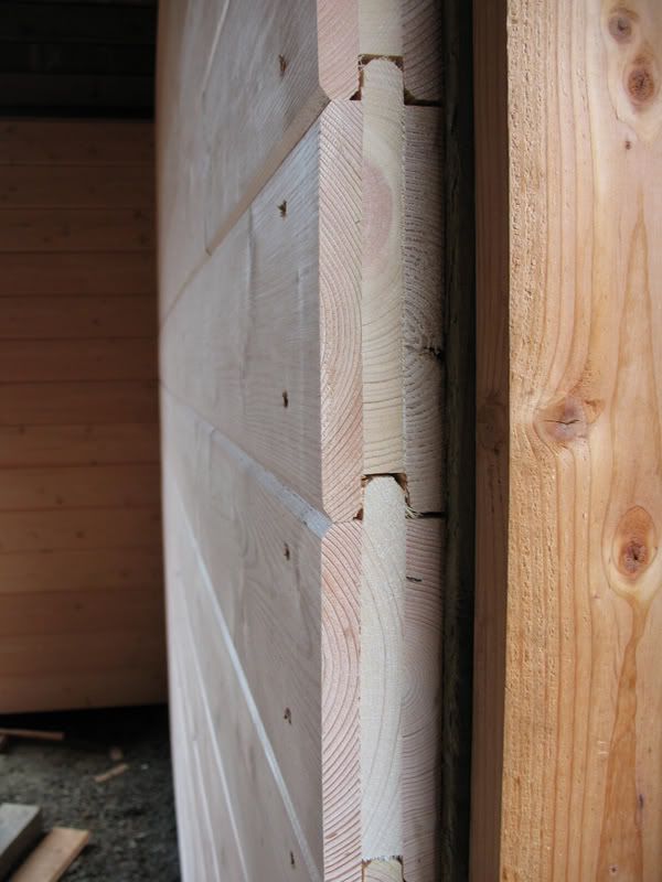

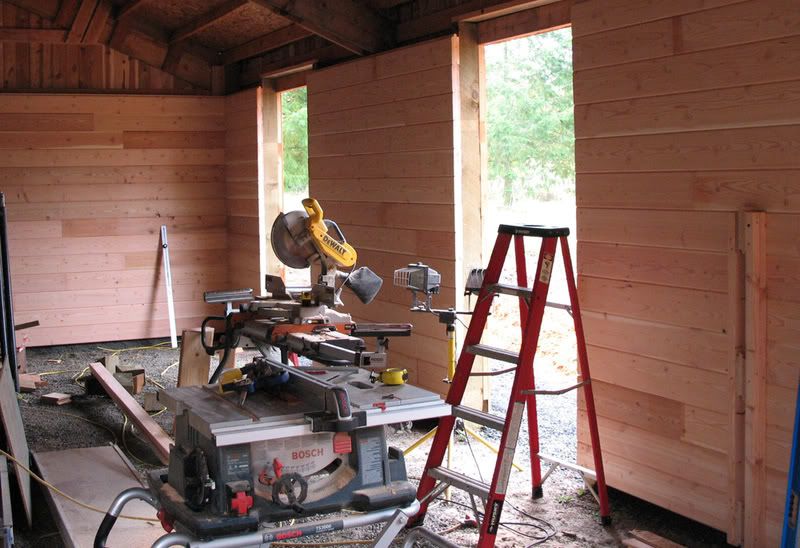

It's been a while since I've updated. I've started on the walls for the stalls. I've managed to complete the exterior walls. I hope to get the divider walls and maybe one of the fronts up tomorrow.
I think it's coming out great. Esepcially, since like all the siding these boards are supposedly reject. All I can say is those boys at the mill sure are picky. There's only been a couple of sections that I've been able to tell why they were thrown in the reject pile.
Don't mind the mess...haha.
Rejects???
The 6" post, 2" stall material, purlin, and siding make for a stout looking wall.

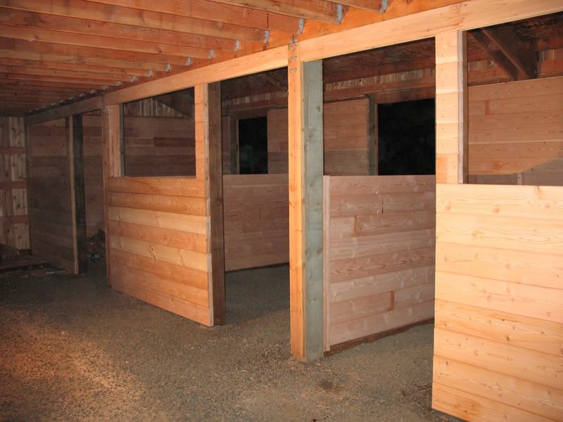

I've managed to get the stall divider walls up and have the wall on one stall front finished. I'll put up some more pictures when the remaining two stall fronts are completed. It's looking more and more like I might be able to get the horses in the building by the time we go out of town toward the end of the year.

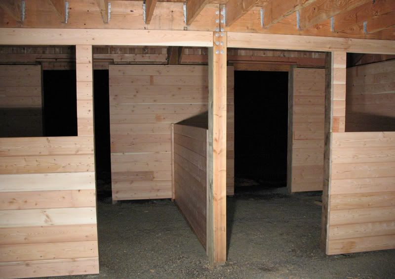

As promised here are some pictures take tonight of the stall fronts and dividers. Still have to build and hang doors and install the balusters (conduit, my horses aren't historically hard on stalls and get along well). I had one 14 foot board of the 7" material left when finished....that was a close one.

Steel Dust - Your horses will spoiled ... that is absolutely top drawer quality and detail!
You have done a very nice job!
