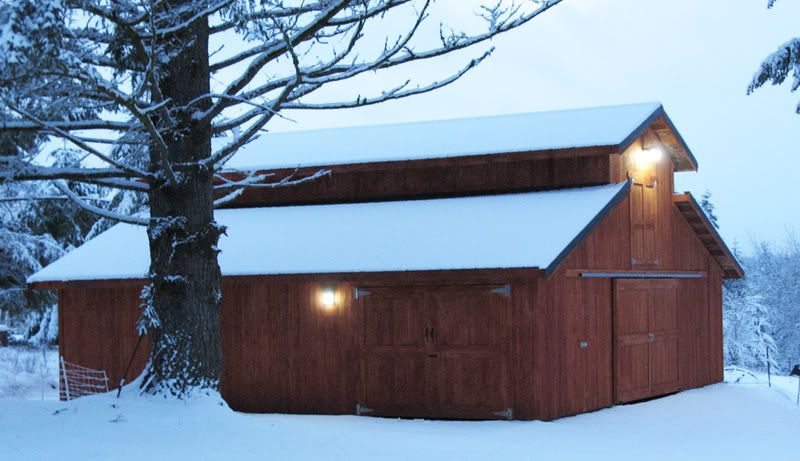

Thanks for the great pictures. The snow looks amazing. Cold and miserable, but still amazing!!
How about some overall pics of your entire barn in the snow? I really think that it has such classic lines to it that seeing all of it in the snow would be very impressive.

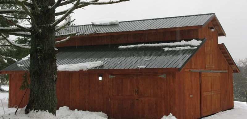

I took a few during the fist day of the recent snowfall, this is the only one that really turned out decent.
I took this picture this afternoon, with just a little bit of warm up, the barn has nearly shed all of it's snow load. I wish I was around to see it all come off, but glad I wasn't standing under it. :D
I also recognized a small design flaw. One that those in areas that see lots of snow probably realize all too well. If you just have to have a set of swing out doors on your barn, as I did, put them on the gable end, not on the eave end, where the entire snow content of the roof is going to drop. I spent a good 20 minutes shoveling out enough to get my doors open in order to get the tractor out.

That would look great parked beside my house , great work :). You may need to think about adapting a sliding track above the swing out doors to convert them to sliders so they can be easily opened when snowing .
   / Want to see yet another pole building? #145
add snow stops to the roof above the door it'll save your back for sure.

Since I don't live in an area where snow is an issue, or have ever lived in such an area, I would never have thought about that door swinging out either. In fact, when you said you had a problem, my first thought was if the snow coming off of the first roof was causing some damage when it hit the second roof.

What do "snow stops" look like?
   / Want to see yet another pole building? #149
Very nice barn!!
I think snow stops are about 6"- or more long (like angle iron- staggered) that attach to the roof, and slow down movement of large amounts of snow from sliding off and causing injury to people or property below the doorway. I see quite a few of them on restruants and commercial buildings.
