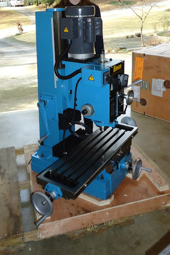

I had a bench model drill press for a lot of years, it worked kind of.
A few years ago I ran across an old milling machine and purchased it, I have a few mills and do use it as a milling machine when I need it,
but most of the time it has the drill chuck mounted on it, it works great I have never used a drill press that was better. So that would be my recommendation
a good 1to 2 hp milling machine with a drill chuck.

i too would recommend a milling machine. i got a benchtop mill a couple years ago and sold my drill press. so much more versatile. you won't regret it.

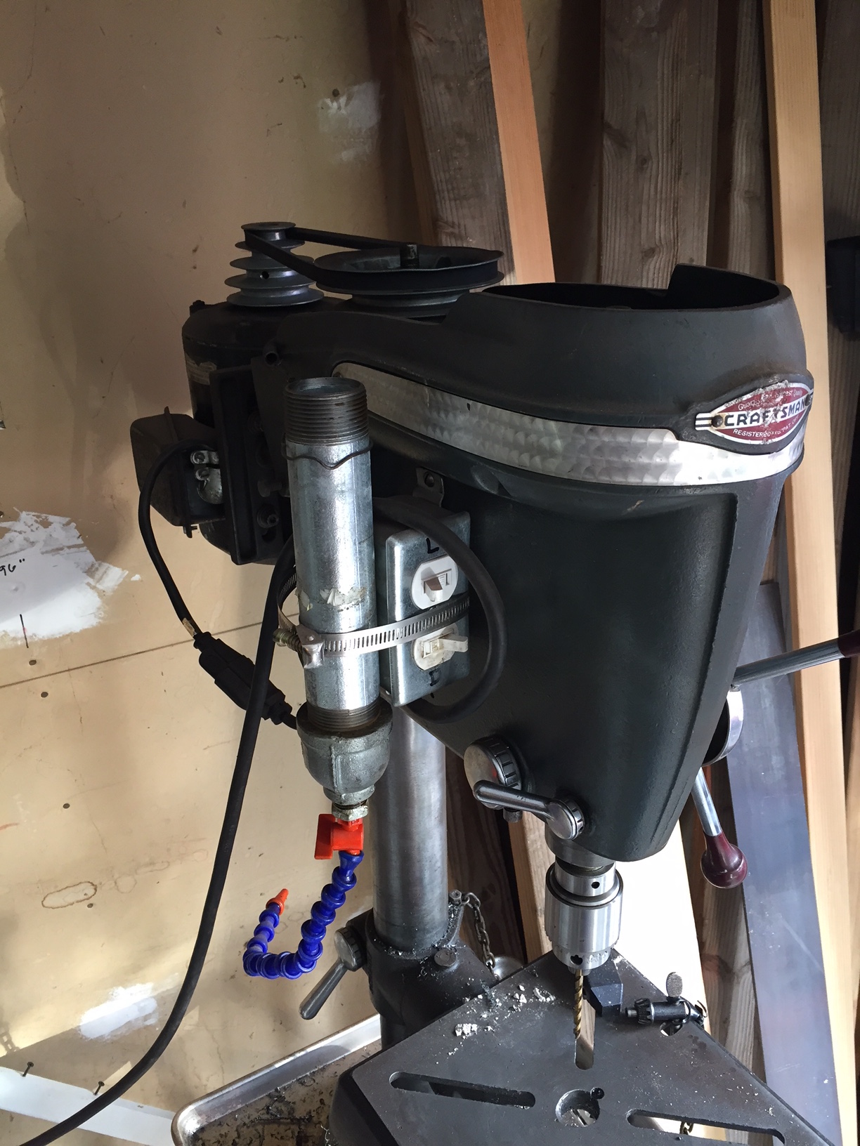

I have two drill presses one is a grizzly bench model (15" 1/2 hp ?) that is semi permanently set up for morticing work. My go to is an old 1950s era craftsman floor model that I inherited from my FIL, it is much quieter than the grizzly which rattles a lot. I also like the old rod style depth gauge on the craftsman, the grizzly has a locking collar on the hub of the press handles that tends to slip ( I really hate stops, fences, etc. that slip - guaranteed to ruin your day)
The craftsman was built back in the era when they built high quality stuff. It is equipped with a half inch chuck, I doubt you could drill much over that through heavy steel. You could make lager holes with a hole saw or fly cutter occasionally. For heavier work a mill/drill would be better.

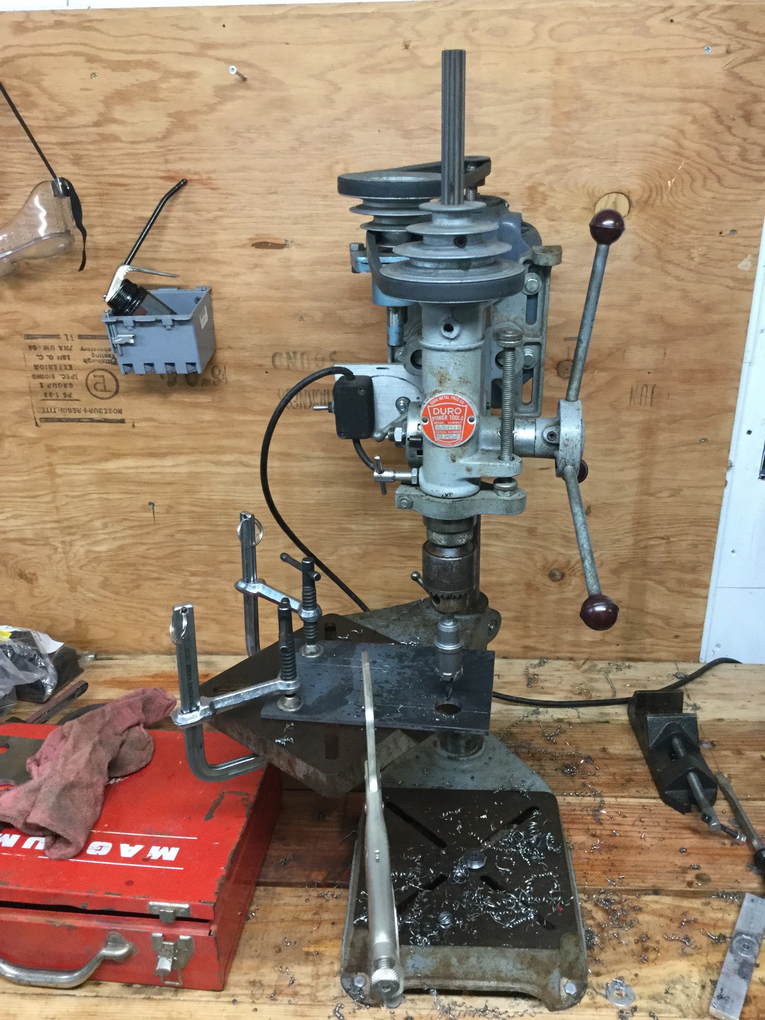

I've got two old presses, a Craftsman (1/2hp) and a Duro (1/3hp). Both 60-70 years old. Both bench top models. They both have multi-speed intermediate pulleys to achieve a wide range of speeds. The slowest speed on each is under 200 rpm. Using hole cutters the Craftsman will do 1.5" holes in thick steel (3/4 - 1"). The Duro will do 1" holes. (See Duro picture.) Got them off Craigslist for not much money.
