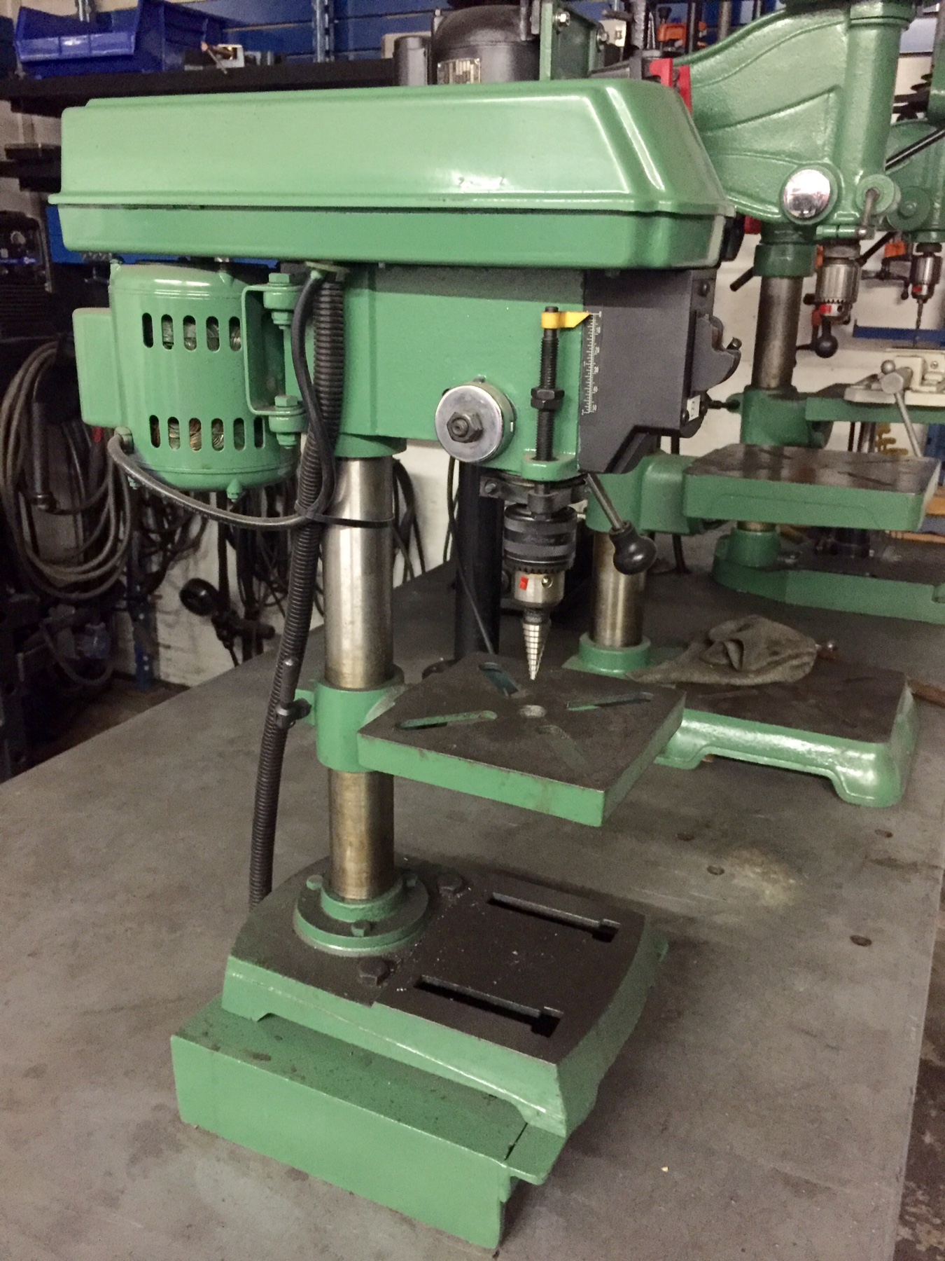

This is what I have done and I am by no means suggesting it is the best way. Just saying that it works for me.
I TRY to purchase older quality bench top DP's and refurbish them if necessary (most often the case.). I'm pretty certain I have UNDER $200 invested in the drills in the first picture.

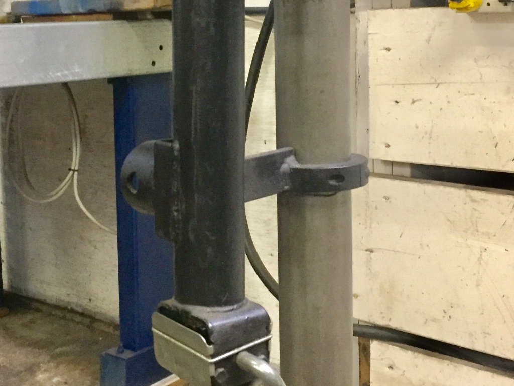

My drill press table crank is stripped out. I'll be stealing your idea on the trailer tongue jack idea.
   / Wanted: First and Last drill press I'll ever own #25

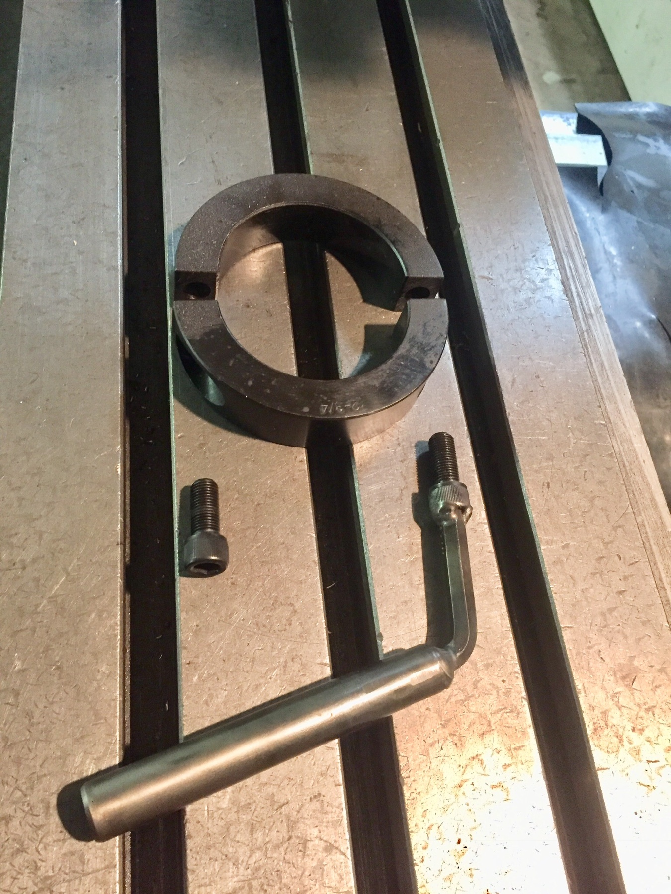

Hopefully this will save you a little time:
I couldn't (or was too lazy to) remove the table assembly or headstock from my press. I had my bearing supplier special order (yours may NOT need to) SPLIT locking collars to match my column's diameter.
I welded a handle to one setscrew.
The collar can then be used for fabricating your mounting bracket.

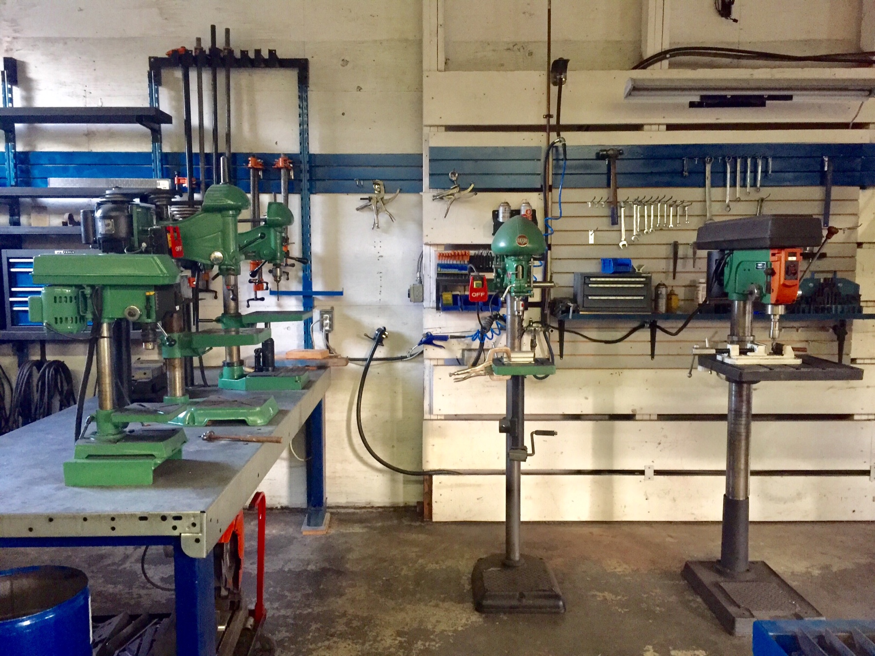

IF you go that route, at the very least get a small, cheap big box store drill press. I got this one used for $20 and keep it set up with a step drill.
I use it whenever possible for holes up to 1/2" in material UNDER 3/16. It's just the way I LIKE it... Quick & Dirty! (oops I didn't say that out loud did I?...)
