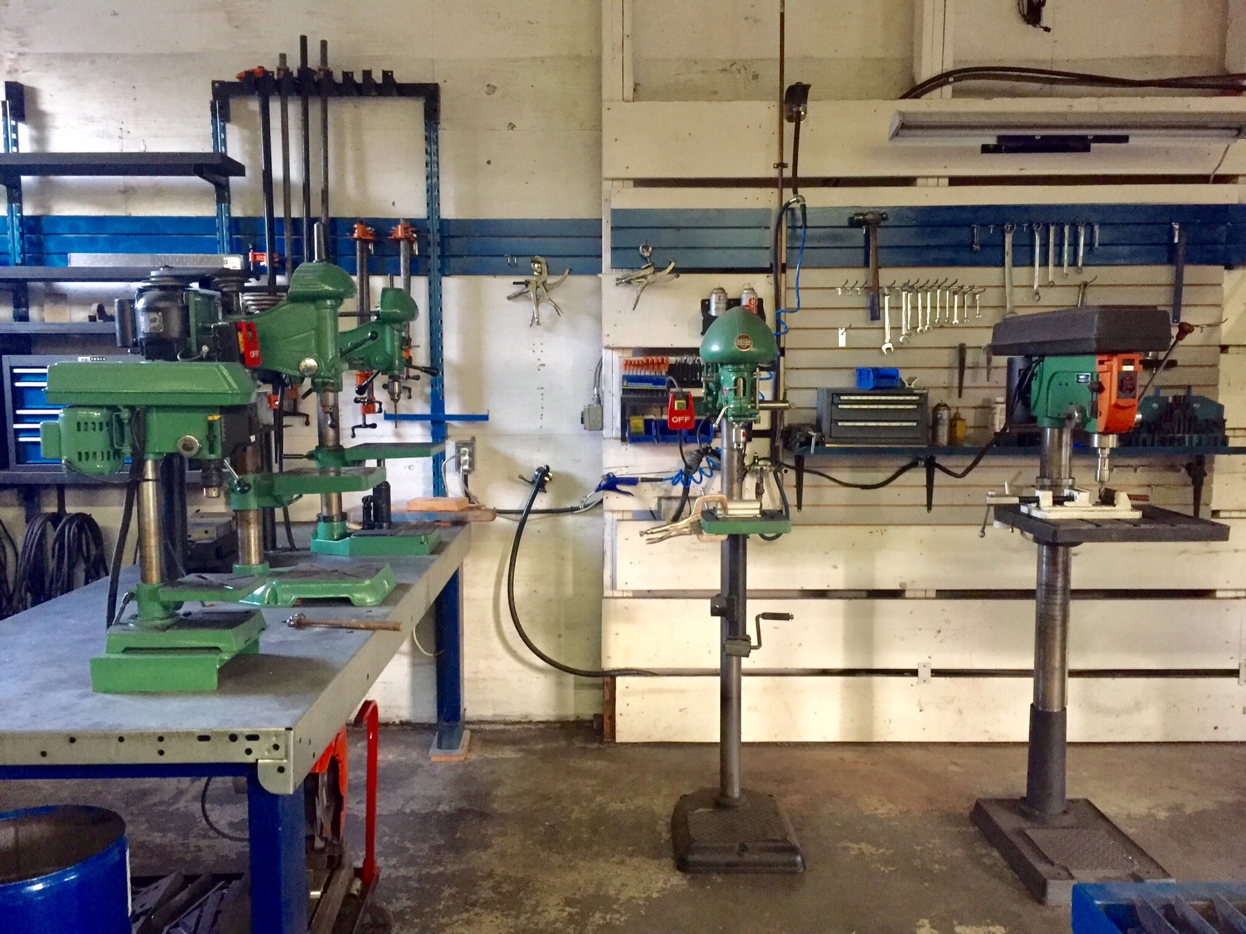

This is what I have done and I am by no means suggesting it is the best way. Just saying that it works for me.
I TRY to purchase older quality bench top DP's and refurbish them if necessary (most often the case.). I'm pretty certain I have UNDER $200 invested in the drills in the first picture.
For REAL heavy drilling a mill drill or mill (as others have mentioned) works well though.

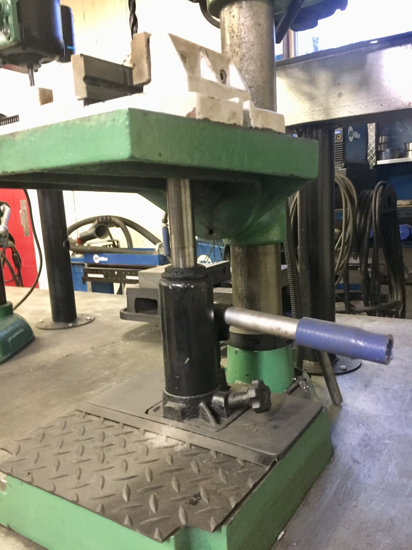

The vintage Delta in the C-list ad doesn't appear to have a crank mechanism for vertical adjustment. For older models without, this is what I did for mine. Makes it a little easier when you have a vise and workpiece clamped to the table.
Small hydraulic bottle jack for bench top models.
Screw type trailer tongue jack for floor models.
