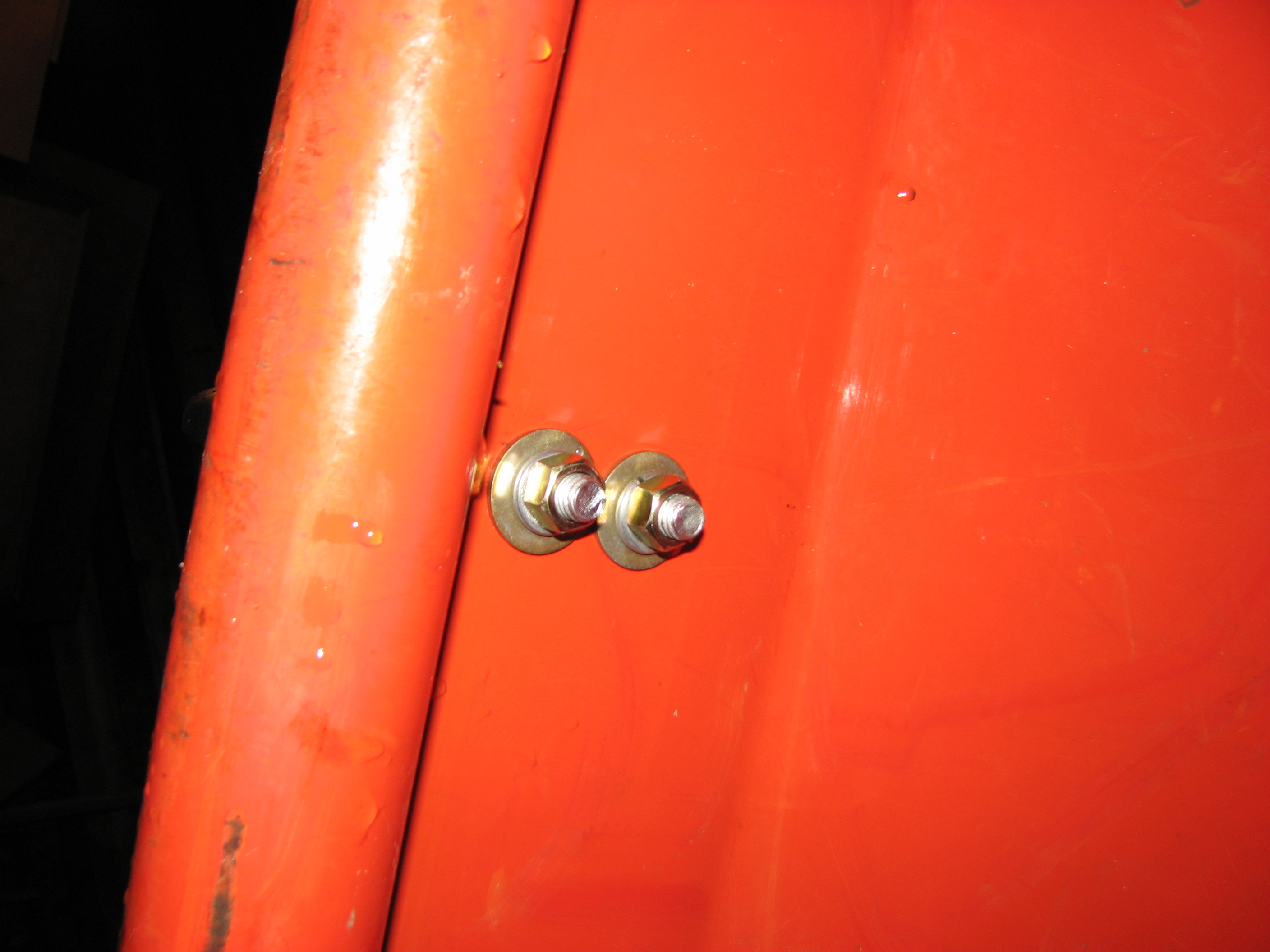

Jim,
I hope you have backing plates inside the bucket under those hooks. I bolted those type hooks on my first tractor bucket with no reinforcement. I think I must have side loaded them somehow, maybe with a "Y" arrangement connecting one lift point to both hooks. It bent the sheet metal slightly where the bolts go thru. And my bucket wasn't a pretty as yours.
John
John - good advice. In my application (LA724 HD bucket) the holes are drilled through thick material - I'd say about 1/8" and right next to the tube that reinforces the edge. Also, I used large, thick washers under the nut on the opposite side to spread the load, so I'm not worried about deforming the bucket in my case.
... Also, under no circumstances would I ever even consider welding on a bucket attached to any tractor made after the mid 60's. Probably things would go okay, maybe not. If you're willing to risk what could easily be a couple thousand bucks just to make sure no current flows into the tractor electronics, you're a far bigger gambler than I. Your advice on dropping the bucket or taking the loader completely off if need be is spot on. I'll even go so far to say that not doing so is simply foolish.
Dargo - Good point! I have suspected that welding onto anything directly attached to the tractor is probably a bad idea. Now I know it's something to avoid. Besides, I need to try dropping the FEL so I can do it quickly when I need to in the future.
-Jim

Here's my entry in the bucket hook contest... My dealer didn't bat an eye when he saw these, except to say "nice hooks". The inner three are used for lifting depending on the physical configuration of the load, the outer two are strictly there for keeping bulky things from falling out of the bucket while carrying them around, and are never used for lifting (or pulling on) anything.
****, how do you keep the inside of that bucket so clean?
I only have 117 hours on mine and the paint is almost all worn off on the leading edge, I guess I do use my bucket a lot
