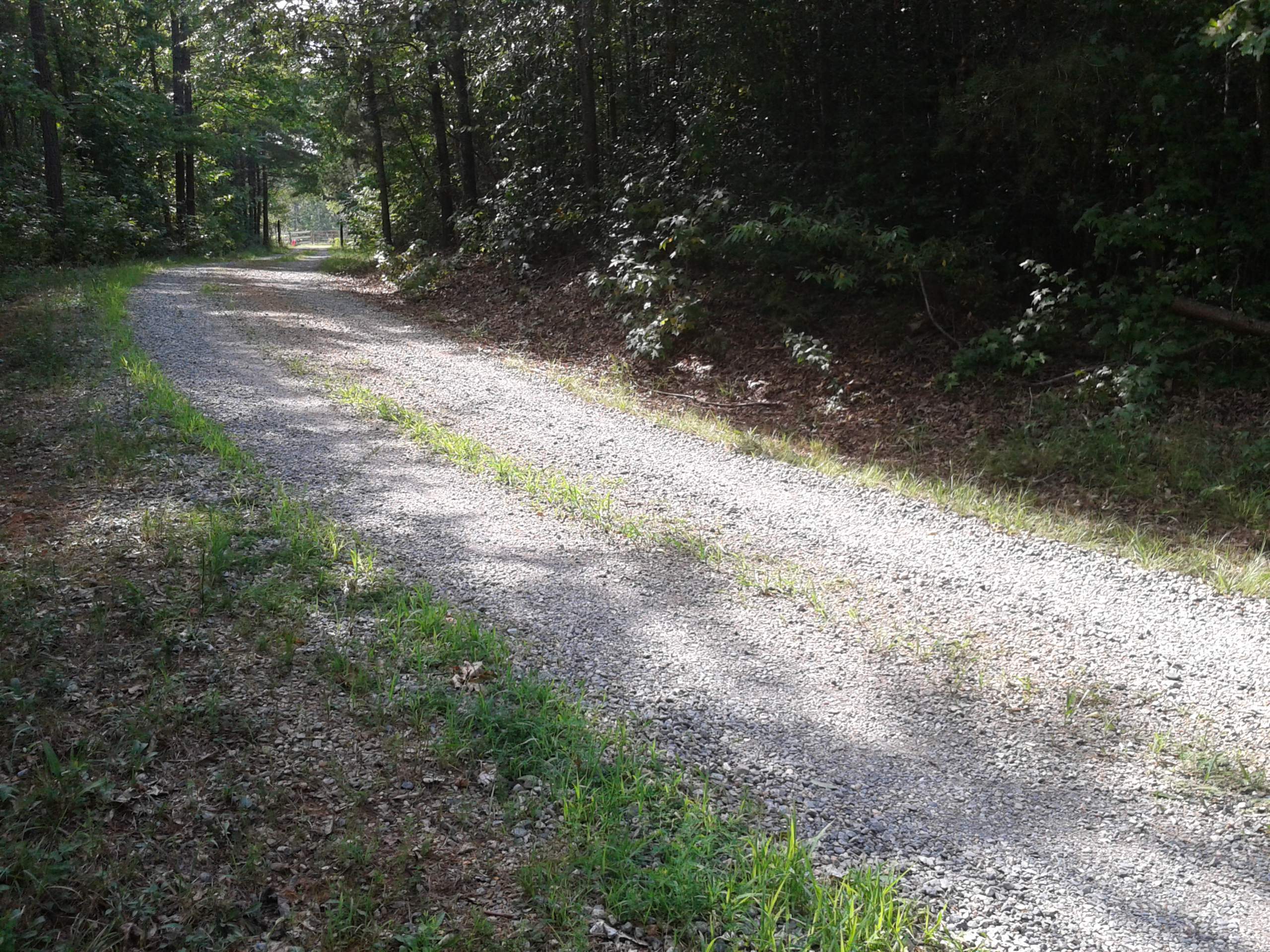

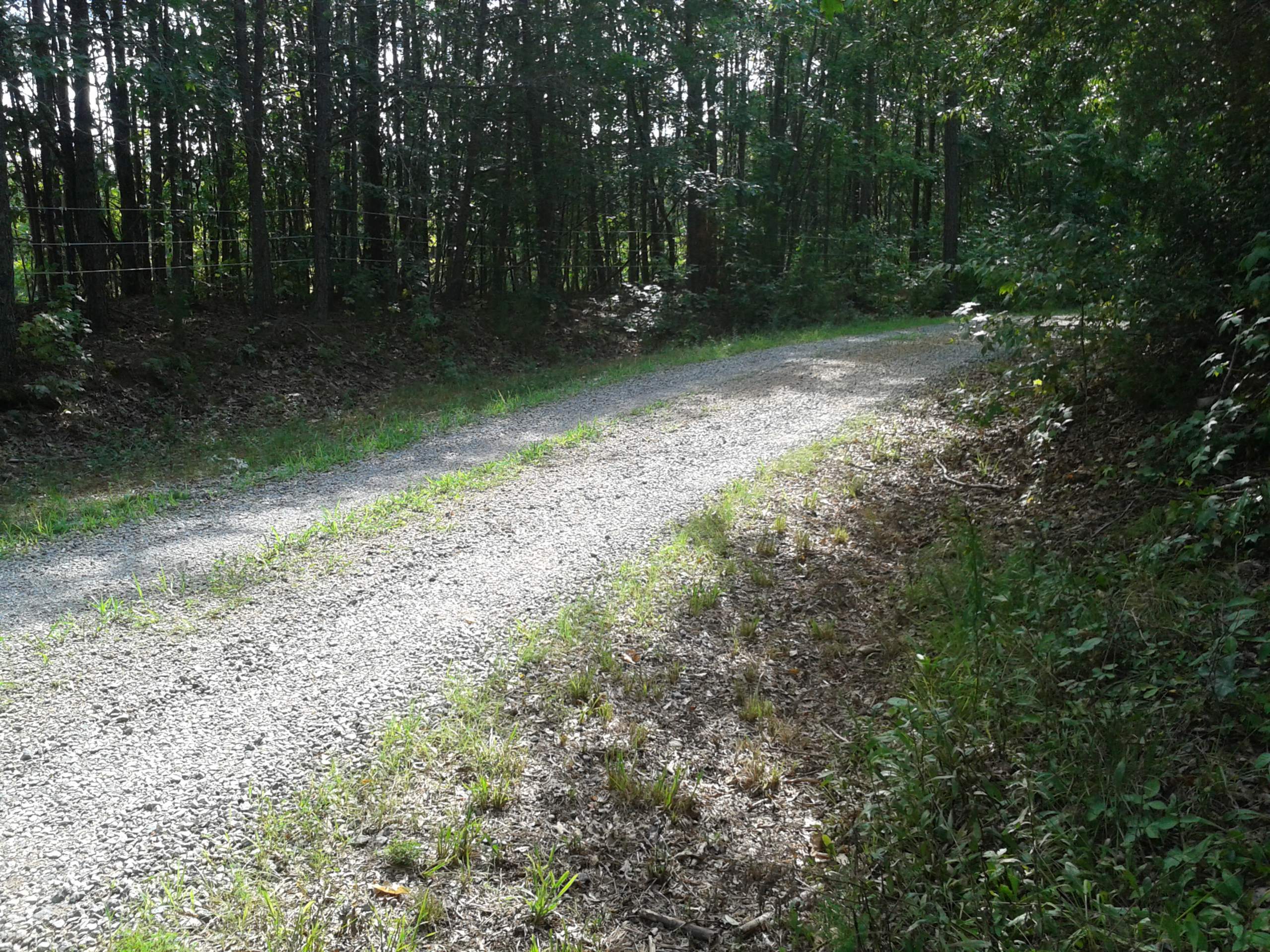

I took two pictures, one from each side of the road. I cannot SEE the washboarding today (must be due to the rain last night?) but it was still bumpy as I drove over it.
The easment is very narrow, there is not room to get the tractor sideways or at a 45 degree angle as someone was mentioning (not much at least).
In the distance you can see my gate, and the horse fence gate beyond that...
Be well,
David

Looking at the photos, you should be able to roll at an angle (even if not 45 degrees). For example from your gate, work towards the bend - start on the far left side of the track and aim to finish on the far right by the time you are half way to the bend, and repeat along the whole track at this angle. It may seem very time consuming - but will be worth while, especially if you are going to the expense of relaying the track.
There are lots of cheaper / quicker solutions to provide a temporary "quick-fix" including the dragbox, however if you want to solve the problem, the only way is to dig up and re-lay the track.

Technically it is not my property, and I am happy to maintain it, but redoing the track might be over my head and outside ofmy budget also... But I want to understand it and your explanations make sense.
I appreciate it sir.

La Romana is in Alicante province - we're in the mountains about 40 minutes inland from the town of Alicante. It is a dry beauty around here - lots of vines, almonds and olives, but not mush else that's green for much of the year! I do love it here, but miss the green rolling fields of the UK - I would really love to visit the USA sometime, as from what I have seen on posters photo's here at tbn, much of your countryside seems idylic :thumbsup:
I can totally appreciate that you don't want to spend money on a right of way across someone elses land - as a thought (it might not work) you could try the box grader (ideally with ripper tines) along it, and try to put a bit of shape back into the track - from the photo's it looks like there is little or no camber to help shed the rain? You can get the grader to build up the centre of the track to form a camber by adjusting one link arm slightly higher than the other. If there is no budget for a roller, then maybe use your tractor to compact the surface when you're finished - it won't do as good a job, but may well meet your needs for light traffic :)
