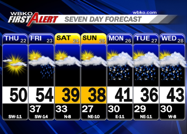

looking nice . Must be nice to have good weather to pursue projects like that.
