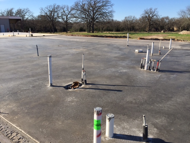

Pictures would be really helpful.
Why was the original plumber fired?

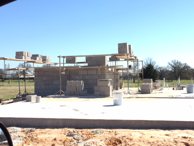

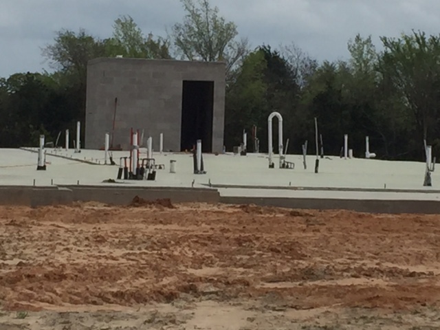

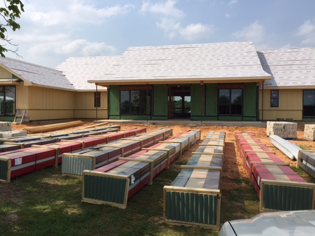

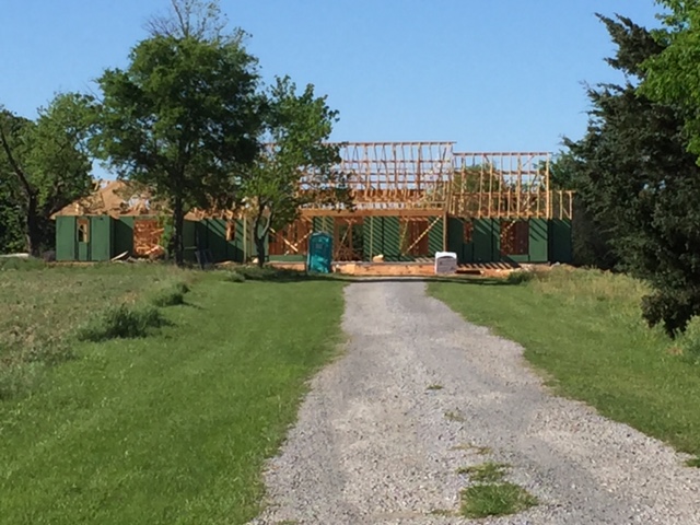

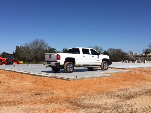

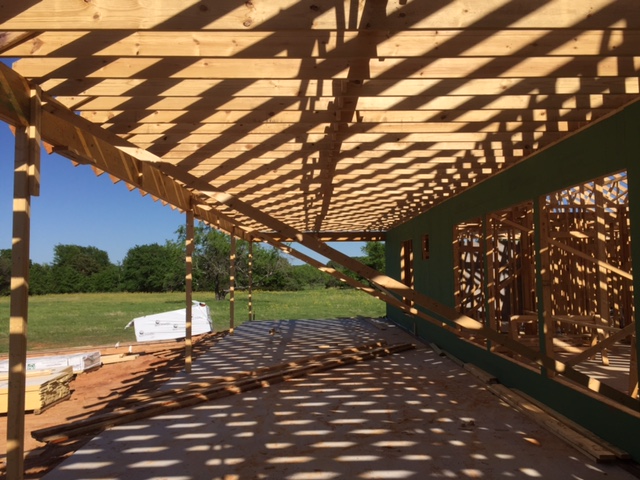

Thanks for all the posts guys. No inspections but the new plumber is going with the 3" and is now comfortable with it. I don't know the size of the vents, hoping the original plumber managed that ok. The first plumber has some difficulty getting the pipes in the walls so the builder is having to shim the walls since pipes stick out a tad. Honestly, I'm amazed he got it that close. Foundation is crazy full of steel. So the builder said the concrete guys liked the first plumber because he hand dug beams. The plumber we have now, supposedly better, used a trencher and messed up the concrete guys beams. Who knows. A couple pics of progress and my safe room.
