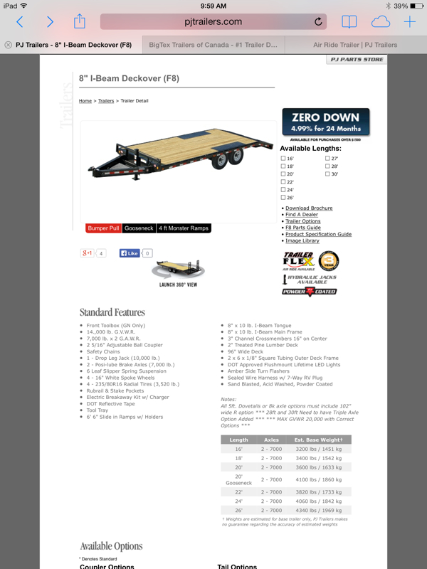

It has been a long time since we discussed on this thread. I have been getting water delivered by the tandem truck load and it was working out great, until last week. On December 24th our low level alarm came in, which gives us about 4 days. All the water hauling companies were off for Christmas until January 2nd. So we ended up going t the local farm supply store and buying a 500 Imp gallon tank. I borrowed a 7000# car hauler trailer from my cousin.
I am going to pull a couple more loads with my cousins trailer, and if I still enjoy hauling my own water I will go out and by my own trailer.
The trailer I am looking at is the PJ F8 deck over. 7000# axles. I am looking at either the 16' or 18' length. I will probable get a dove tail and flip over ramps if possible. This will allow me to haul my tractor on it with ease also. I chose this trailer because with 500 gallons of water it will be right at the tow rating of my truck. When I upgrade to a 3/4 or 1 ton diesel in 2 years I will be able to safely add a second 500 imp gallon tank onto the trailer!
Anybody have experience with pj trailers and reviews? Also should I get the 2 5/16" ball coupler or the pintle hitch? I like the pintle idea because it is harder for people to borrow!
