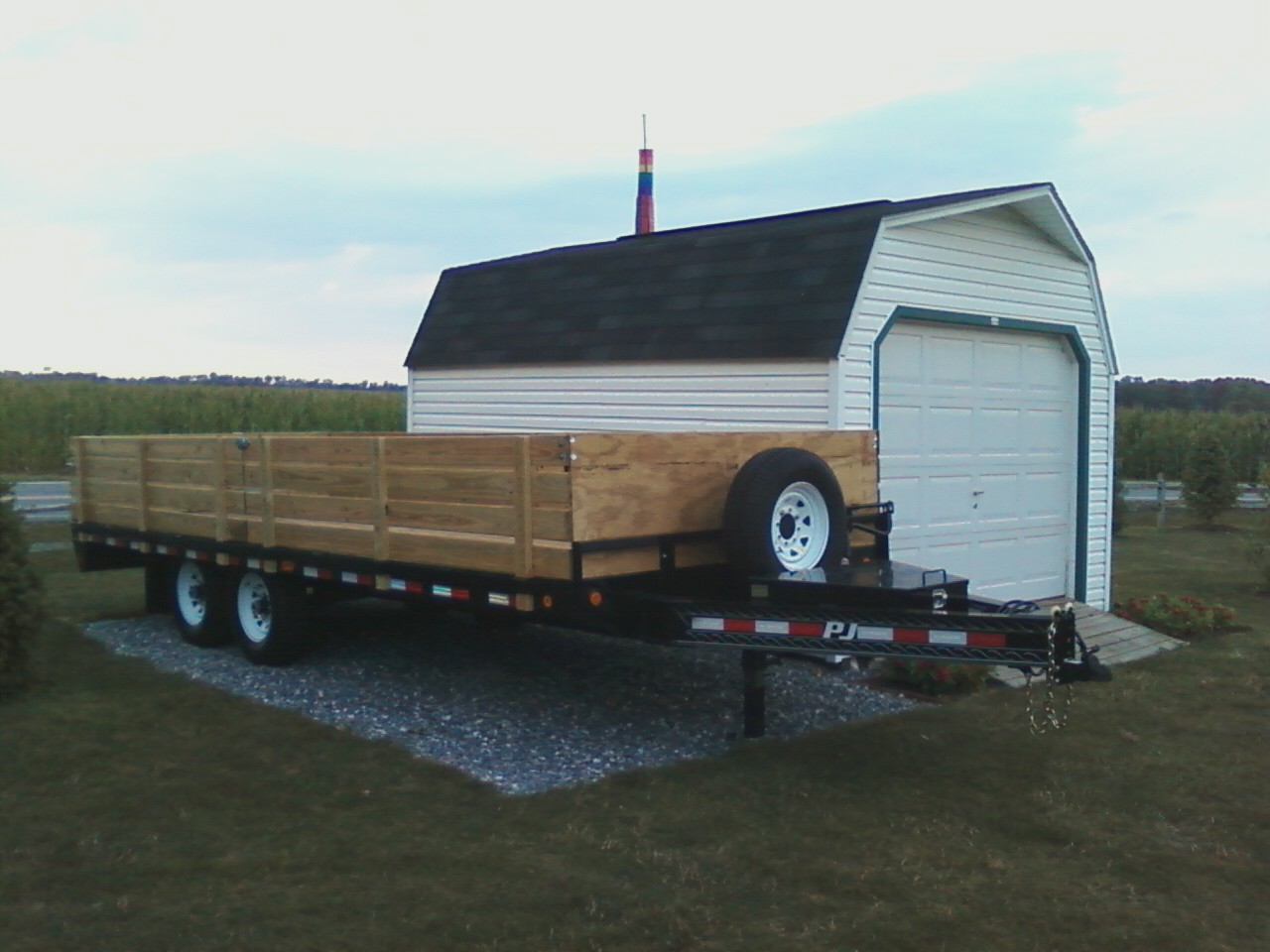

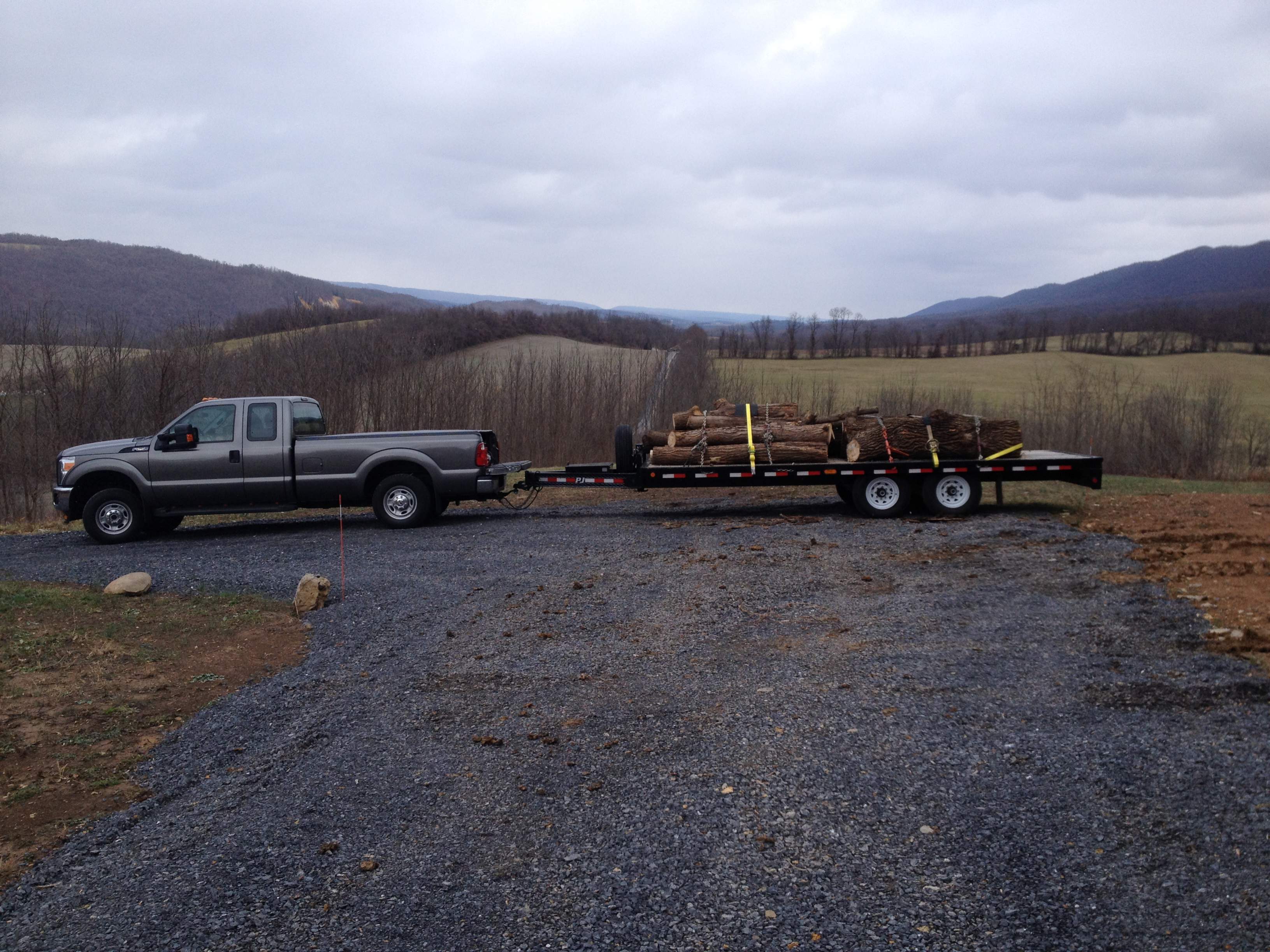

X2 on the pintle hitch. The trailer will tow much better with the ball setup. I have a PJ F8 and love it. I would recommend getting atleast a 20'er though because you need more length at times to balance the weight out. Mine is 20' and I wish it was 24'. If I could do it all over Id get a 24'er with monster ramps to make loading easier but still have a flat deck.

That is a pretty looking trailer.

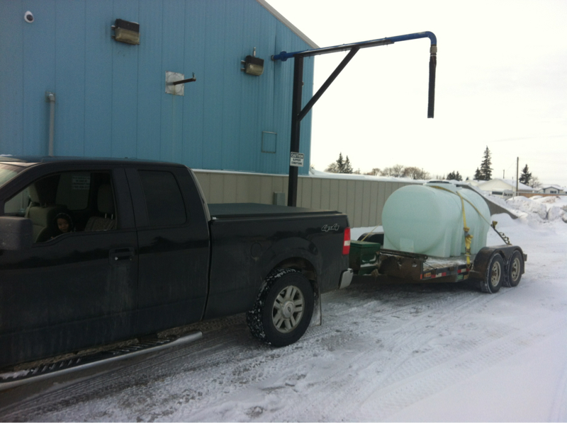

The trailer I am looking at buying has a 14,000 lb rating. One imperial gallon of water weighs exactly ten pounds. Yesterday I had the 500 gallon tank on a 7000 lb car hauler trailer. I pulled it over my dads truck scales and the trailer axle pair had 7062 lbs on them.

Hi all. I am thinking about hauling my own water to my home instead of paying for deliver and was looking for input onto my different options.
Just curious...Will you have any issues with the water sloshing around in the tank? I know tanker trucks have baffles in them to reduce this effect otherwise the tow vehicle can get pushed around by the liquid moving.
If filled to the top it doesn't slosh bad at all. It actually pulled way smoother than I expected.
