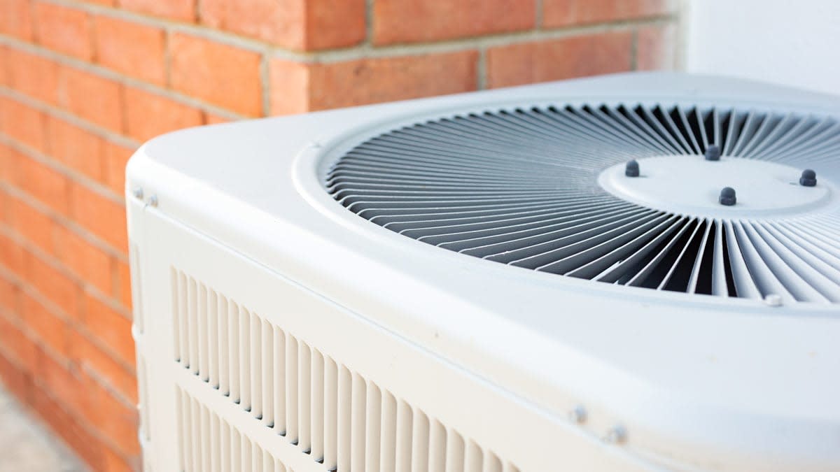

Often, water heaters and HVAC systems are replaced with similar units instead of having to change plumbing, wiring and vents.
