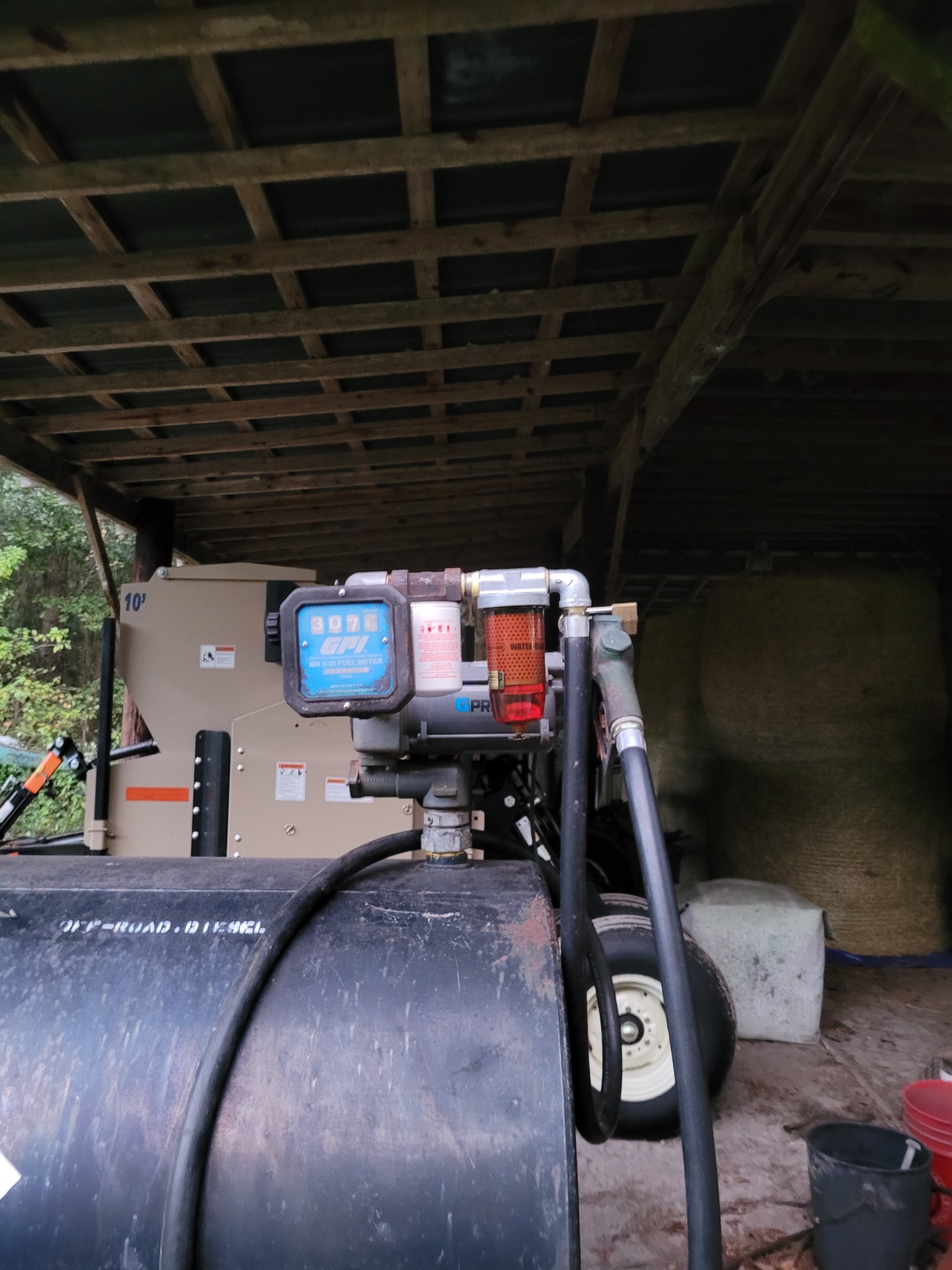

This is my setup on my 500 gallon tank a particulate filter and a water block filter and I treat my fuel for algae, call me paranoid but knock on wood I haven't had any problems.

I have little faith in the 'water block filters actually. Bulk tank maintenance is paramount as is draining off the crud that collects in the bottom and moving the pump pickup tube off the bottom to allow for a 'sump space' for the crud to collect and draining it off regularly which I do, monthly. I add an EPA certified biocide, not some elixir to my bulk tank for algae growth. In my case, I use Power Service Bio-Kleen and it ain't cheap by a long shot but a little goes a long way and my fuel polishing units strip any algae out anyway along with entrained water and anything else in the fuel supply. Nice thing is, I can just look at the collection bowl and see at a glance what they are collecting and when the fuel supply filter gets loaded, I just spin on a new one. probably should install a set of pressure gages on the units to observe any pressure drop but I never did and so far, it works just fine. I just change the filters every spring when I service the tractors.
I believe RJ has gages on his, not sure but I believe he does.
   / Water in fuel causes $10,000 damage to my Kubota Grand L6060 #119
Just on the tractor installed Racor. The transfer tank has the first filter being a sediment bowl type, so I can see both the filter and what has settled out.
