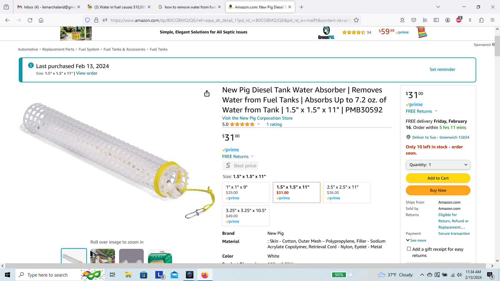

All the additives in the world can't do everything, also any additive that absorbs the water to carry it through the system is going to be alcohol based. So you are running water and alcohol through your injection pump.
I prefer to leave one of these in the bulk tanks.

I've never heard or seen this. How often do you replace it?

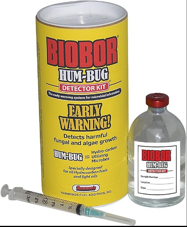

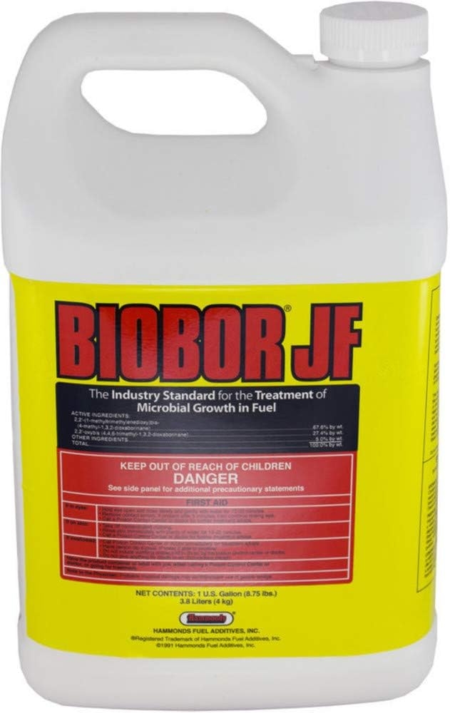

I see no mention of a biocide. i would skip the diesel tank cleaner and use biocide instead especially if you have had problems with water in the fuel in the past. keep extra filters on hand after treatment because you will go through them. I use BIOBOR JF it is the only treatment approved by the FAA and not too expensive. I put 1.75 ML in a 5 gallon can. One teaspoon is 5ML so my bottle will probably last 20 years.
If you have a pump on your tank you can put the nozzle back into the tank and run it to "polish" the fuel and stir in the biocide. Can you drain the bottom of your tank.

I couldn't find power service BIO KLEEN locally so I went with biobor from amazon.
These are the products I have used, and are used on ships with thousand barrel fuel tanks.

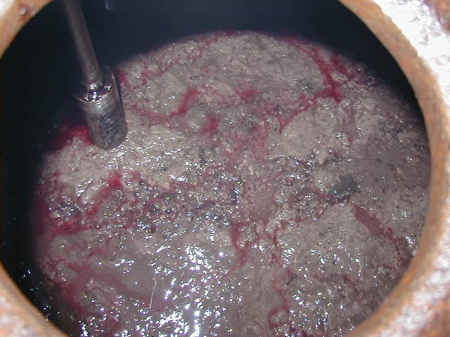

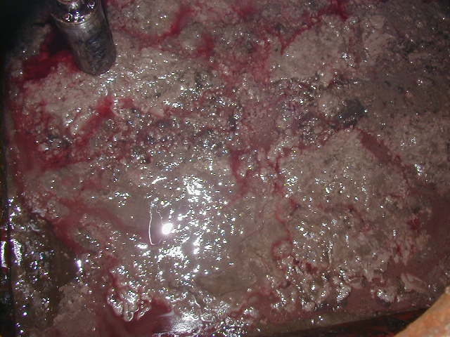

On the ship the fuel is also centrifuged. Here is dead bugs the centrifuge caught.
