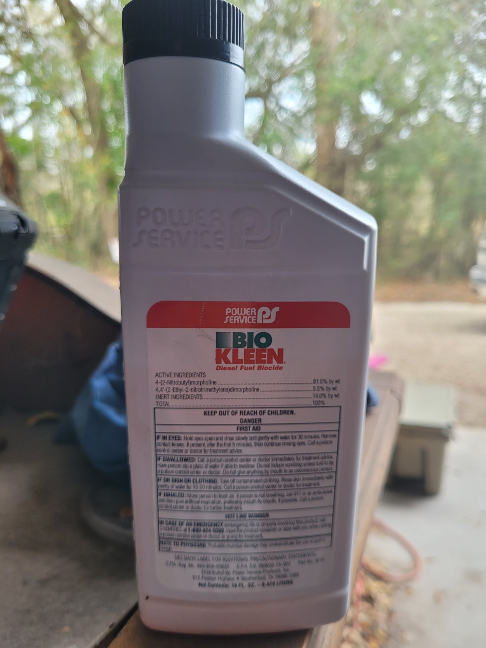

I have little faith in the 'water block filters actually. Bulk tank maintenance is paramount as is draining off the crud that collects in the bottom and moving the pump pickup tube off the bottom to allow for a 'sump space' for the crud to collect and draining it off regularly which I do, monthly. I add an EPA certified biocide, not some elixir to my bulk tank for algae growth. In my case, I use Power Service Bio-Kleen and it ain't cheap by a long shot but a little goes a long way and my fuel polishing units strip any algae out anyway along with entrained water and anything else in the fuel supply. Nice thing is, I can just look at the collection bowl and see at a glance what they are collecting and when the fuel supply filter gets loaded, I just spin on a new one. probably should install a set of pressure gages on the units to observe any pressure drop but I never did and so far, it works just fine. I just change the filters every spring when I service the tractors.
I believe RJ has gages on his, not sure but I believe he does.
That's the same stuff I use in my bulk tank but it must be way more expensive up your way as I never thought around $30 per bottle was all that bad to shock treat up to 320 gallons.
   / Water in fuel causes $10,000 damage to my Kubota Grand L6060 #122
About 5 bucks more around here. Stuff stinks as well but it works as advertised and like I've said in the past, any elixirs that don't have the required MSDS label attached to them, whatever claims they make, they are fibbing.
The issue is, it kills any algae but the exoskeletons remain and have to be filtered out of the fuel anyway. My fuel polishing units do that just fine.
With algae, dead is dead but the remains need to be removed anyway.
