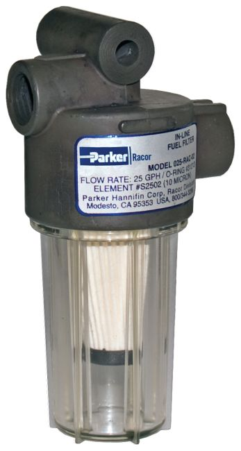

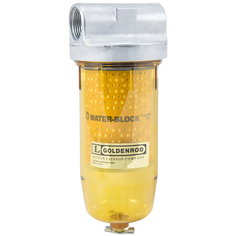

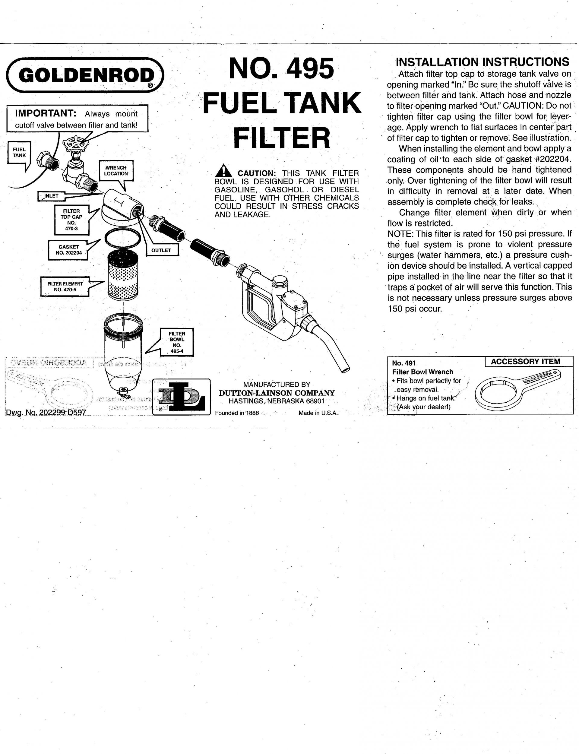

My tractors and mowers all have old school mechanical fuel injection and all my fuel is pumped through this 10 micron filter and water separation bowl.
Goldenrod Filter_Page_1.jpg Goldenrod Filter_Page_2.jpg Goldenrod Filter_Page_3.jpg Goldenrod Filter_Page_4.jpg
I sure hope all these new modern common rail injection systems have better than 10 micron filters in the tractor.
