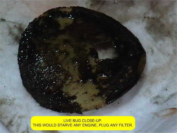

A metallurgical analysis of the material in the OPs pic of the rail could determine what it actually is (rust, debris, and/or bugs) vs what it looks like.

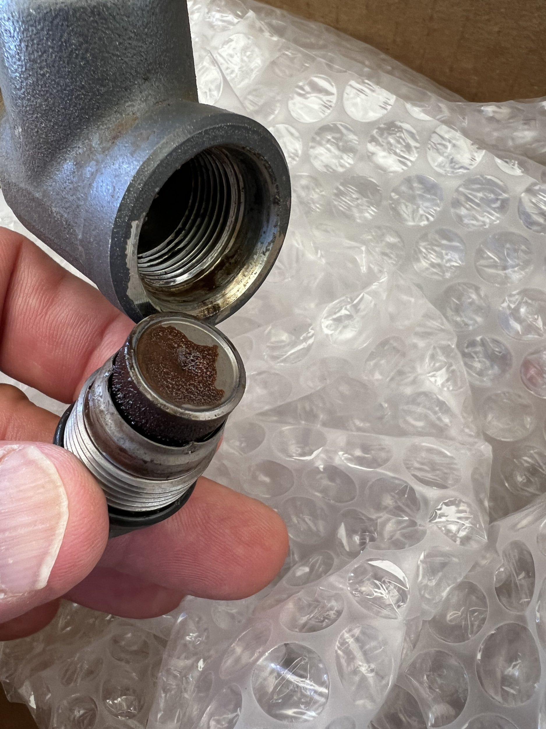

Like the title says, water in fuel caused me a $10,000 repair bill to my 2017 Grand L6060 with about 1200 hours on it. The water caused rust in the fuel rail which caused damage to the injectors. I have had fuel problems with this tractor since its new.
I have a 100 gal. nurse tank that I use to fuel my tractors. I assume that condensation is happening in this tank. I do add a fuel 'cleaner' to each 100 gallons I put in the nurse tank. I guess this is mostly my fault, because I don't monitor the water separator on the tractor closely enough. I will check it more often now after this.
High temperature and humidity will cause condensation and the resulting seizing of fuel racks and injectors. Kubota engines are stout. All they ask for is the proper fuel, clean air filter, and proper oil change intervals.
Their tractors lack proper filtration...they must have a aftermarket fuel/water system...AND you have to run those engines on a regular basis to keep the internal fuel system lubricated...diesel fuel will eventually dry and leave the rack and injectors to rust...it only takes a spec of rust to cause seizing.
