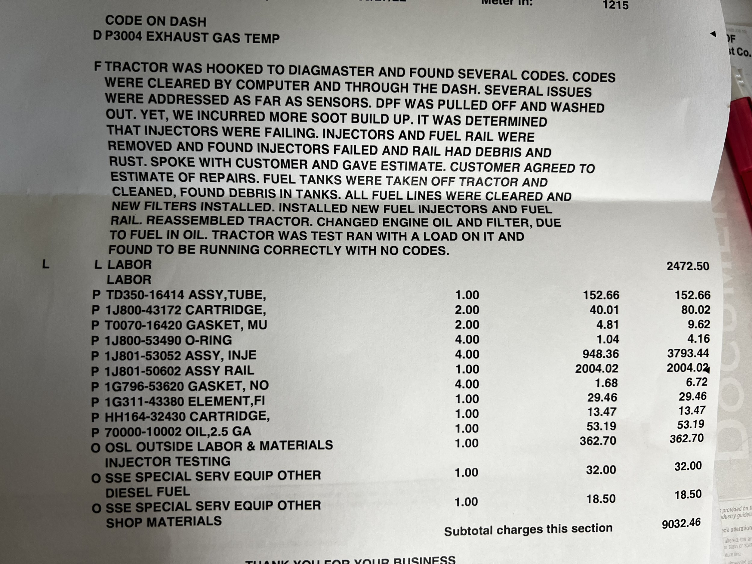

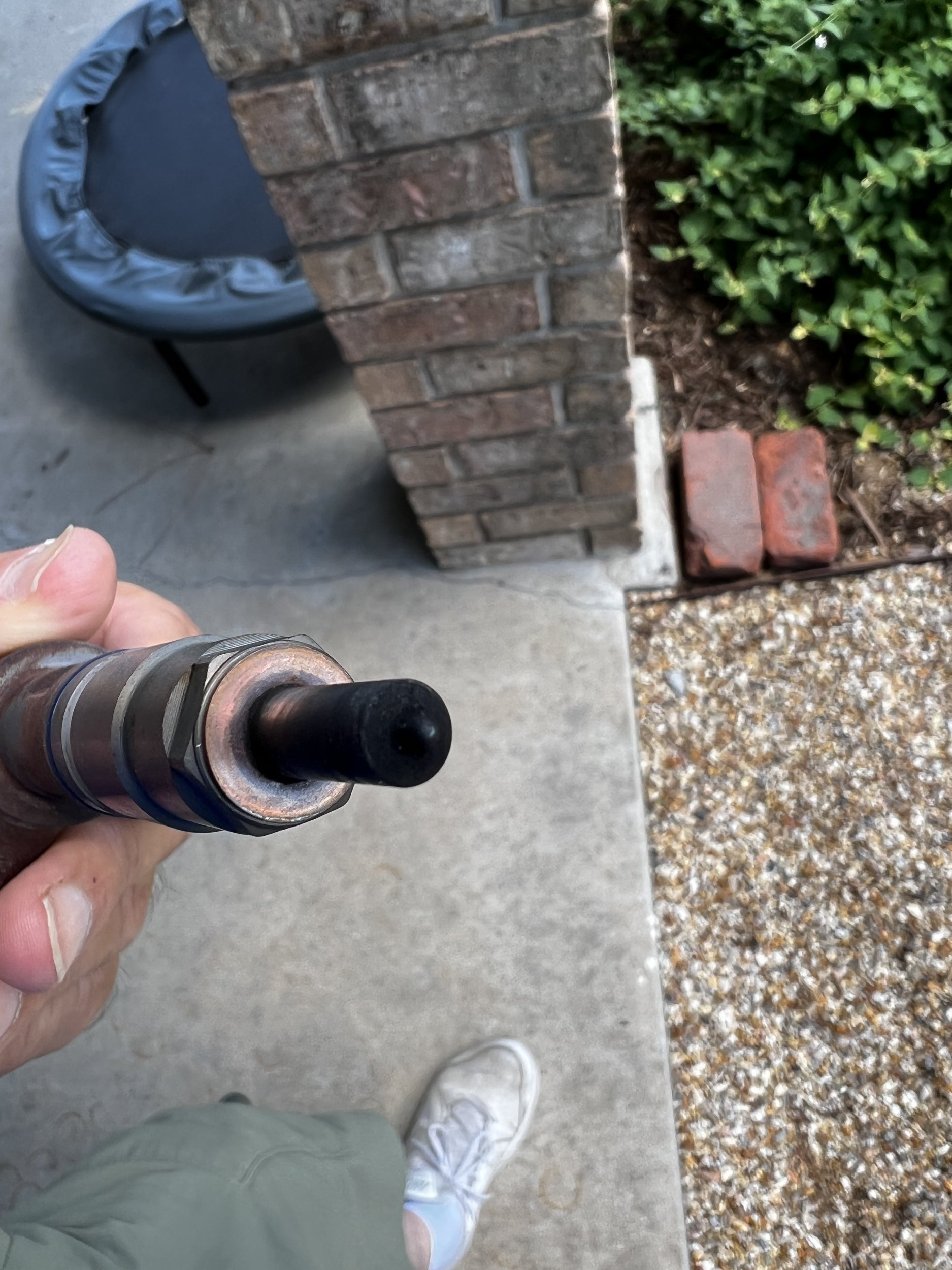

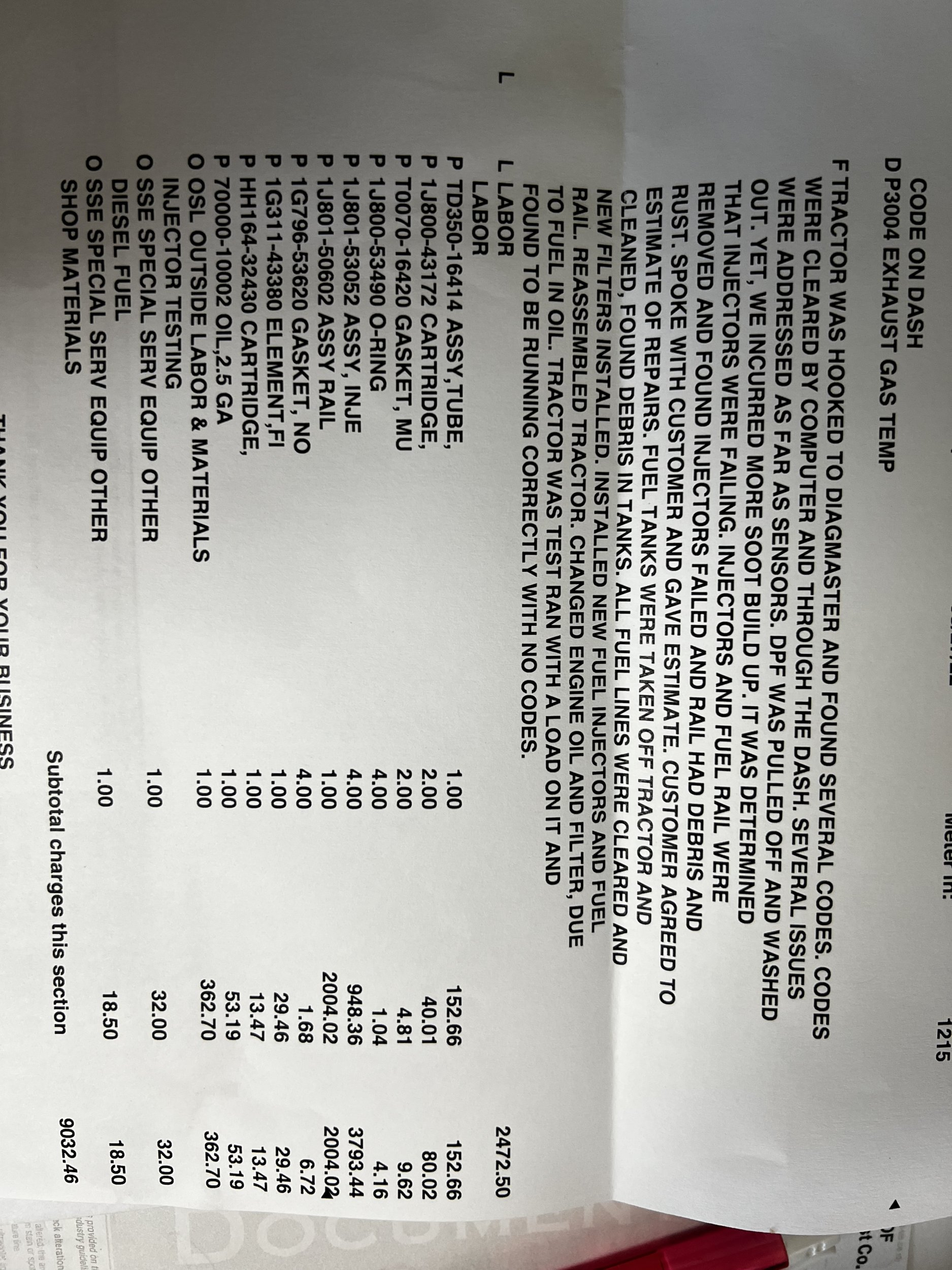

Here is the first page of my invoice. The next pic is of the rail and you can easily see the rust. The last pic is of injector #3.
I have been researching some sort of water sensor that I could install somewhere in the tractor fuel system. It seems that these fancy tractors would have a warning for that already.
   / Water in fuel causes $10,000 damage to my Kubota Grand L6060 #54
That invoice also reveals that you don't perform oil analysis. That much fuel in the engine oil suggests you had early barrel and plunger failures in your injection pump that was likely caused by corrosion from bacteria and fungi, aka "Diesel Bugs". Really surprised the dealer wasn't more specific about the "debris" found in the fuel tank. Could be pure ignorance on their part. I recommend you treat your fuel with a biocide for at least three tankfuls, and treat and monitor your "nurse" tank. I don't think you want to repeat this again.

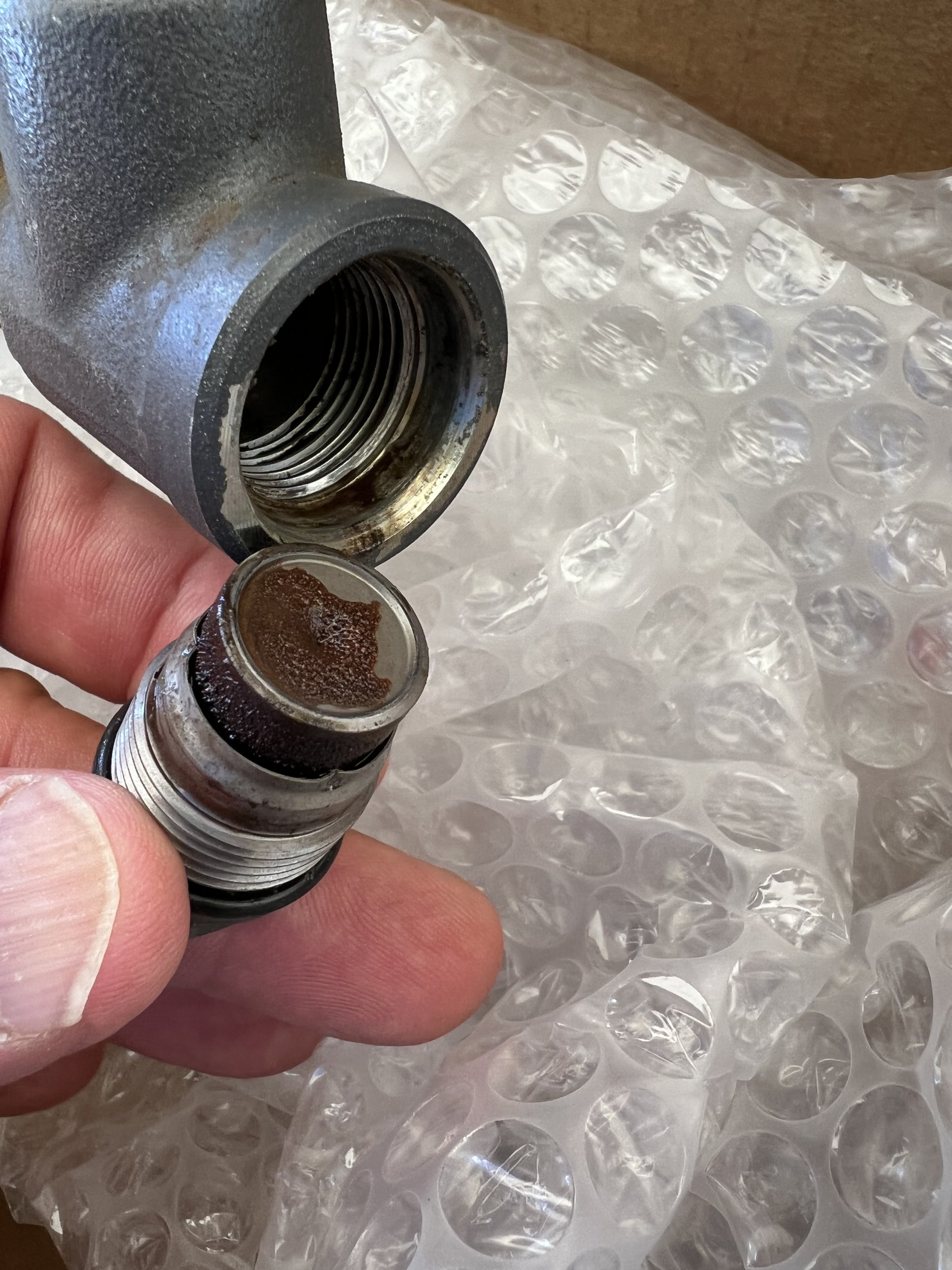

Rust inside storage tank transferred to tractor fuel system?

Just a guess on my part but the rusty looking plug is a dead end on the fuel rail and maybe a place water settled.
High pressure common rail is itself a form of emissions control. It gives more precise control of the injection events. I know in some cases they can have multiple injections for a single power stroke, as many as 5. I don’t know how many Kubota has. In my mind you have the high pressure, more than one injection event, things will wear faster. Throw a tiny bit of water and microscopic grit, then things wear even faster.
I don't believe Post 4 common rail engines have plunger and barrel pumps at all but a biocide as well as regular oil analysis is a good regimen to establish. I use both with my pre 4 tractors and pickup truck as well Oil analysis is cheap and so is a biocide compared to a repair situation. Far as your comment about $175 grand compared to 9 grand, Not a good comparison as the you are comparing commercial to not.
