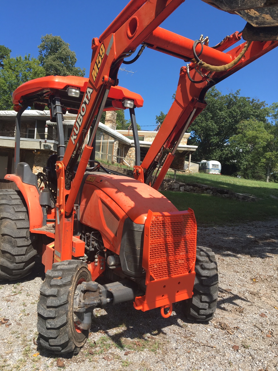

Need to look. Maybe 650 or so. Bought it new in 2004. Several years after that (after adding a grapple), had some hood/front damage. Even broke the air cleaner housing, and broke the radiator free from the top mounts. Also jammed a stick into the fan, bending the shroud, affecting the brackets that hold the screen, and damaging the fan blade tips. In retrospect, we should have removed all these pieces and either straightened them better or replaced them. But instead we straightened it as good as possible and thought all was ok. I believe now that we twisted or torqued the radiator, because after removing it, I can see it’s twisted out of plane. So the damage surely weakened it and it eventually failed. At least, that’s my theory. We now have a better homemade grill guard, but even now, there are some spots that need better protection. Frankly I think Kubotas (maybe all tractors) need better shielding and skid plates. But of course, with a grapple, it’s easy to think you are driving a bull dozer. We certainly abuse the tractor in the woods, clear cuts and areas of privet.
So my advice is to not do the stuff we use ours for. Buy a bulldozer instead.
/ Water pump replacement. #9
Been there, done that, built a guard.
