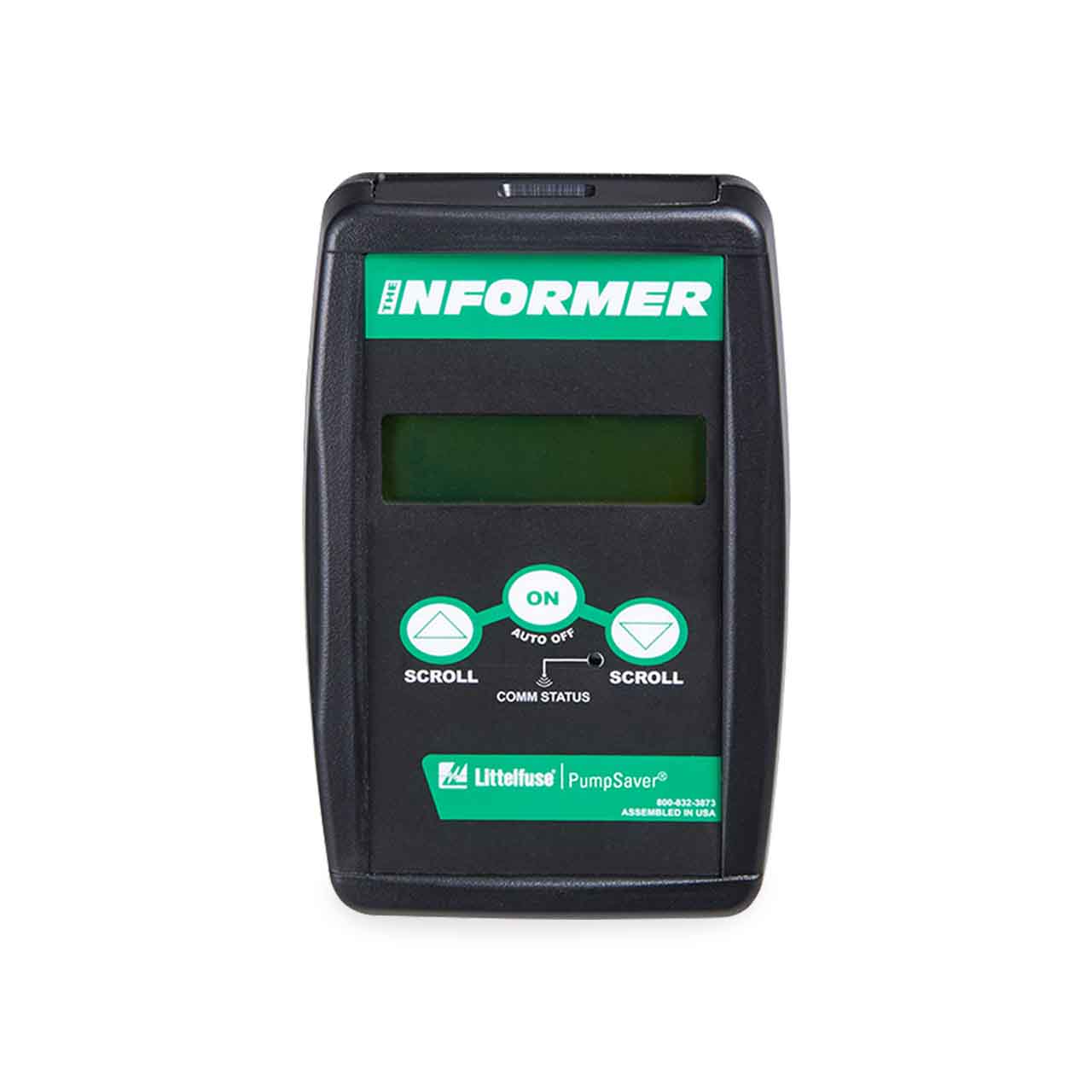

We have a pumpsaver on the well which shuts it off when the pump overspeeds or has other errors (which are generally caused by low water). It records the events. I use a small device sold by the same company to read out it's memory and find out when it's had soft and hard errors so I can tell when the level is getting low, before it shuts off. It's an electric device which you can add at the well head.
This is the one we have: SymCom PumpSaver 231 INSIDER-P | Pump Protection
The fiber optic cable hanging off it is what you use to read the data, using this:
I checked today and we've had a bunch of dry well events recorded by the pumpsaver. Looks like I'll be cutting way back on watering the lawn and if it still gets the dry well events, stop entirely. I put a lot of work in the last two years getting the lawn back into good shape, so it hurts to let it go.

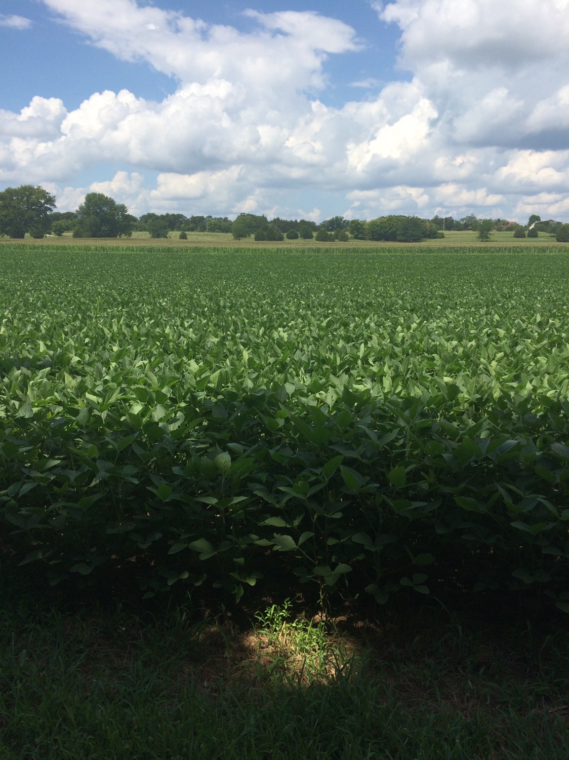

We live close to the confluence of the Mississippi and Missouri rivers.
Flooding is the issue in Spring.
To date, we are about at the normal level of precipitation. The beans are doing very well.
