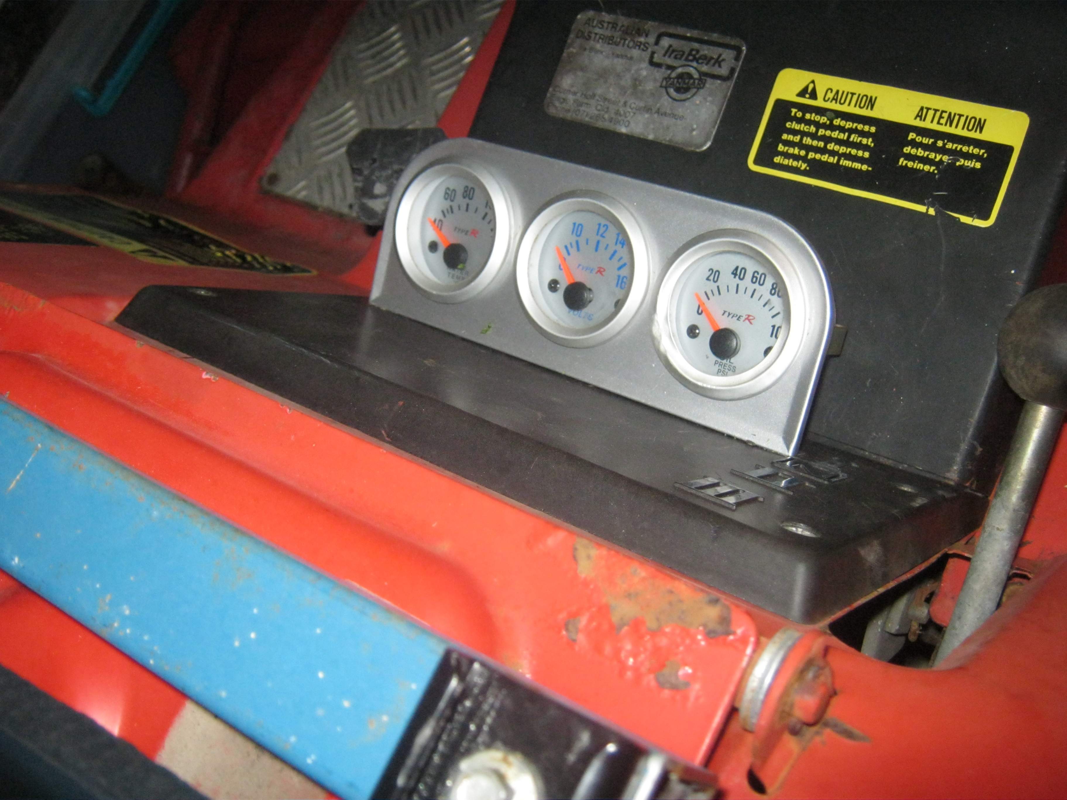

What do I need? Is there a certain type or anything? I don't want to buy the wrong one. Would it make sense to install oil pressure and amp gauge as well?
I'm looking forward to hearing some ideas. The tractor seems to be running just fine, but I am not willing to take any chances on overheating!!

I think its a good idea I did it.
I got a cheap set of gages from O'reilys a 3 gage set I think they are 1 1/2" diameter pretty small and mounted them under the steering wheel on the panel thats there.
The fittings are not the same as the tractors threads are fyi, if you use thread tape and dont go too far in NP thread will work it did for me anyway.
I left my light senders in place and tee'd the gages in fwtw. ymmv

Thanks, good info. I'm looking at an Aussie-made temp gauge/alarm that bolts right onto the head. It's a little pricey, but installation is super simple & easy. No drilling holes for gauges. It eliminates the thread difference problem.

For what it is worth. Temperature sending threads M16 x 1.5. McMaster-Carr Oil sending threads 1/8BPT which is only 1 thread per inch different than 1/8NPT. Some have used the NPT with no problems. McMaster-Carr

Wow that is an expensive gage I spent about $45 US on my gage set and I only drilled 1 hole 1/2" in the shin panel on mine and grommeted it you cant tell it isnt supposed to be there. fwtw
