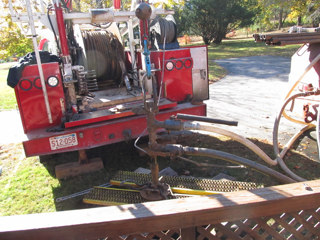

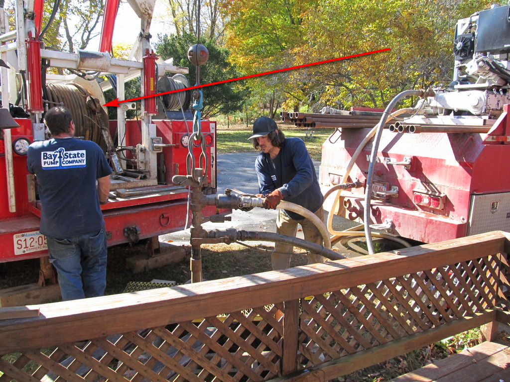

I got 35 years out of a Gould's submersible I installed back in 1986. Replaced it in late 2019 when I had the well hydro-fracked simply on the premise I was on borrowed time with a pump that old and wasn't sure of the condition of the impellers at the age. Fed into a 40 gallon bladder tank and adjusted to about 30-50. Pressure switch has a low pressure cutout which a couple times prevented the pump from sucking air (toilet fill valve got stuck open one time). Well guy that did the recent work attributed the longevity of the pump to the tank size and not cycling the pump as much as would happen with a smaller tank. I also have a cistern tank and pump setup that collects rain water from roof gutter runoff for summer garden watering and filling a small swimming pool.
What is the process for replacing a submersible? I am assuming all the pipe has to come out. Is it all then replaced with new? Knock on wood I am working on 25 years (so good to know I still have 10 more.....ha)
These guys replaced the pump and pipe. I went deeper with the pump, so new pipe without a coupling was the best way to go. Previous work I needed done (chafed and broken wire from the pump torque/twist) the pump company had a rig that pulled up the pipe and pump and it was laid out across the lawn.
Yes, all the pipe has to come ouit as the the pump hangs from the bottom of it. Well service peope have trucks with booms and make the operation look very simple.
I am in the "Palouse" of easstern Washington. Soil and water here eats galvanized pipe for breakfast. I had a major system leak a few years ago. Traced to a hole in the down pipe right above the pump. I had them replace the galvanized with a special plastic just for down pipes.
