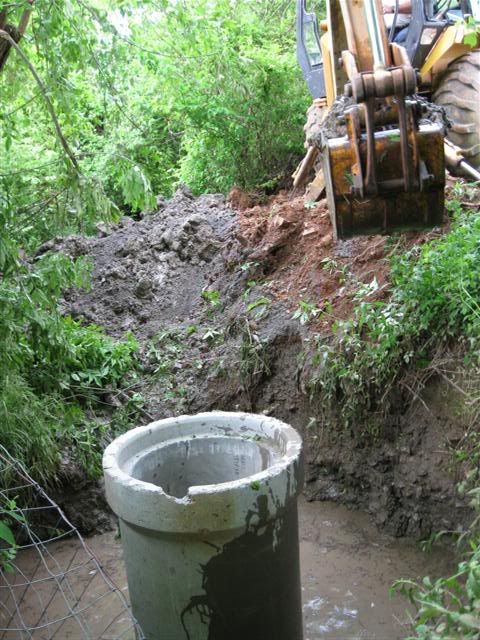

It's in!
Finally got the 'hoe here. I poured a 4" concrete floor in the bottom of the culvert, then drilled 20 or so 1/2" holes around the base up to about 2'. The culvert was then lowered into the hole & it was backfilled. It took about 3 hrs for the water to seek it's own level.
My only possible issue is the two 1 1/2 inch sch 40 pvc fittings that I had to connect under about 6" of water. I think that is pushing the "rain or shine" pvc glue to it's max:cool:. If it doesn't hold, I will have to use a flex pipe with clamps to run 3'. Two gallons of bleach also went into the cassion to sanitize it. I am going to let the glue set until tomorrow before testing.

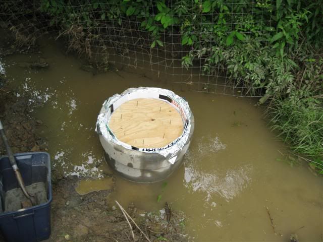

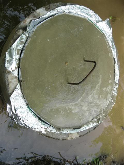

I cut a piece of plywood, lined the rim with "Release(non stick) foil, then poured a concrete lid using 2 bags of sacrete.
I'll post results of the test tomorrow.........{fingers crossed}
