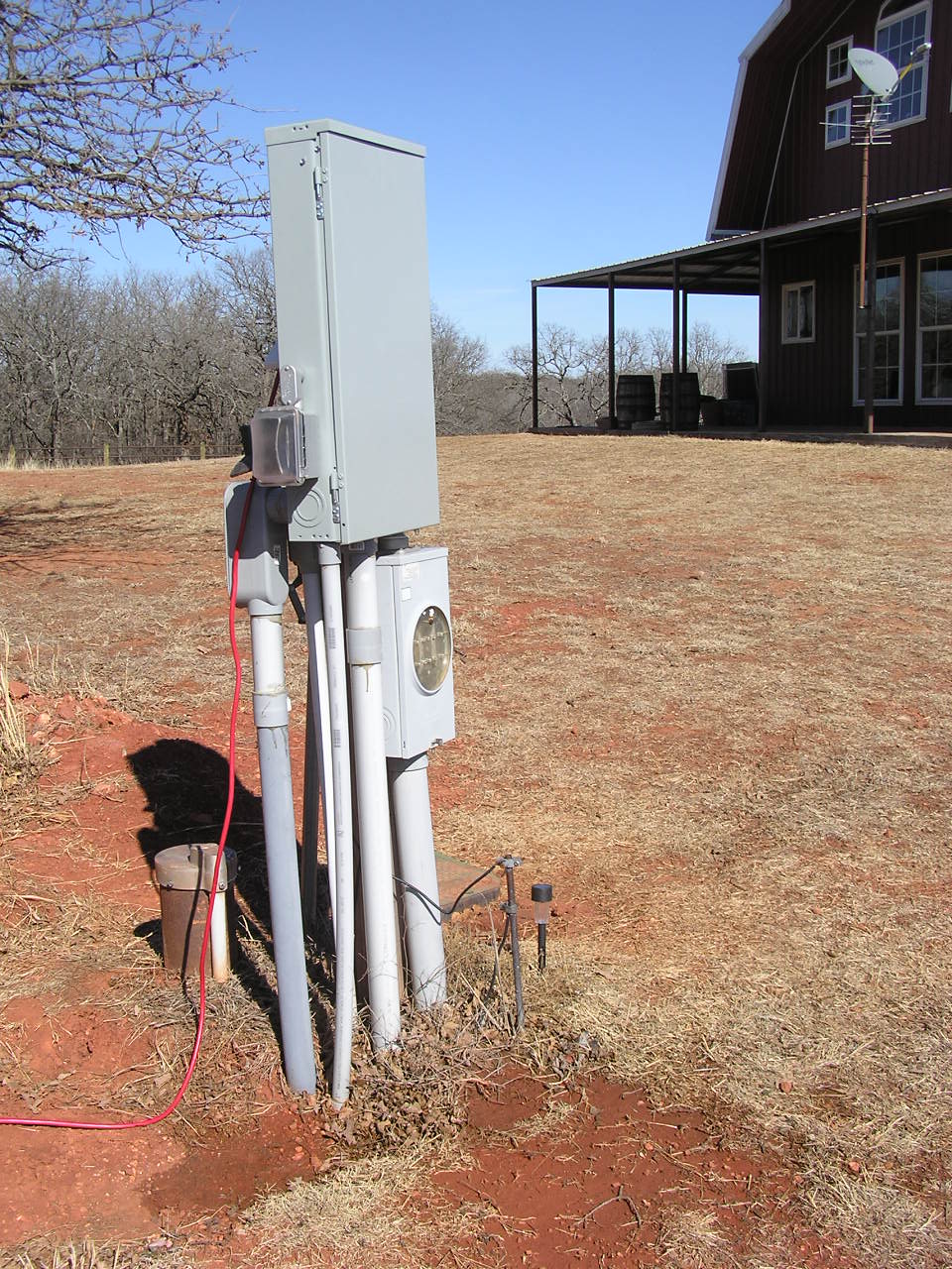

I did find something that would do what I to do. It is an AC current sensor relay. I can wire the light to it or a wireless transmitter to a light in the house, or both.

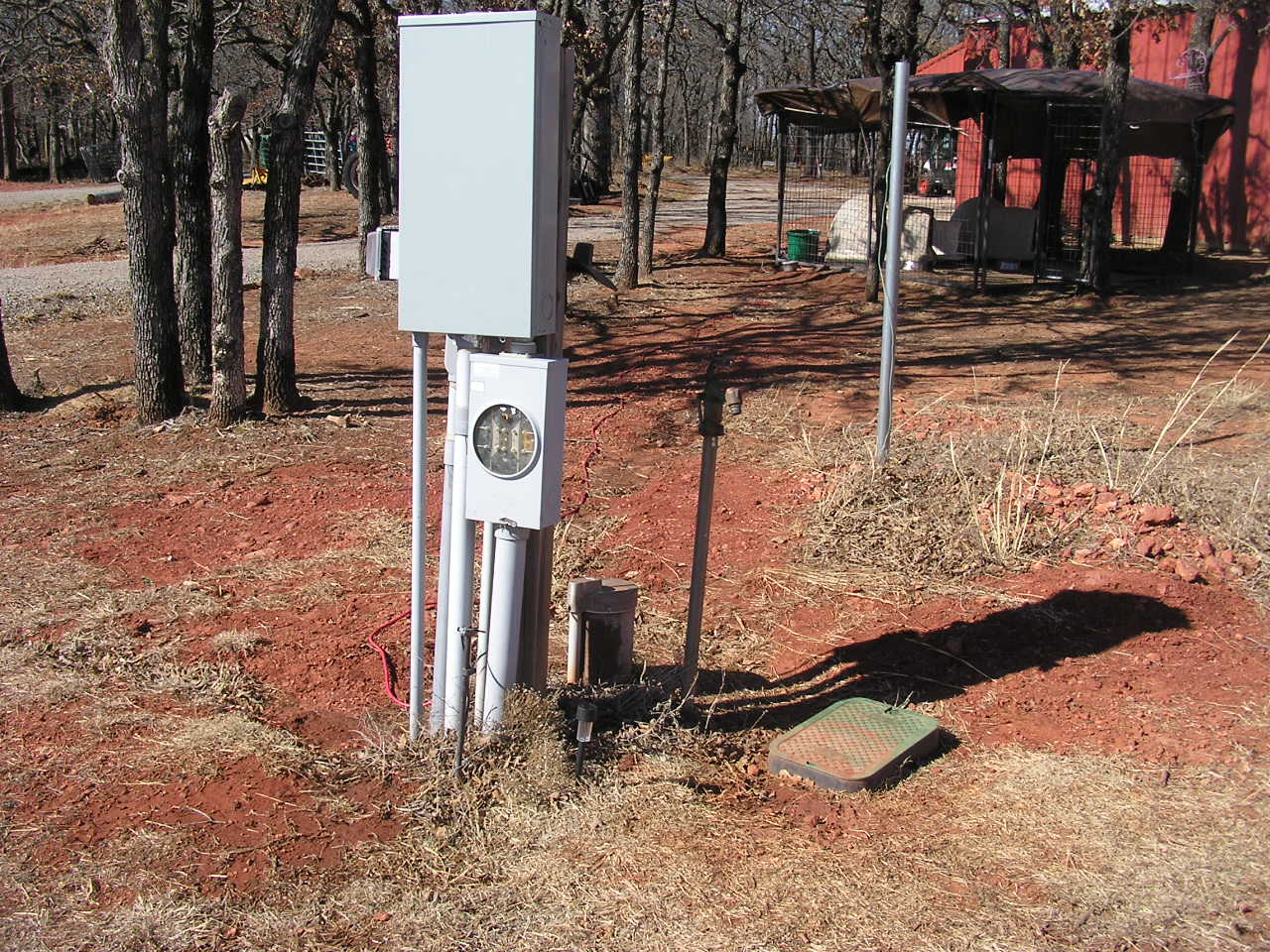

I need a way to know when the 240 volt water well pump is running.
Is there some wireless device that would turn on a light in the house when the pump is drawing current? There is no well house, We were told the pressure tank is in the casing, so I don't know if I can get to the pressure switch.
The pump is on a breaker box about 50 feet from the house. The power to that box runs underground from the meter at the transformer box that is fed by an underground line from the power pole. That breaker box feeds two other buildings.
Thanks
I will guarantee you one thing:
A few months after you install an indicator light, you will forget about looking at it.
I know, I put a monitor light on our pump when I built our house, the only time it got noticed is when a guest would occasionally ask what "that light" was for.
If you want a more practical monitor light, install a pressure switch on the water line where it enters the house, then set it slightly below your pump's cut-in pressure.
When the light comes on you'll know you have a problem because it is something you haven't become accustomed to ignoring..

I have no idea how big the tank is, but the pump just happened to come on while I was looking down the casing, it ran longer than I expected. I need to put the pressure gauge on the faucet there and check the run time.

Yep, good advice.
A light wired that way would tell me that the pump wasn't running when it should be running. I would find that out without a light the next time I opened a faucet and saw low or no flow.
If there is a leak or a hydrant left open, I think this pump will keep the pressure above the cut-in pressure. I need to do more research after the snow melts!

The info that I need is, Pump on pressure, pump off pressure and will it cycle while the hydrant is open, or what the pressure is, as long as the valve is open. I need to know if the running pressure drops below the turn on pressure.
