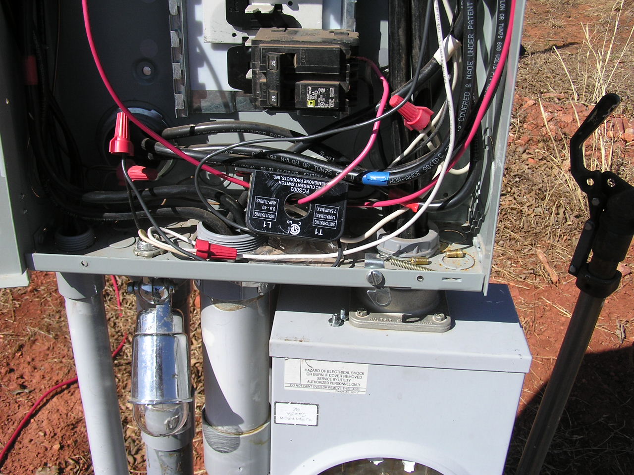

Thanks for every ones ideas. Several have mentioned the pressure switch, it is in the casing, but I think I can pull it up to where I can get to it. But if I wire to the switch, it doesn't tell me the the pump is running, only that it should be running. That would still work for what I need.
However for me, the AC current sensing switch will be easier to wire in, and the contacts only close when the pump is running. Now I have to get the parts, and do it to it!
Here is the current sensing switch: http://www.premieroneproducts.com/PremierOne_Products,_Inc./Accessories.html

Just an update, found the AC current sensing switch on eBay, hooked it up to a light today to test it.
It works :thumbsup: Light on = pump running, light off = pump off.

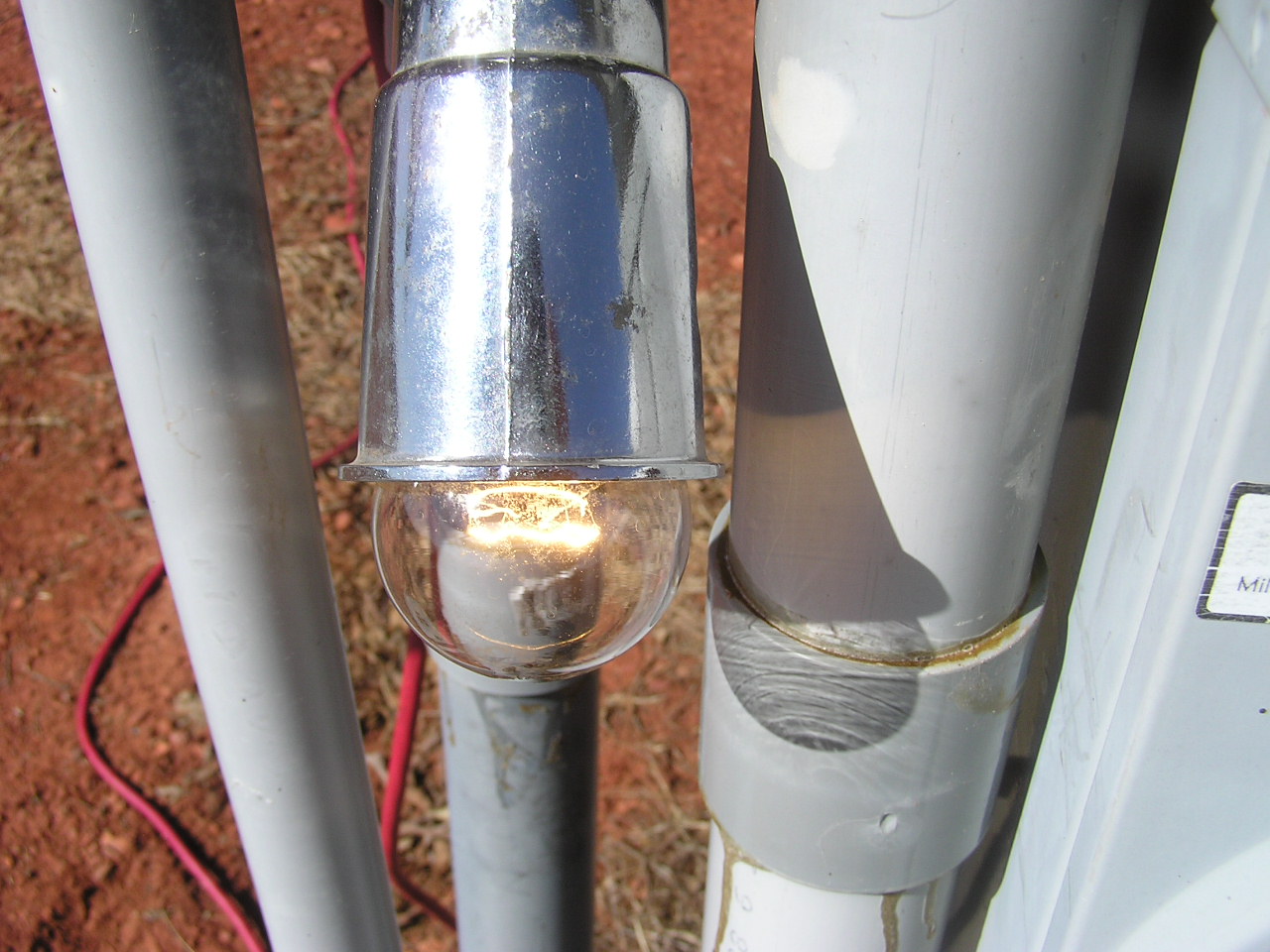

Got it permanently wired, works great. Red wire, one leg, 240VAC from pump breaker through the hole in the switch.
40 watt appliance light.
24psi valve wide open with garden hose.
View from house. :thumbsup:

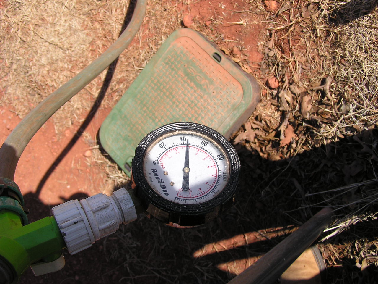

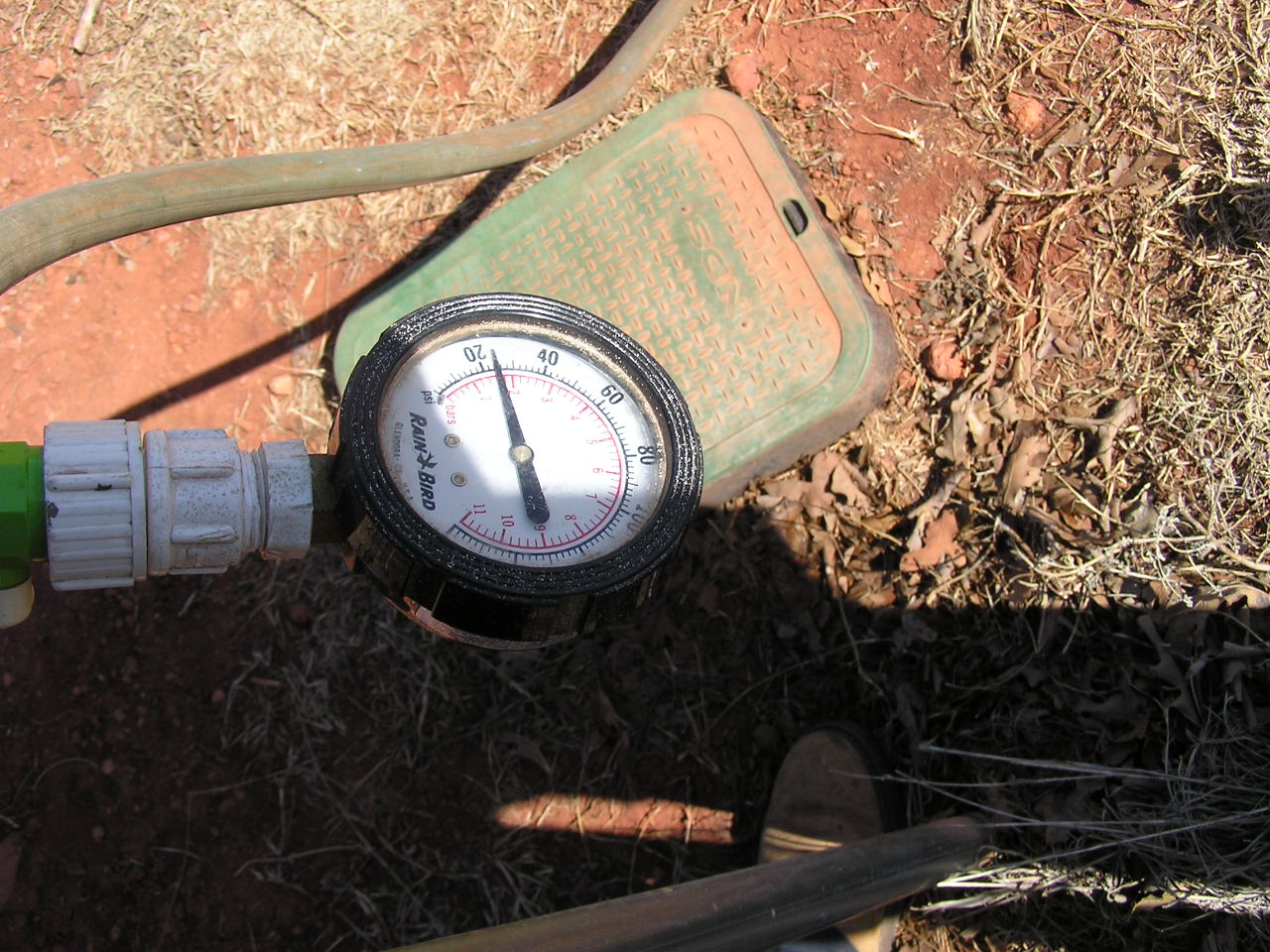

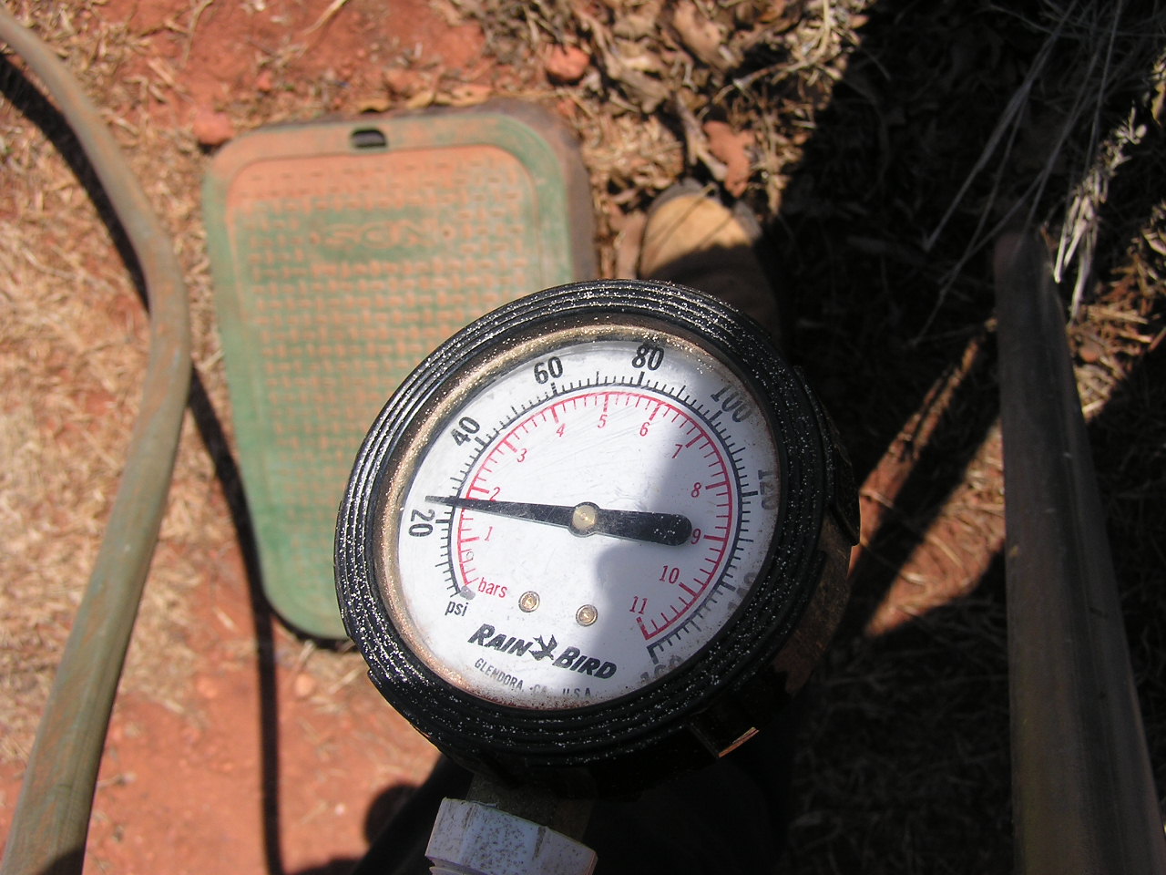

The pressure tank is in the 6" casing along with a Cycle Stop Valve that runs 10 gallons a minute at 24 psi.
The pressure switch is on a flexible line, so it can be pulled up if need be.
The pressure switch cut in is 40 psi, off at 50 psi. The pump does not cycle off while using water.
Pump off.
Pump on, pressure drops immediately to 24 psi and stays there.
When you shut the faucet, pressure rises as the pressure tank fills to 50 psi, then the pump shuts off.
