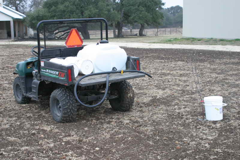

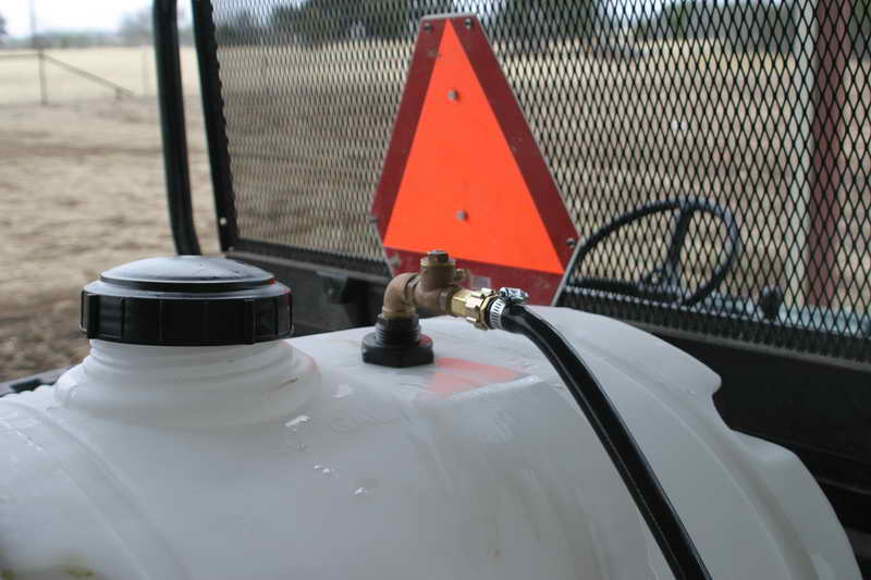

I, uh, used my tractor to dig the holes to plant these trees. So there's the required tractor involvement.

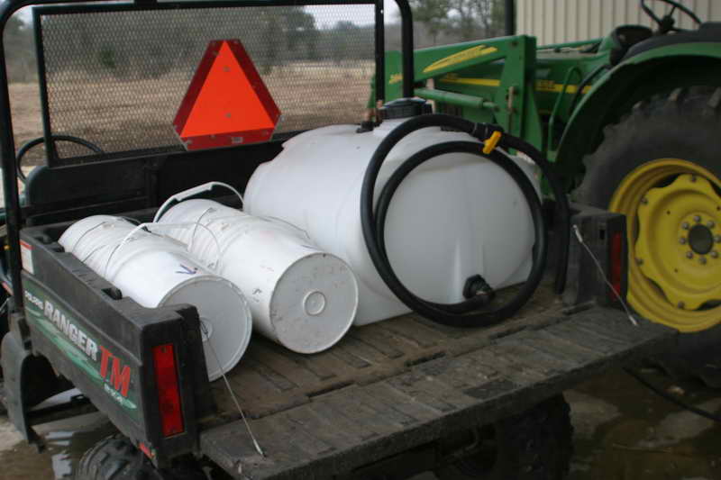

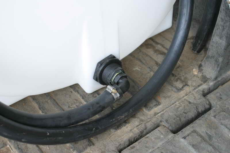

The tank is 50 gallon and I purchase it down at the local ag sprayer equipment dealer. I like to buy from these guys because they have everything you can imagine and the tanks come with no holes so you can locate and drill your own.
The drain hose is 1" with a cut off valve about 2' from the end of the hose. The inlet for filling the tank is 1/2" with a check valve and garden hose adapter. The check valve keeps water from sloshing out when you drive around, prevents flow back into the garden hose and acts as an extra air inlet when letting the water out.

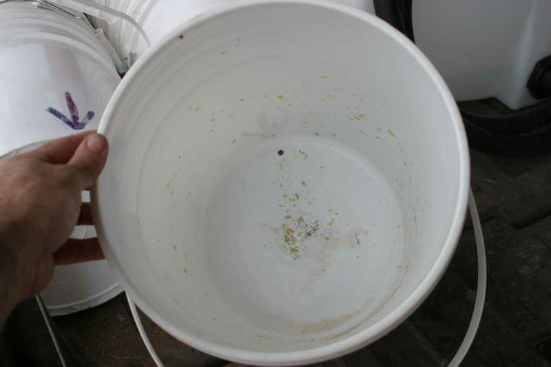

I pour water into 5 gallon buckets that have a single 1/4" hole drilled in the bottom. This lets the water out slowly which, as we all know, is the proper way to water a tree.
I was pretty pleased with the flow volume. I can fill a bucket just about as fast as I can with a garden hose.
This set up would work well in the FEL of my tractor. I could lift it up to get even more water pressure and a good, strong flow, but it works like it is.

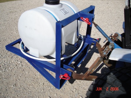

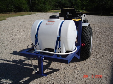

Your polaris looks like it has the suspension to hold a 50gal tank, I have a 35gal tank that was killing my electric golf cart so I did something a little different, here is my tree watering tool.

I figure the tank weighs 450lb full and my Polaris is rated for 1000lb, so it handles it well. When it's empty, it is light enough to move very easily.
I think this tank was around $180 or so. A plastic 55 gal drum would have been much cheaper, but what the heck, you only go around life once.
I'm watering fruit trees. I planted 15 of them this year. It takes me two trips and I wish I had been able to locate a 75 gallon tank so I could do it in one, but I'm happy enough with the existing set up. The 100 gal tank was too big to fit like I wanted it to in the back of the Polaris.
Now that I'm done, it will probably rain for the next two months.

Rob, I don't want to disagree with Gary at all, but I would suggest you start with a much smaller hole in the 5-gal bucket. You might be surprised how quickly a 1/4" hole will drain. We normally use something as small as 0.030". That size hole is easier to plug with trash, but the water never runs away and evaporates. You can always easily make the hole larger if you need it. I think a fast drip will produce the best use of water and not soak the ground. this method works good with tomato plants also. A large plant needs about 5 gal per day and this method is a lot like a drip irrigation system for po' folks.

I haven't timed exactly how long it takes to drain the bucket with a 1/4" hole, but I'd say it takes maybe 3 minutes or so. With the bucket sitting on the ground, it slows it down and towards the end, the water flow out of the bucket slows way down. It's as good or better than using a garden hose truned down to a trickle.
