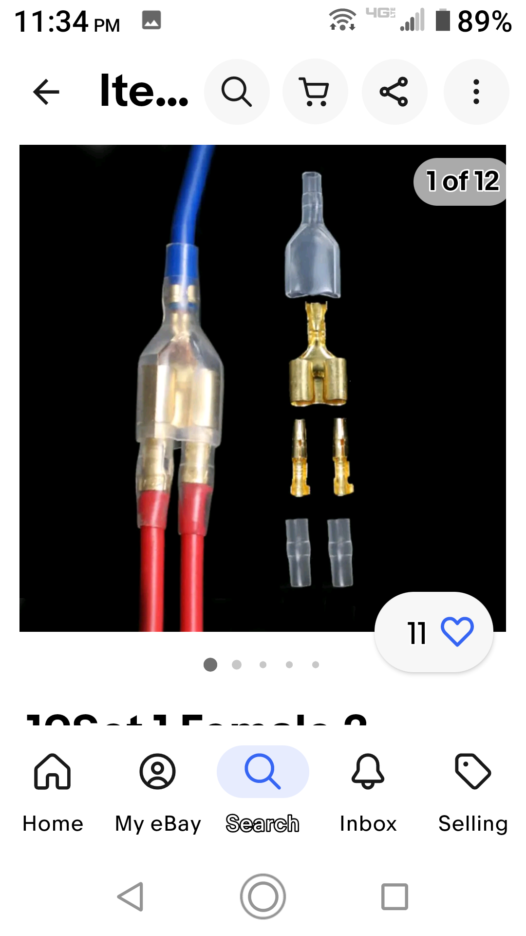

I have a somewhat related question on the subject of low-voltage wire connecting:
What do you all do for T-joints (like you might find on trailer wiring)?
I'm happy to solder joints, but how do you seal them after? Even putting 2 of the wires inline makes it hard to get a good seal with heat shrink.
Liquid tape.

Adhesive lined heat shrink.
Instead of the end with the two wires coming out directly side by side, I separate them a bit and while the heat shrink is still warm and melted slightly, squeeze the area in between the two wires with a pair of needlenose pliers. You don't squeeze the crap outta' them, just enough to make the tubing conform to each wire and stick together.

Somewhat water resistant junction box/bus bars work great on larger trailer wiring. Crimp style split splices make me cringe. As mentioned earlier Marine style heat shrink has adhesive/ sealing properties on inside. Quite a few different options out there not requiring soldering.
