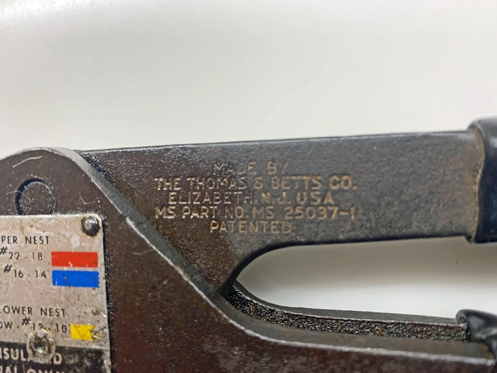

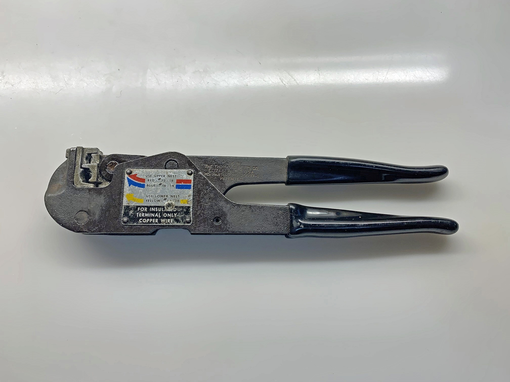

I agree. I think the main reason crimp joints fail is because an inferior tool was used.
I've been using one of the original crimp tools made by Thomas & Betts since the early 1960's:
I haven't had a crimp joint fail in over 60 years.

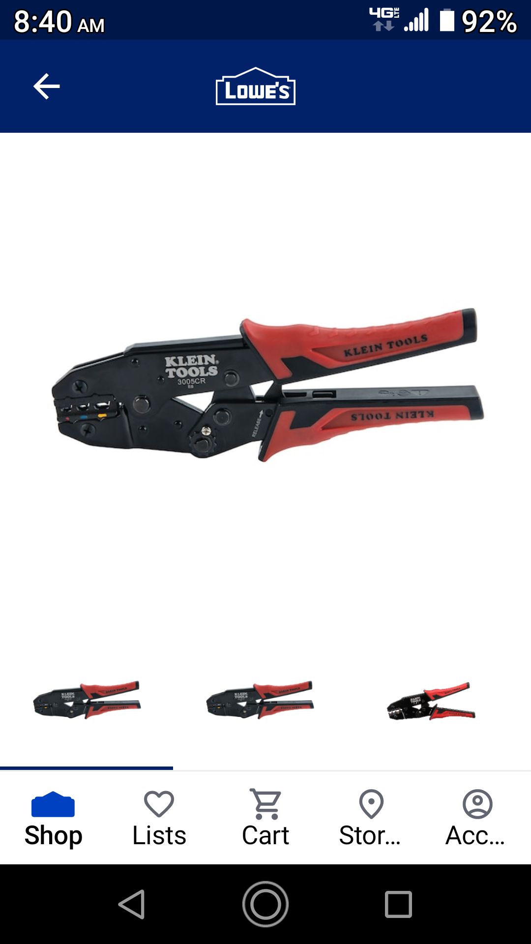

I use a crimping tool like this 15 yrs ago they were a lot more expensive,that won't over squeeze the splice, cuz you over do it your damaging the stranded wire. Cheap but splice connectors don't work the best with these in my experiences, always do a brief pull test on your splice if it looks good but pulls out of wire it will fail. I also put a small dab of dielectric grease on the splices before crimping or heat shrinking probably an overkill but failing electrical due to screwed up splices on wiring that I did on a trailer, boat, or anything is a peeve of mine. Merry Xmas 🎄
