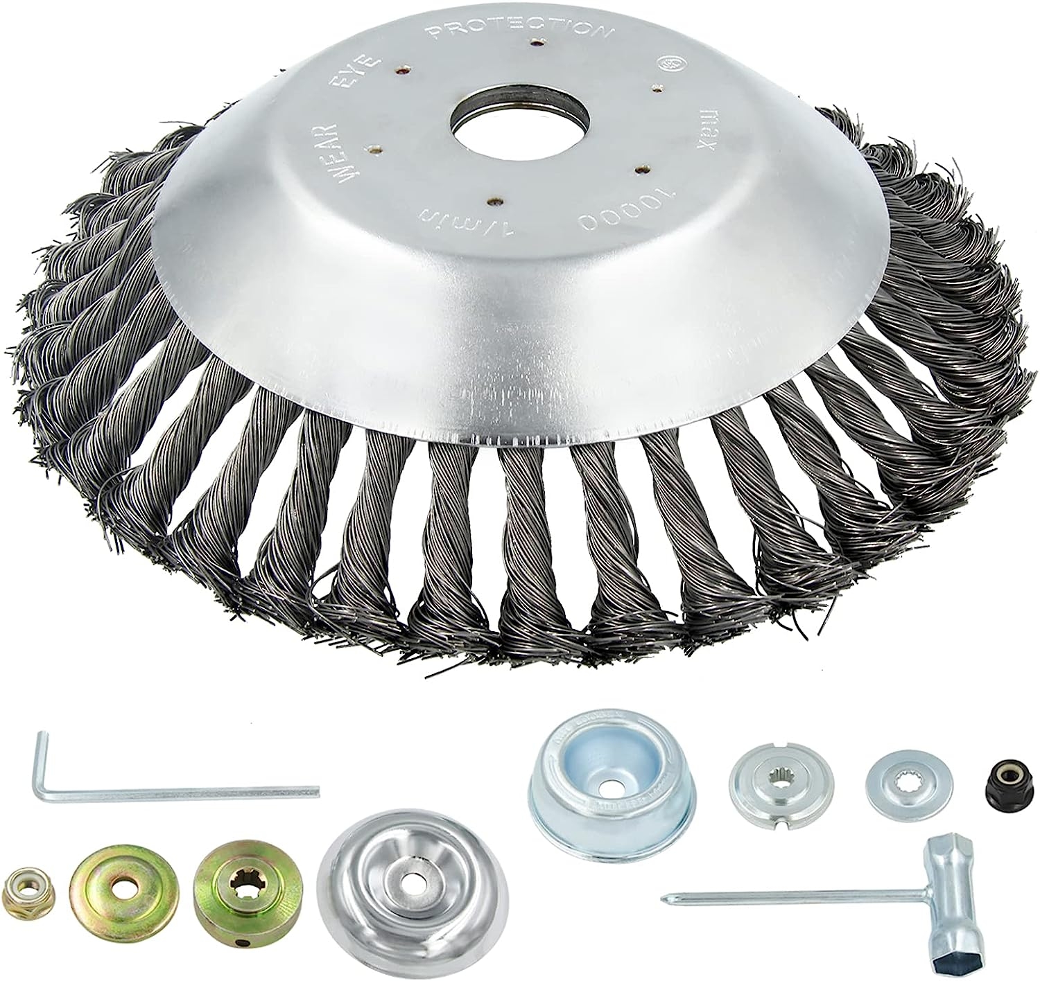

I have 2 fairly heavy duty gas weed eaters. They worked okay until a couple years ago when I got fed up with trimming. My problem is I have some viny long weeds in deep ditches. The viny stuff gets wrapped around the shaft along with weeds and after un clogging the head a few times I just give up to where if I can't get it with the garden tractor with 62" deck or with weed killer I don't do it.
I came across knotted wire weed eater ends that seems it might work better than a saw blade end or a string end. Did anyone here use these and would you suggest a certain style that might work for me.
I understand it would be easier to keep weeds under control after they are cut short the first time, but the first cutting is where I really struggle.

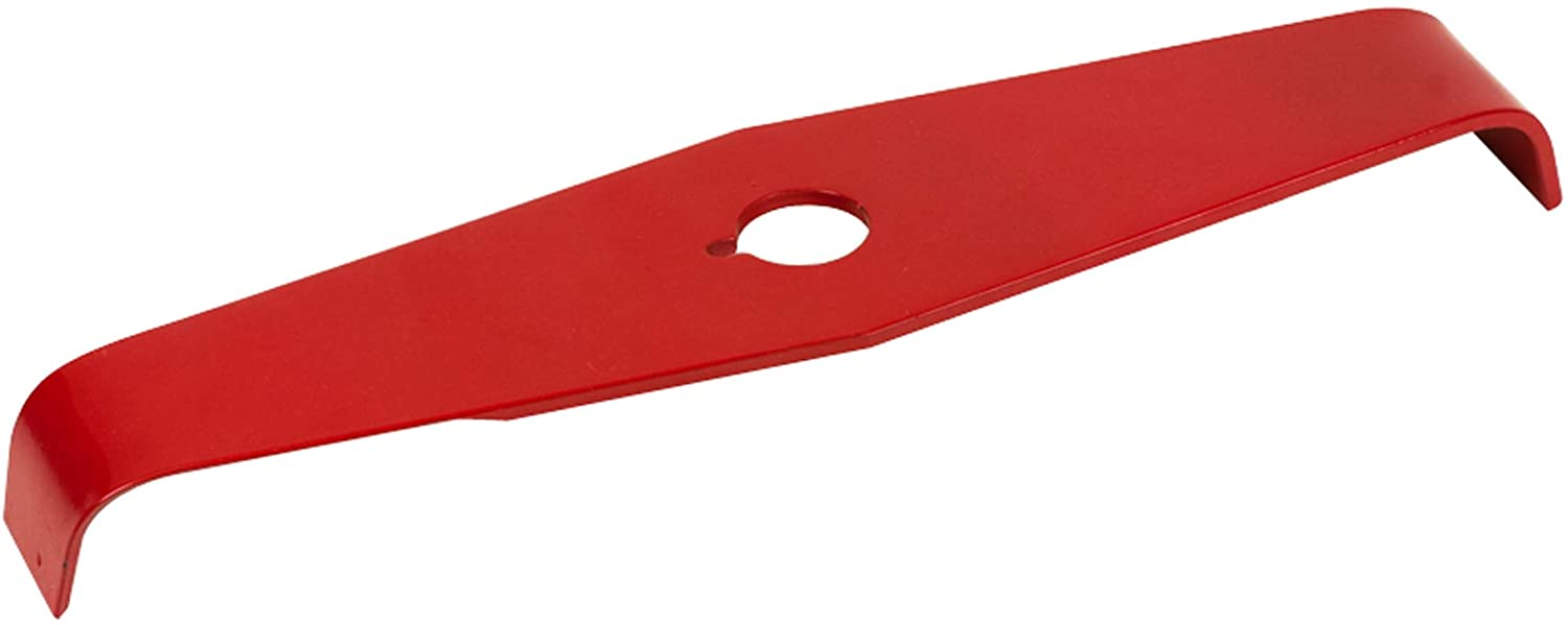

I use a renegade red blade and cut through tons of vines, never have them wrap the blade, so far.
That knotted head looks like it would be good for removing rust.

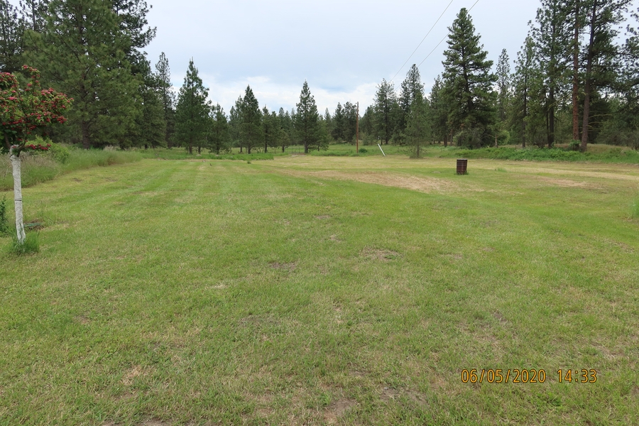

My new JD 570 only has to mow field grass and normal lawn. One of my nicest "lawns" is a meadow that - after repeated cutting - has become pretty nice. A pic of the meadow.

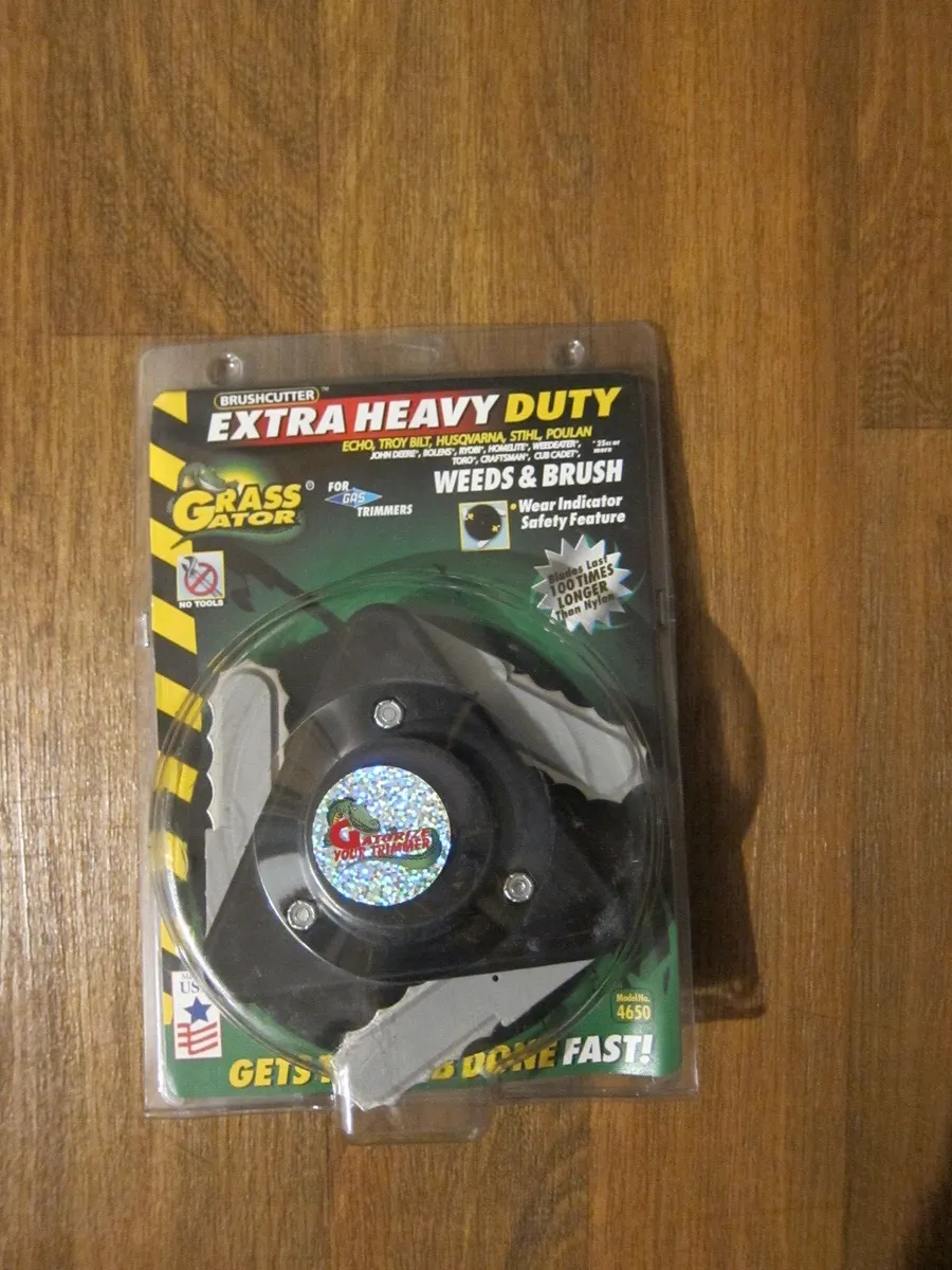

I stumbled across a brand new one of these in my shelves I aquired from a garage clean out somewhere. I tried it out in problem areas and it works great. Scary looking though when running.

I've used those things that Oaktree posted from Home Depot, and they work pretty good. These here are awesome. Shred blackberries down to the ground, grass OK too. The three pointers do OK for cutting.
I bought one of these to try. Haven't used it yet, but seems pretty heavy compared to other steel blades I have used.
