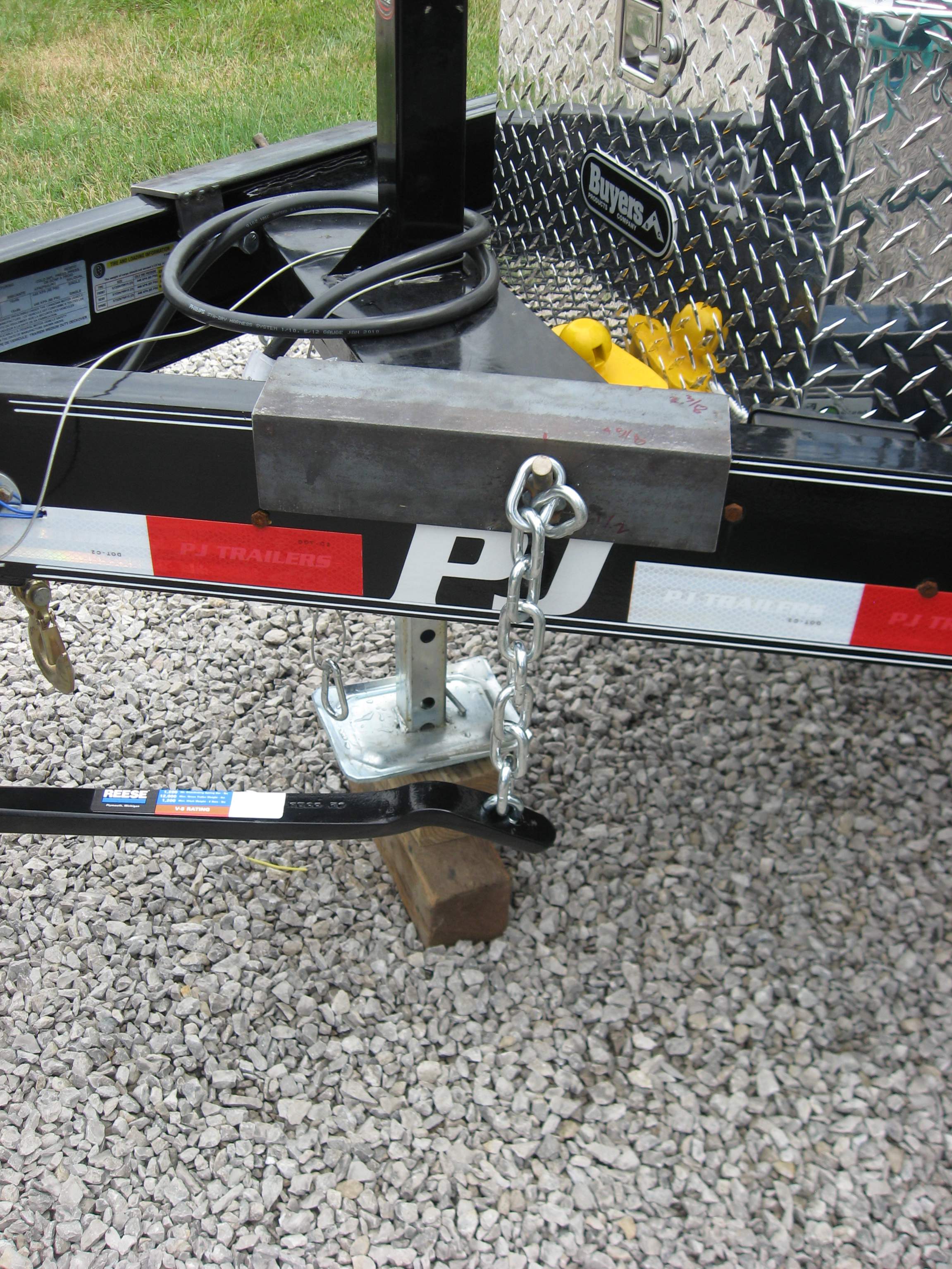

   / Weight Distribution Hitch Question #18
IMG_2422.jpg"Will a wdh work with this trailer?"
Back to this question for a moment, you can make a WDH work with just about any trailer, but be aware that you may have to do a little engineering to get the chain hangers to work. Typically, the hangars just clip onto the tongue and are held in place with bolts, but on mine, the crossmember holding the tongue jack was right in the location I needed to place the chain hangers. My solution was to fabricate new chain hangers that had two bolts and spanned across the 6 inch crossmember.
There are also chain hangers that can be welded onto the outside of the tongue, if you want to go that way.
