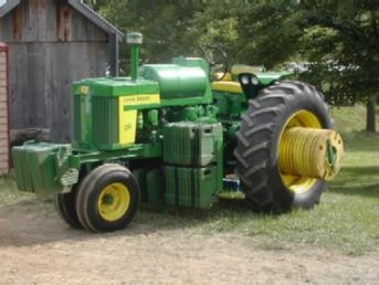

Here is a picture that I saw a while back that depicts a properly ballasted tractor :)
Love that picture.:D Probably has fluid in the front and rear tires with the weights.
   / Weight is bad #56
I think its a safe bet that its set up for pulling competition. Those guys really pile the weight on!
