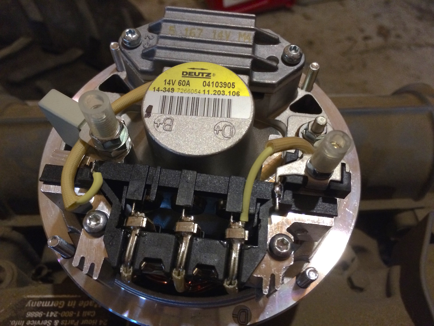

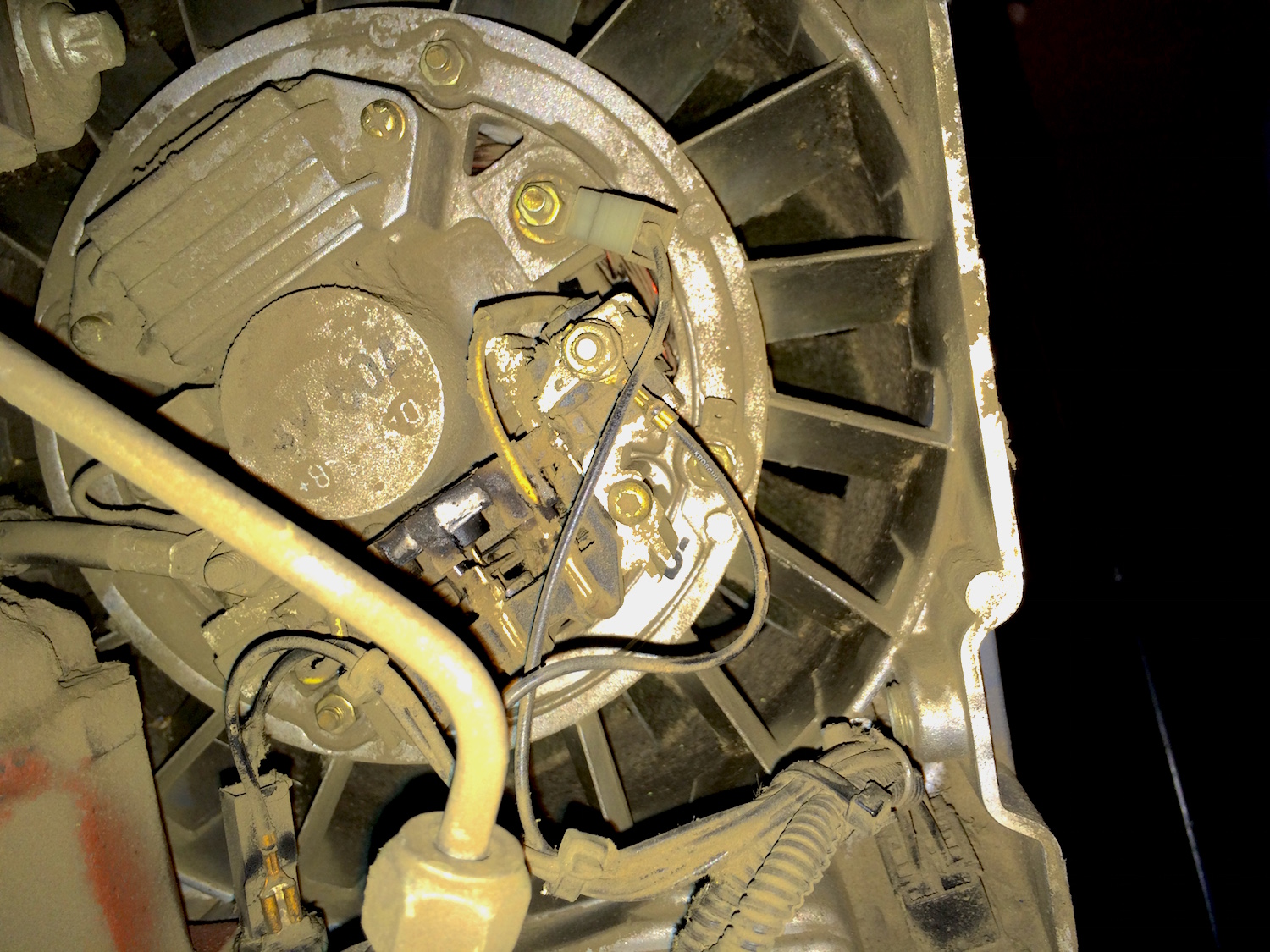

I've attached a picture of the alternator showing the connections that I took to remind me where the wires go. UPDATE: and I added a picture of the shiny new one too. These alternators are made out of unicorn hair and diamonds, btw.

Yup.. in lieu of a 'red flag', if all the other circuits check out and are operational, the next major component is the alt itself. And there are possibilities of internal failures that, while rare, could account for odd behavior like this.
One thing that comes to mind was excessive charge rate. IE.. over 20, but under 50 ( as the 50a fuse did not pop ), but the 20a breaker WAS opening.
   / Weird electrical puzzler - breaker pops, the PT1850 runs better until it's shut off #59
Yes, they are pricey little items. Make sure that you keep the B+ and D+ connections straight.
I just mention the battery cables and connections because a common cause of death for alternators is an open battery circuit.
Looking at your photo, it seems to me that one or more of your diodes is fried. Look between the three windings, the plastic looks decidedly charred.
All the best,
Peter
   / Weird electrical puzzler - breaker pops, the PT1850 runs better until it's shut off #60
agreed. and a failure in the trio is what I was lenaing on. I think one was shorted, and is now open. ;)
