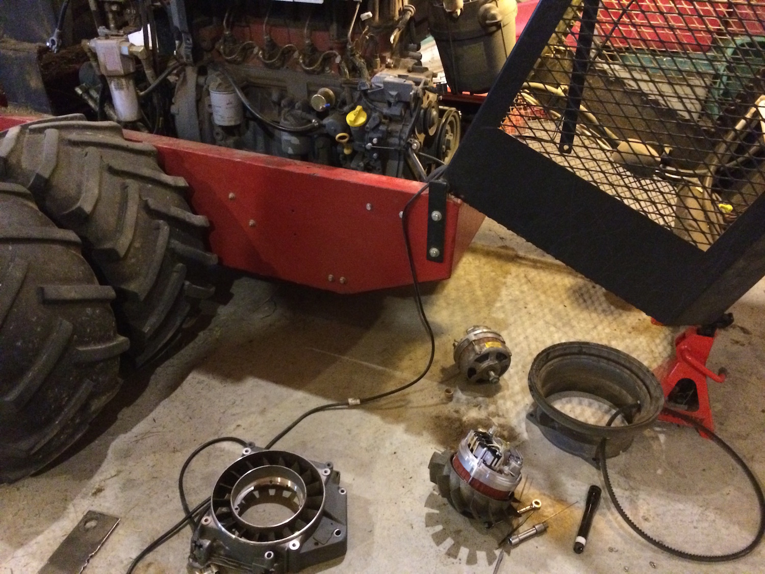

The existing alt is dirty, and as excess heat, often from dust/dirt stuck to fan blades etc. can cause electronics to run erratically, and or fail due to lack of cooling needed to dissipate excess heat from the voltage regulator, diodes and the like.
The voltage regulator is at the top of the alt, with the 2 torx screws holding it's rectangular shape in place. If it were my machine I'd thoroughly blow out all evidence of dust and dirt from the existing alt, and fan blades, including using contact cleaner or small doses of Brakleen on the various terminals and connections going to/from the alt.
This might not solve your problem, but it might show visible signs of burnt sections of the alternator that another pic after cleaning could help us verify what may be happening.
Or you could just bolt up the new one and be done with it at this point, hoping that the alt is the culprit.
Do they core charge on those puppies? If not, I'd keep the old alt for possible use by someone else who might be able to get yours rebuilt for a fraction of the cost of a new one; or for you as a rebuildable spare, just in case.
And whatever you do, try like h^5l to keep the new one clean by periodic compressed air use.

The new alternator is in. I've attached the photo I took at the "what could go wrong??" moment where the old one was out and the new one was on its way in.
Drum-roll.... Not much change. The charging voltage is 14.6 instead of 14.8, which makes me a little calmer (but probably isn't significant). Tractor starts, runs, didn't pop the breaker while I stood there (about a minute).
So I think I will button it back up, head out to do a project with it and see if I can figure out what accessory isn't working (back to the "fail open" theory).
If all the accessories work, maybe the elves came and fixed it?

Yes -- the alternator and all the housings were *VERY* dirty. I've been cleaning it wrong for all these years, not realizing that I need to blow out the alternator in addition to the cooling fins. I had to take the housings outside so that I didn't choke to death when I blew them out.
I think I may have replaced an operational alternator, but that's OK. Now I've got a backup.
The weird voltage drop and popping breaker disappeared a few days ago -- so now we have the dreaded "intermittent failure" puzzler. I think I'll just whale on it for a while and see what happens.

You do have a good used alternator. I believe your issue is solved, and an expensive lesson learned, regarding the alternator replacement, unfortunately. But if you have solved the problem then all is well, and you'll know to keep her clean, including the new one coming in soon.
