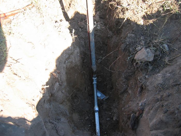

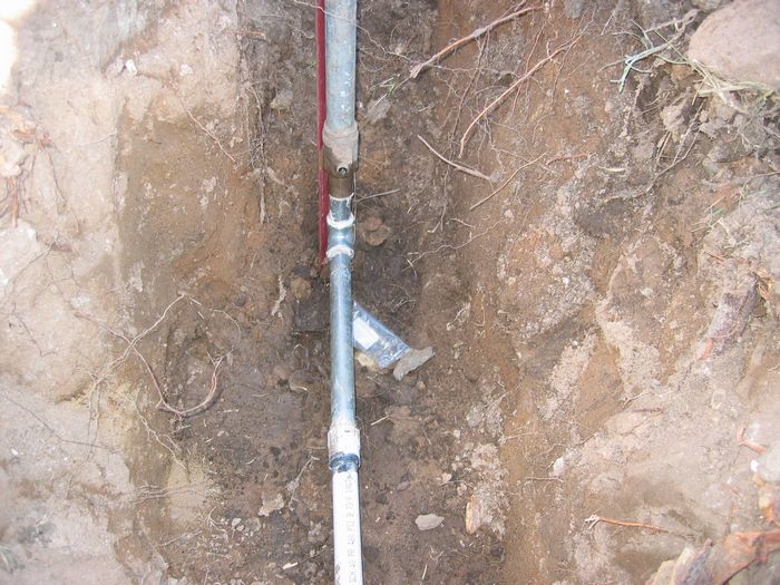

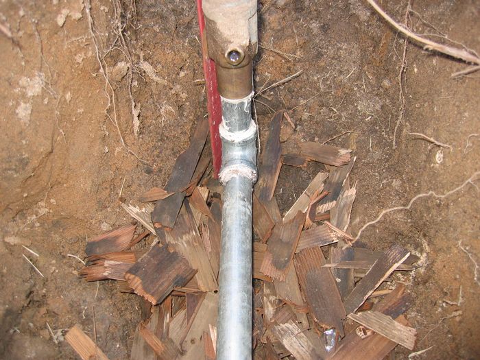

The pictures I've attached are pics I took back in 2010 of how I reinstalled it back in 2010. The friend who put them in had installed them with a pvc street elbow and it got broke. So I replaced it with a galvanized elbow as well as piece of 1ft long galvanized pipe.
Then I connected it to the pvc. I didn't really want to use the female pvc connector to the galvanized. But I had picked up the female connector instead of the male connector. The store was 30 miles away so wasn't gonna run back in just for the fitting and connected it all up. So far it hasn't split like I was thinking it would.
And although the pics don't show it. I did fill it up with Gravel before covering it back up. Also that hole was dug out by hand. I ain't doing that again. I'm using the excavator next time.
Anyway I confirmed it was coming out the drain hole when on. I adjusted it and it was leaking when off. Then I adjusted it again then it reversed and started coming out when the hydrant was on. lol
Anyway I'm just gonna replace it this summer. But thought I would go ahead and throw some pics in that I took back in 2010. I know we all love pics on TBN. xd

Replace with a Woodford and use brass fittings underground. Every galvanized fitting I ever buried eventually failed. That may be a "here" thing, but for the trouble they can cause, it isn't worth taking a chance.
Kim
/ Weird frost proof yard hydrant problem. #11
I noticed you used a short section of galvanized for the last underground horizontal section -- good idea to prevent PVC breakage. When I did my own frost free hydrants, I added a couple street elbows at the 90 deg turn from horizontal to vertical. That way if you happen to back into it or hit it with the backhoe the hydrant can just move on the threads in any direction without breaking any pipe. Of course, if you're in one of the very cold states and the horizontal run is 4' deep, forget that...
