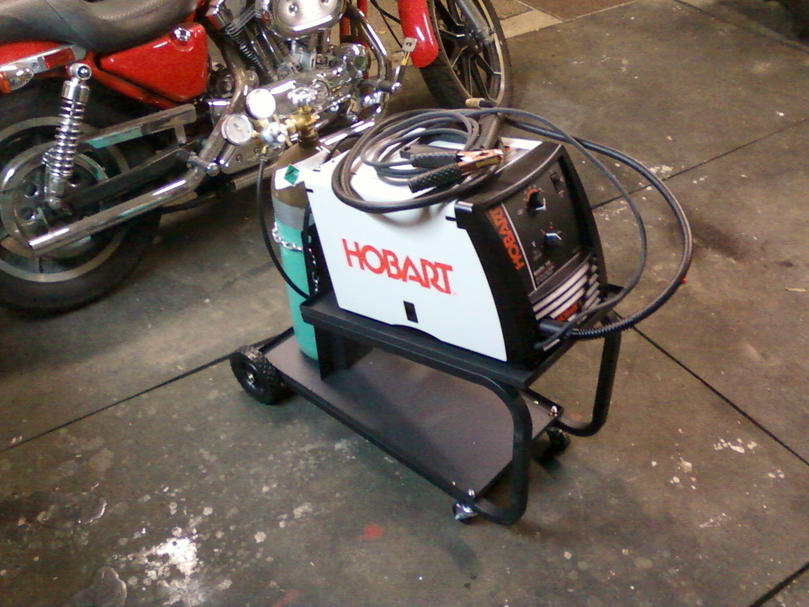

Get yourself a welding helmet(they can be had at tractor supply for about $30 for a cheap hobart with a good size glass) and go watch a welder in action if you want to see an arc in motion. You could get into a decent little MIG setup for under 500 bucks, plus the cost of your gas cylinder...I would recommend if you'll be doing much sheet metal: don't but a flux-core only wire feed machine, they tend to want to burn through. I have a Hobart Handler 140 and I love it... settings are all on the machine(All starting points, you'll have to fine tune a little,) but once you get the hang of the welding thing, it's like riding a bike, it always comes back to you..
