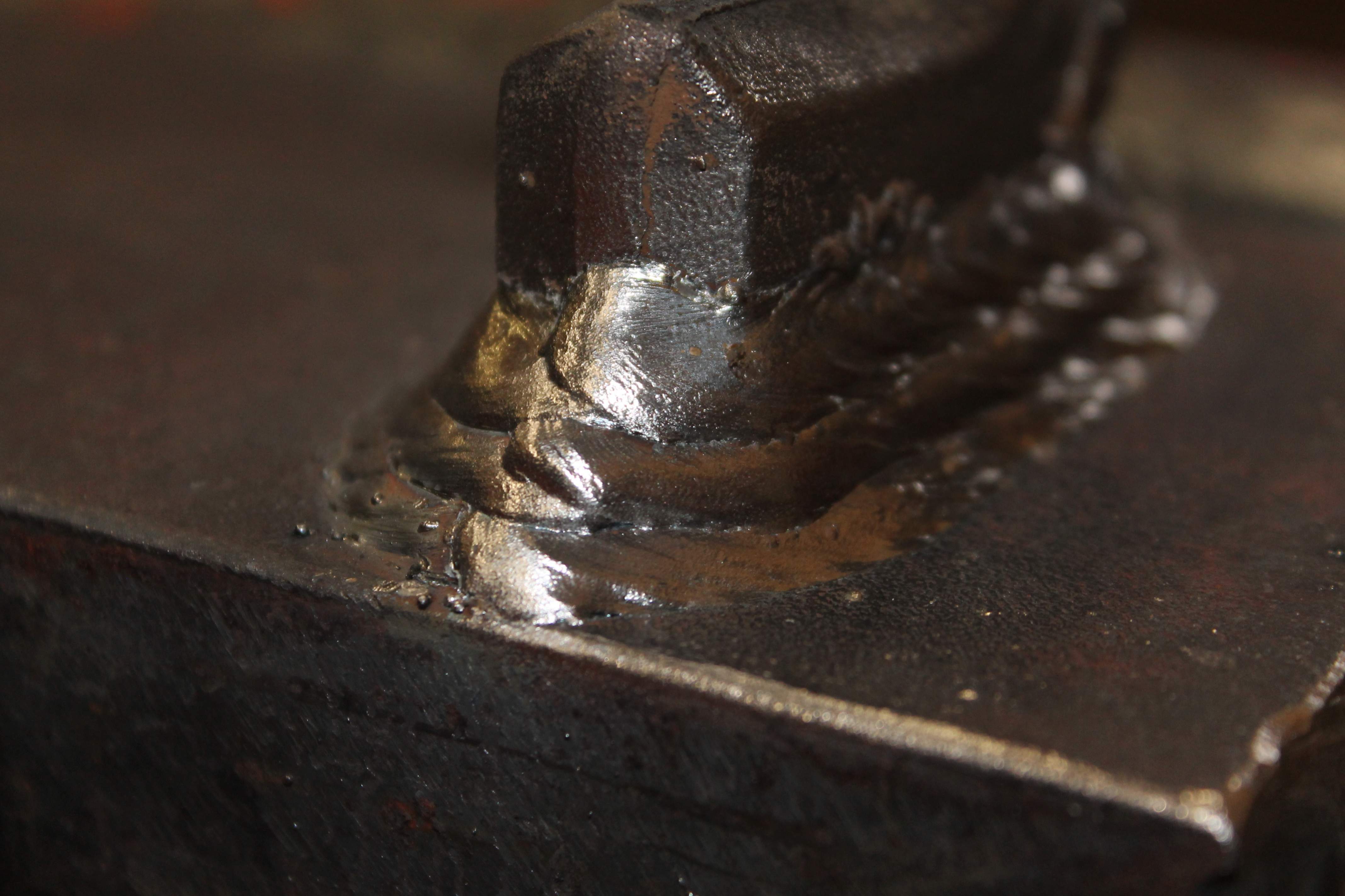

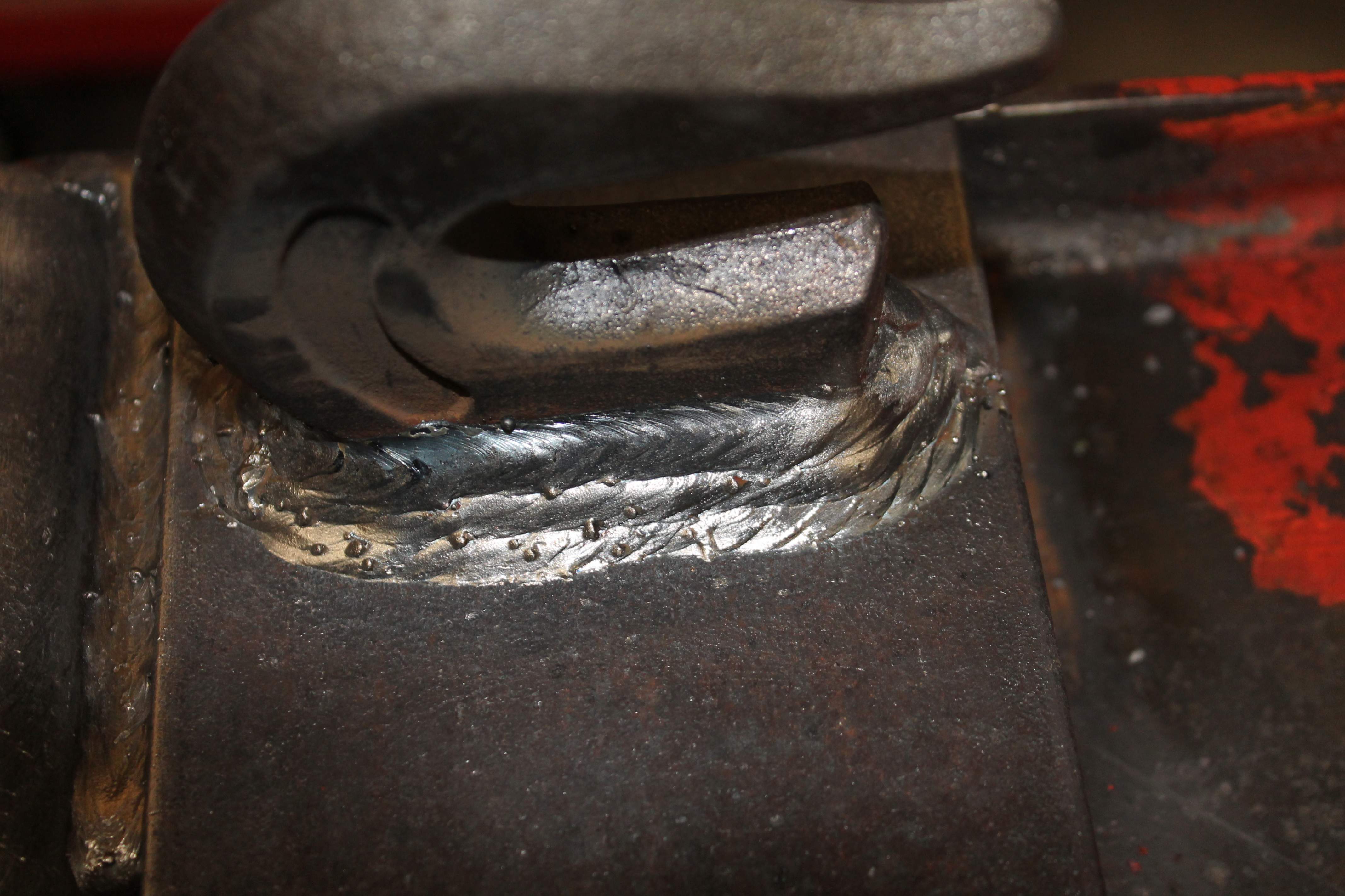

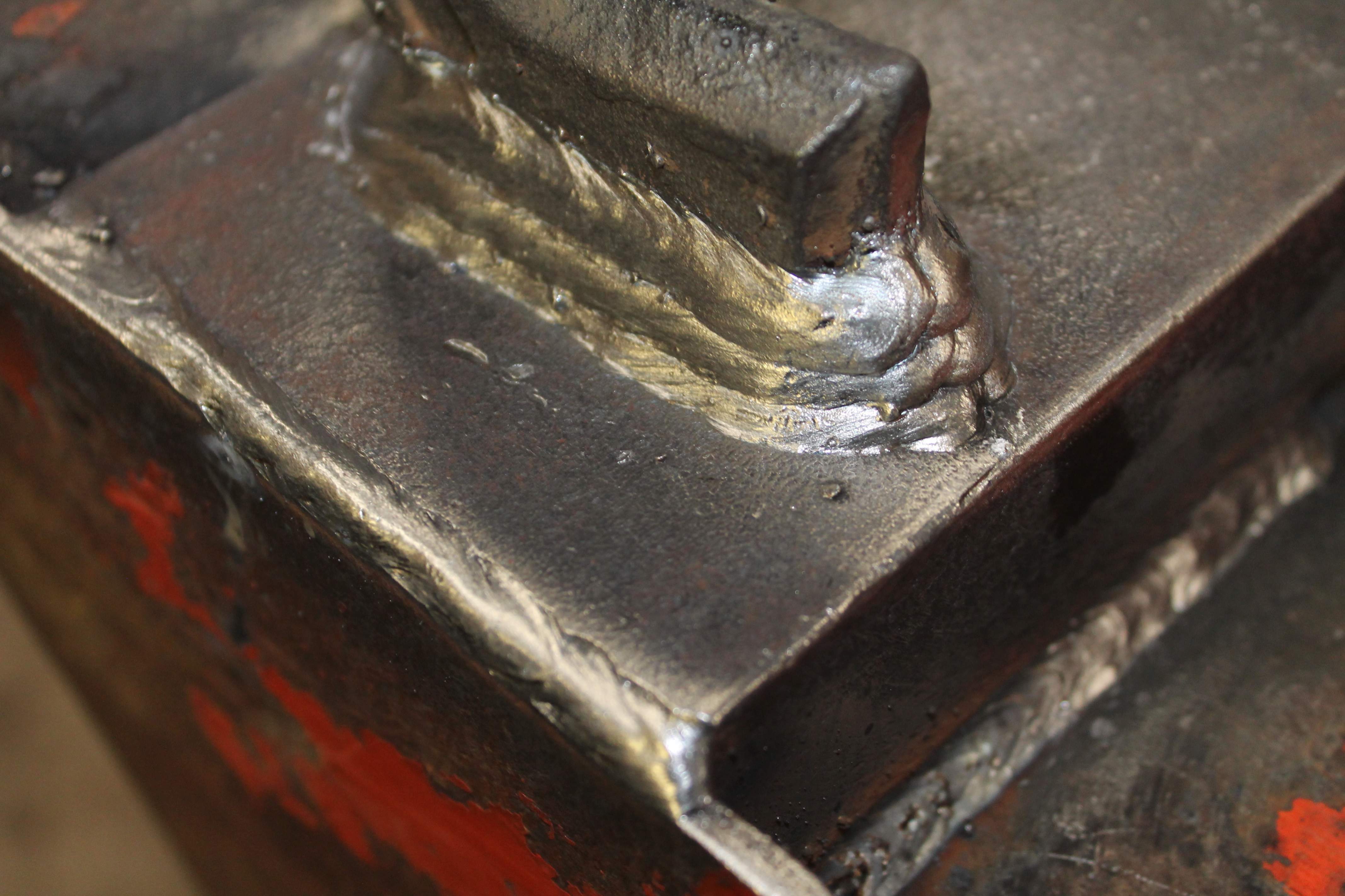

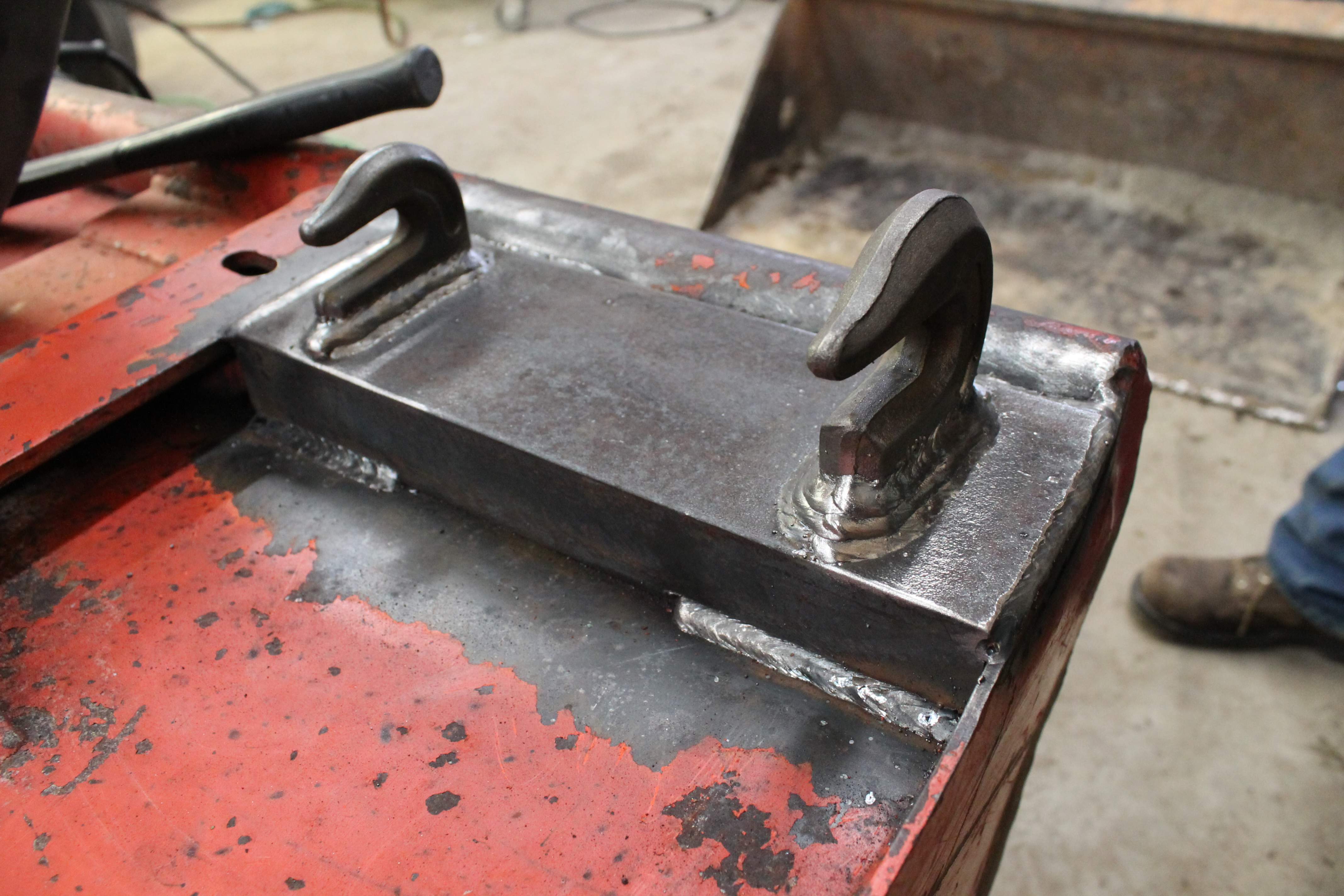

Finished welding the hooks on the loader yesterday. Had to add channel to mount hooks on. Dual loader uses a pipe at top of bucket. I think they'll hold.

Looks pretty darn good to me; wish I had done ours like that.
/ Welded grab hooks #3
Be careful when you use those hooks placed outside of the loader's arms. A heavy load will make the tractor quite tippy even with good ballast.

The welds on the hooks look really good!:thumbsup:
But in the second picture I would put a little more fill in that crater at the heel of the C-channel.;)
Seemed like the best place to put them. The bucket design is different to what I have normally seen with the pipe at the top. I was going to use angle iron, but didn't have anything heavy enough.
I need to wrap the corners going down toward the bottom of the bucket. I hit some paint at the finish of that bead had to grind out some pin holes. Will tie it altogether on the weld on the short corner of the channel.

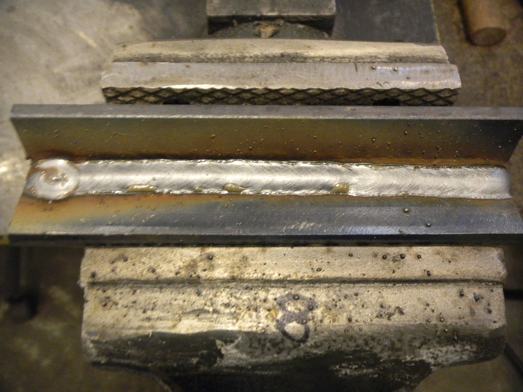

In the second picture the weld on the right all most looks like the wire speed could be turned up a bit. Or maybe your hand was in a bind working towards the corner.

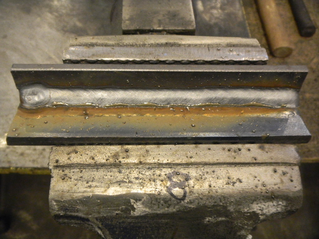

When Mig welding I have a personal policy of running as hot as I can handle it. Out of the hundreds of welding tests I've taken, one of the very few I failed was a vertical up with Mig. It was beautiful! But when the coupons were bent, (side bend) it had too many flaws to pass code. I ran it too cold.
These pictures are of Lincoln's L-56 wire with C25 gas, and a 46-year old CC engine drive.
Looks almost like a spray transfer. I think we used straight argon and cranked the welder up. Made some pretty beads!

No, like I said. I like to run hot!:D

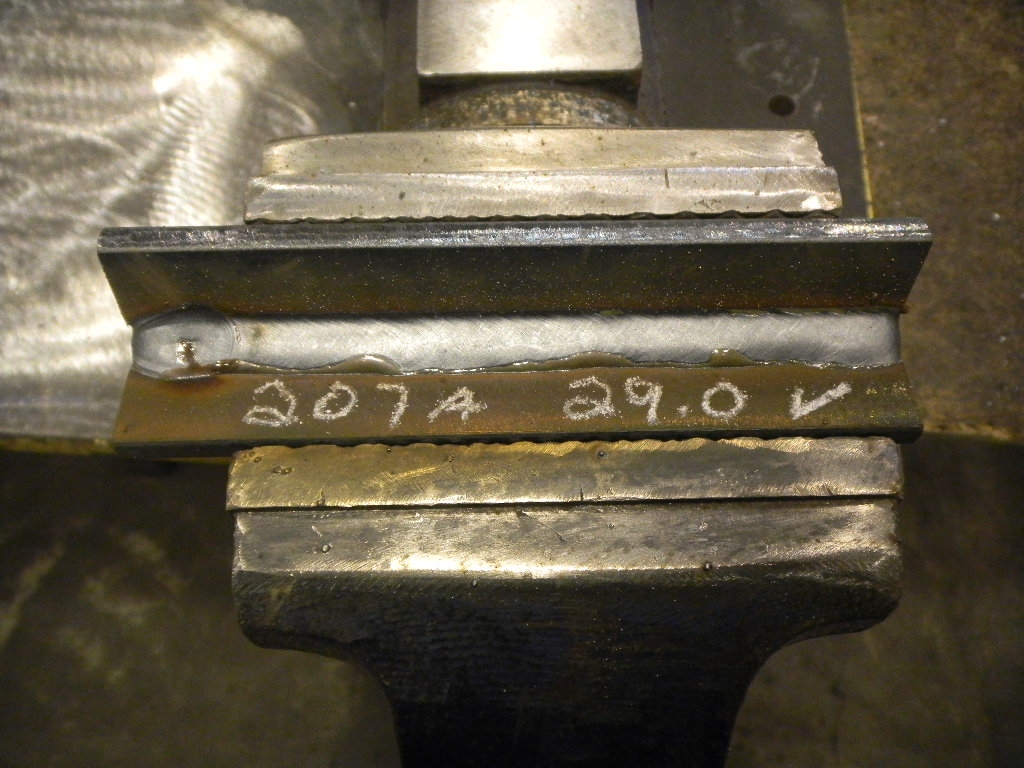

Here is some spray I did with .035 L-56 wire, 90/10 gas, and my Lincoln V350-Pro.

/ Welded grab hooks #14
It's only metal, you still can.
I like that attitude!:thumbsup: When working with metal it is so easy to change if you so desire. It's that God awful wood that's so hard to work with if you change your mind. :laughing:
