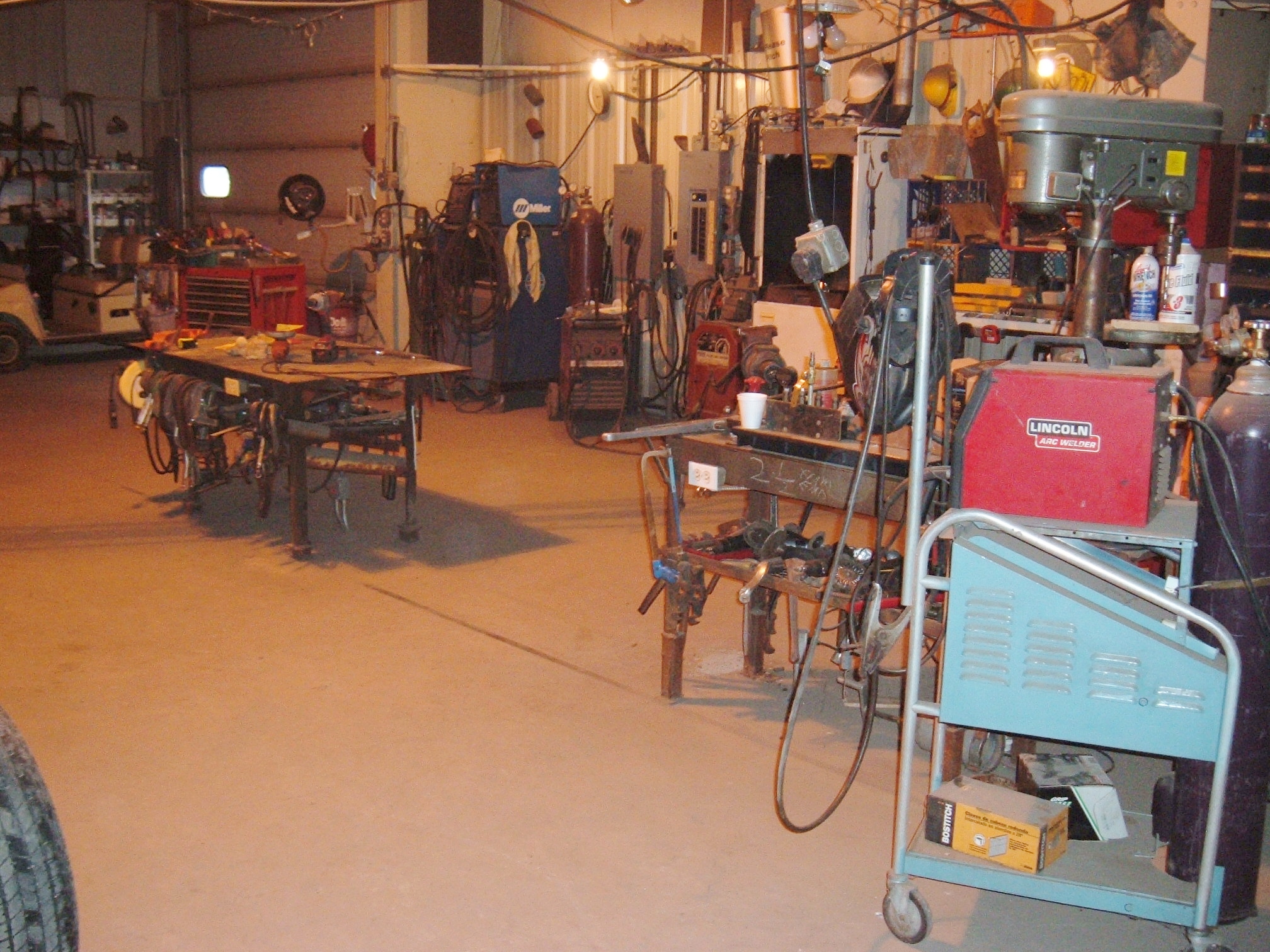

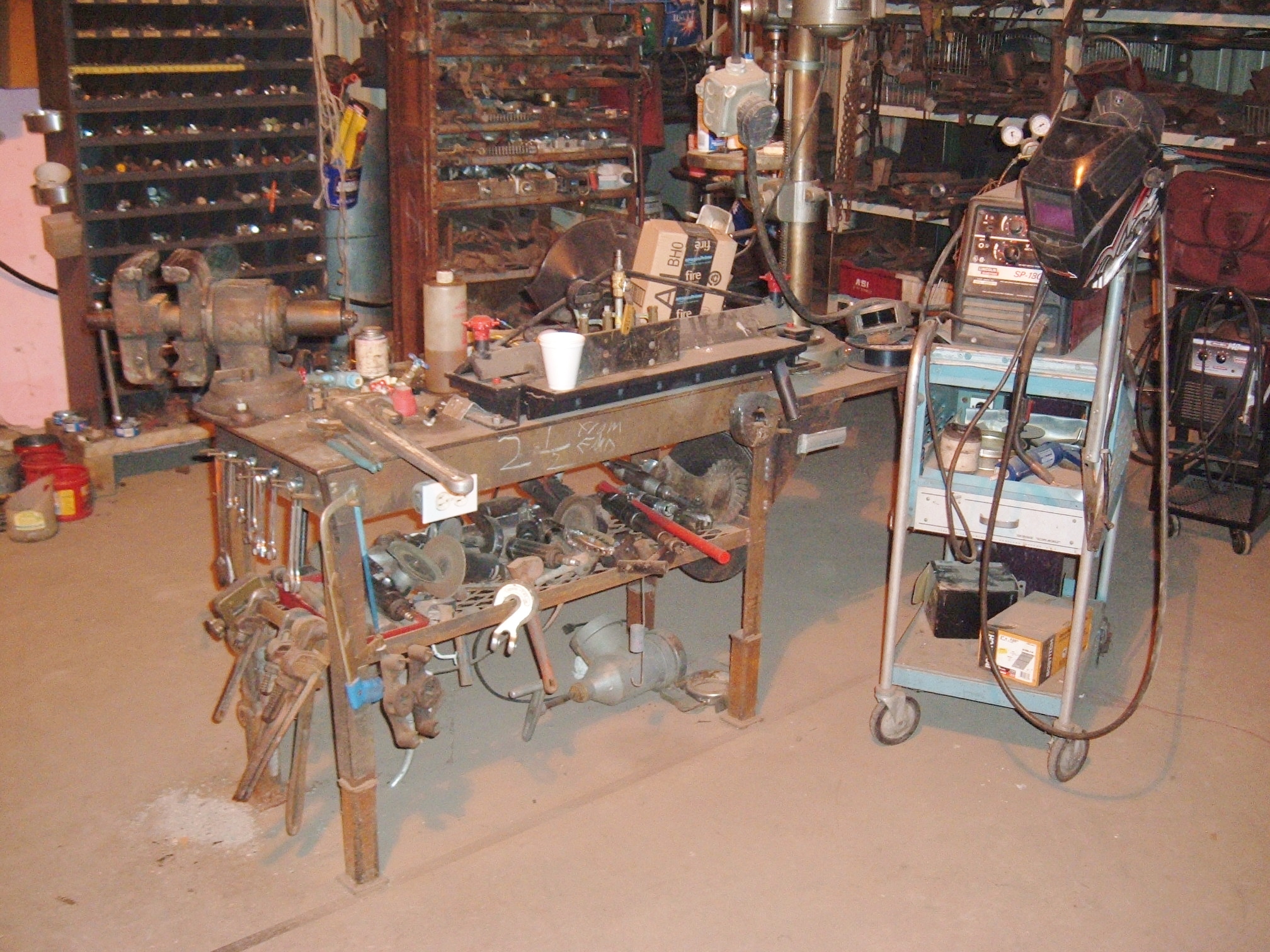

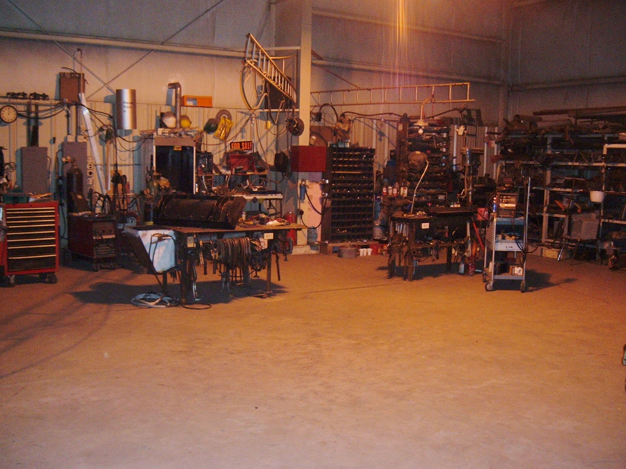

/ welder circuit #72
I heard of it happening but never did it either and I have ran a couple of them pretty steady at times. Mostly where it was really too small. Mine was too small the day I got it but had something in mind. Should have got another the same day 2x the size.
But today it's found it's spot and most used welding machine I own.
