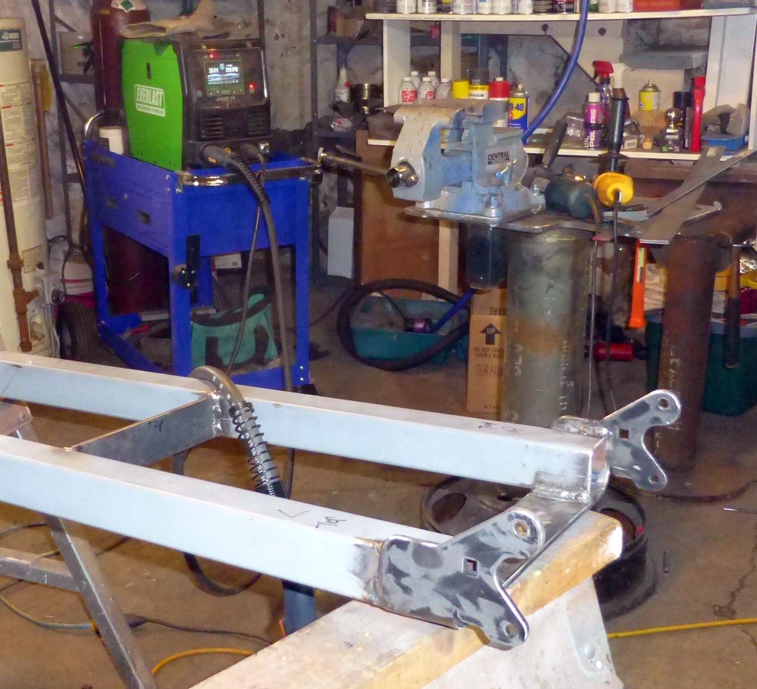

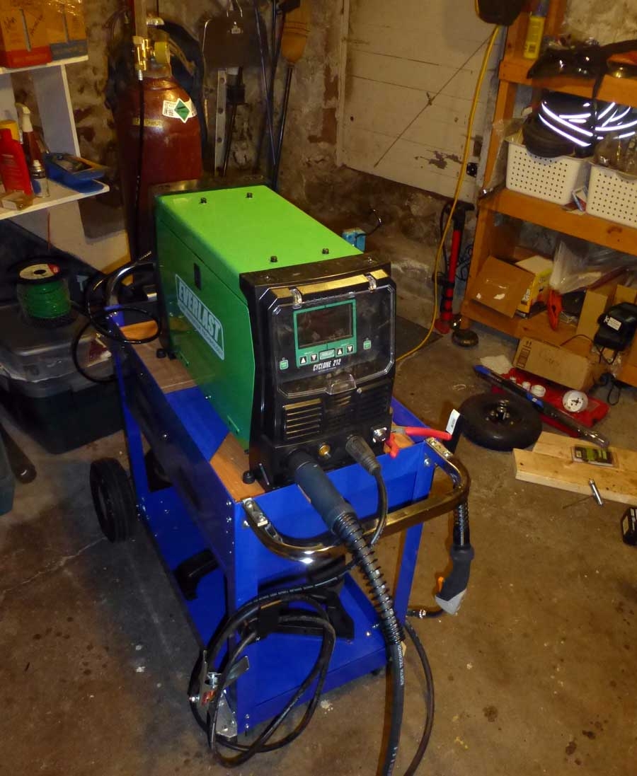

After years of welding stick and and some innershield wire, then switched to solid wire (MIG), I got myself a MIG when I wanted one for home.

thank you Eddie and Arly.
one of my nbors in the country has a NG relay station welding fabrication business.. I will learn from him. I just today thought of getting my own welder, but wanted to seek your thoughts first. I'll ask my nbor too. Arly, cannot read that make and model? Can you pls post your welder info
