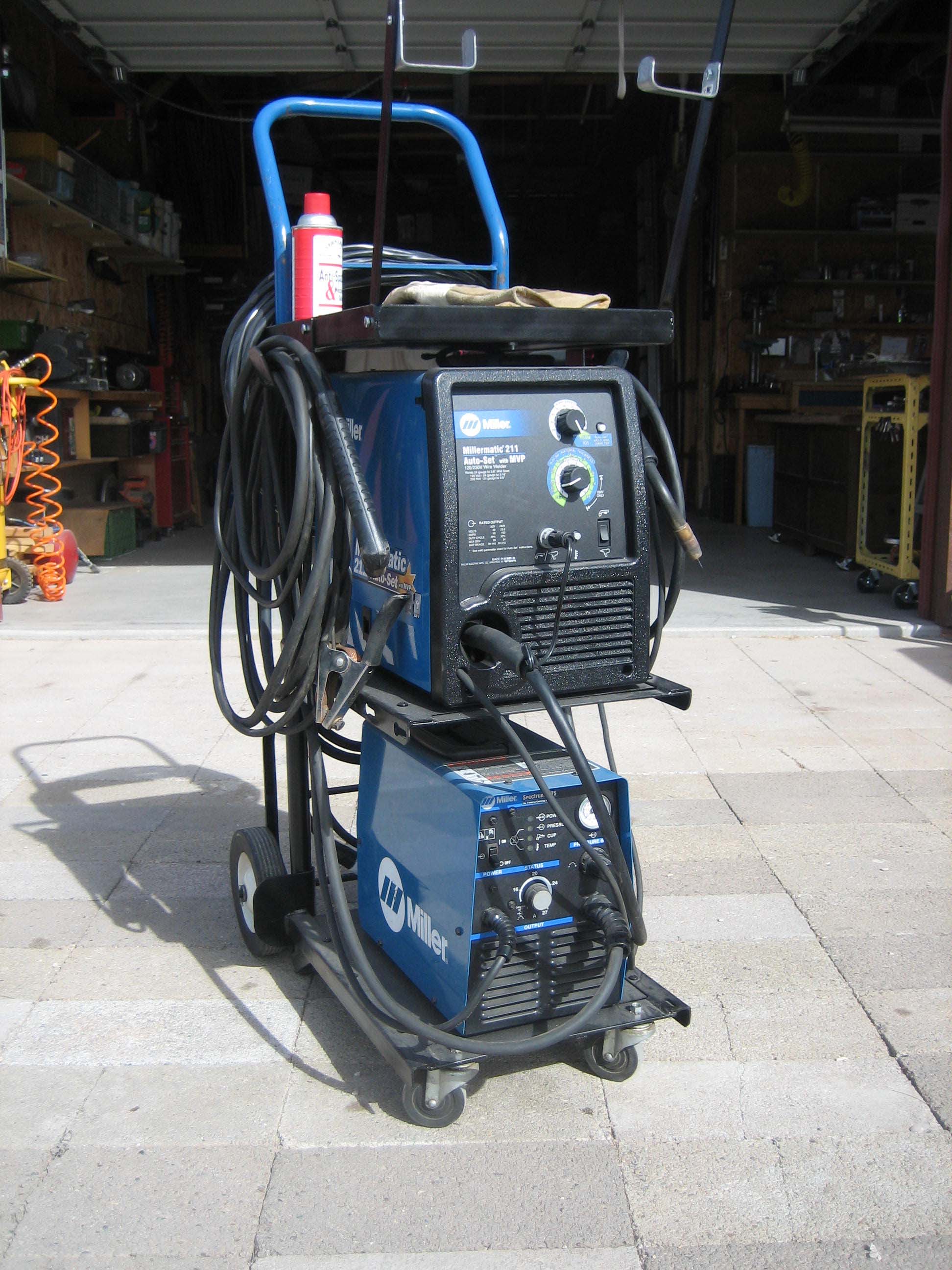

I'll have to agree with the Miller 211.
The option of 220v or 110v is very apealing to farm/ranch work. A great companion for the Miller 375 Plasma Cutter that is also a dual voltage unit.
However I still keep the o'l arc welder to do the heavy repairs...

I agree that the 211 isn't the be-all/end-all welder, but for $1300 I got a unit that runs on 110-230 volts, is portable enough for occasional jobs not around the shop, will run solid wire, flux core wire, and aluminum wire, and has a regular gun and a spool gun.
I plan on getting some more equipment this summer so I can run stick, tig, and plasma, but for now I can get just about anything done well enough with the 211 and an angle grinder.
If I planned on portable use more often, then a suitcase sized machine might have been my choice, but I'll be in my own driveway and garage 99% of the time and in that environment I prefer a traditional looking machine on a cart. As for durability and protection in transit, a moving blanket in the back of the jeep will keep the welder just a safe as the EPS packing material that Miller had in the box, and I will certainly be more gentle on it than the guys in the UPS hub were throwing it in and out of trucks and on and off conveyors.
