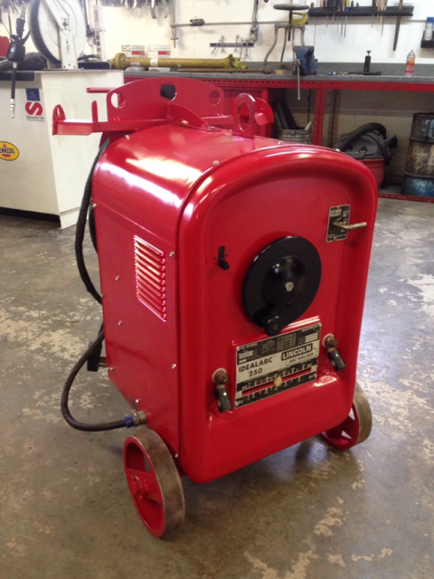

I have a 1937 Lincoln that is still going strong.:thumbsup:

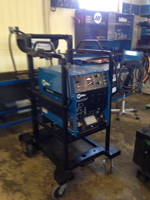

Shield Arc: Your welder's baby brother came along a little later, but still hummin'....
NB. Overspray on wheels have since been removed.
Terry
