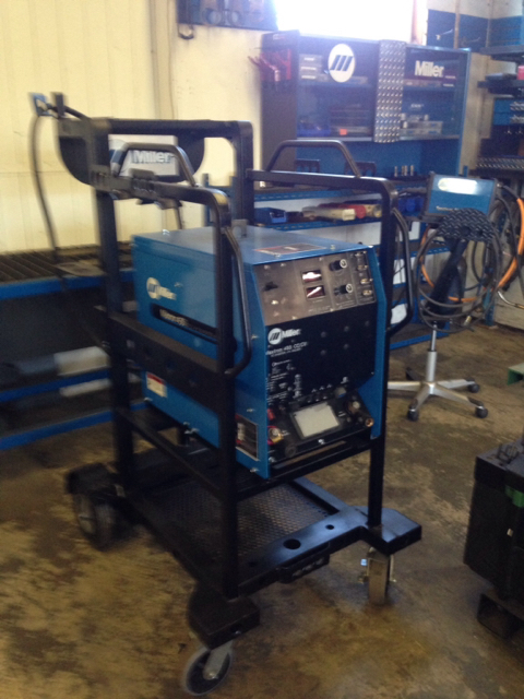

I didn't know if the Maxtron would work on single phase like the Invisions will, and didn't care enough to rewire it to find out.
Jim, the Maxtron will run on single OR 3 phase. (100% duty cycle @450 amps on 3 phase. )
Terry
Terry
I found that out a while later. I just hadn't tested that machine and didn't want to open it up at the time. I'd already made my money on the feeder so it was another $50 to pay for gas. :) Having the pulser and all the programs in the Invision, I didn't have any motivation to keep it for myself back then. Now I wish I still had it. I've got another Miller feeder kicking around and no power supply. :laughing: I could send them and an extra bottle of gas up to the cabin and have some real capabilities up there without having to move the Invision.
Heck, I've got a spare XR control and gun right now too. The gun needs new plastics that might not be available anymore, but it still works.
Darn auctions! :ashamed: :laughing:
