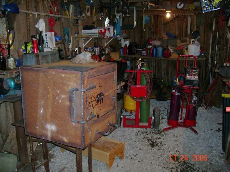

I think you might be seriously wrong... I own a Lincoln SP175+ along with a Hobart Stickmate... the Stickmate is hidden behind the box...
Here's a pic I found of the Stickmate, along with my Oxy-Propane rig...

   / Welding 1/4" steel- Mig or stick? #138
It's the firebox for the bbq pit that I built...
