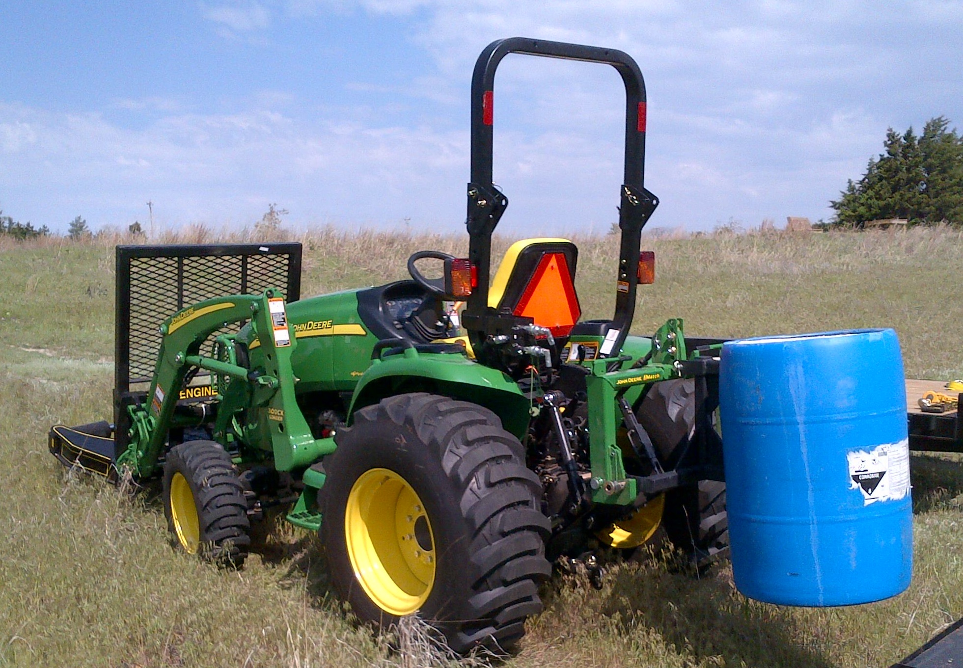

I built my ballast barrel with 1/4" thick steel using my 135 Handler. It's about 1/2 ton and hasn't fallen apart. Certainly a professional welder using a better machine could have done a better job. I don't know how I'd measure the benefit of that though since again it hasn't fallen apart.
