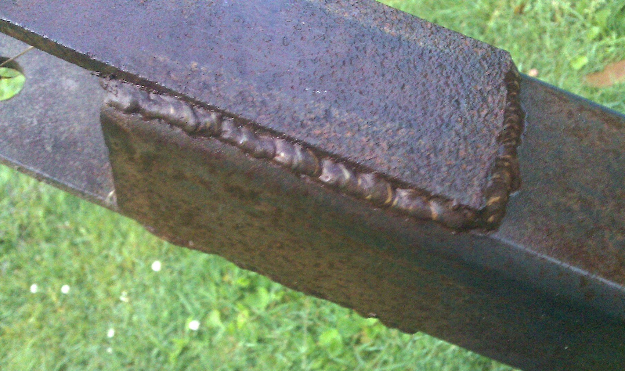

The problem is that you are being disagreeable and looking for ways to argue. A weld that needs more heat or a different technique looks the same no matter if it was done with a 120v mig, or a 3 phase 300 amp MIG welder.
I built my RTV trailer with a 120v mig and had nothing but helpful suggestions: http://www.tractorbynet.com/forums/welding/270953-trailer-build-my-first-real.html
From the latest addition to the trailer, 3/16" plate to a 3/16" tube. Weld was made with a Millermatic 211 running 75/25 gas on 120v with .030 wire (IIRC):
It had all it wanted to do to weld this and I tripped the 20 amp breaker at least once welding this on.
