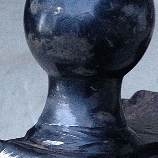

No grinding on the welds at all, just to take off a sharp corner. Hmmmmm well that's the internet for ya, everybody can be an expert, even me. I don't know about you, I'd have to see a little more from you than your assessment of my ATV hitch.
This.
   / Welding 3/16" & 1/4" with 120v wire-feed
#43
Not me - that was welded by Mr. Harbor S. Freight.:laughing: and he didn't grind it either.
In any case, my ATV ain't gonna bust it.

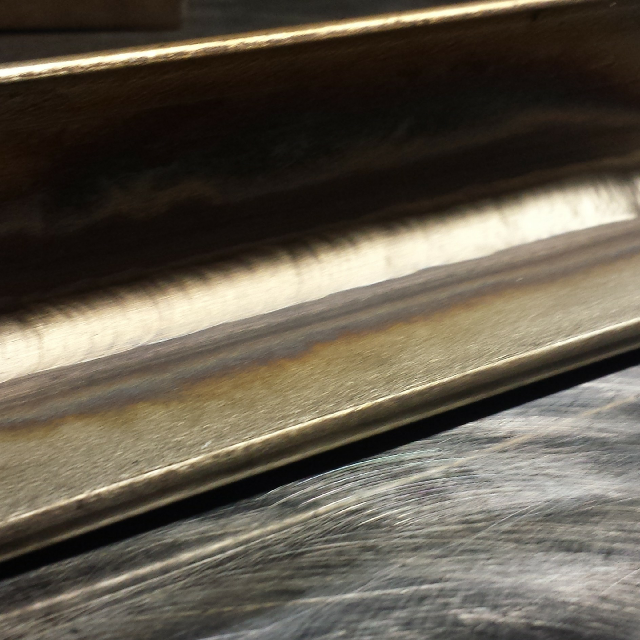

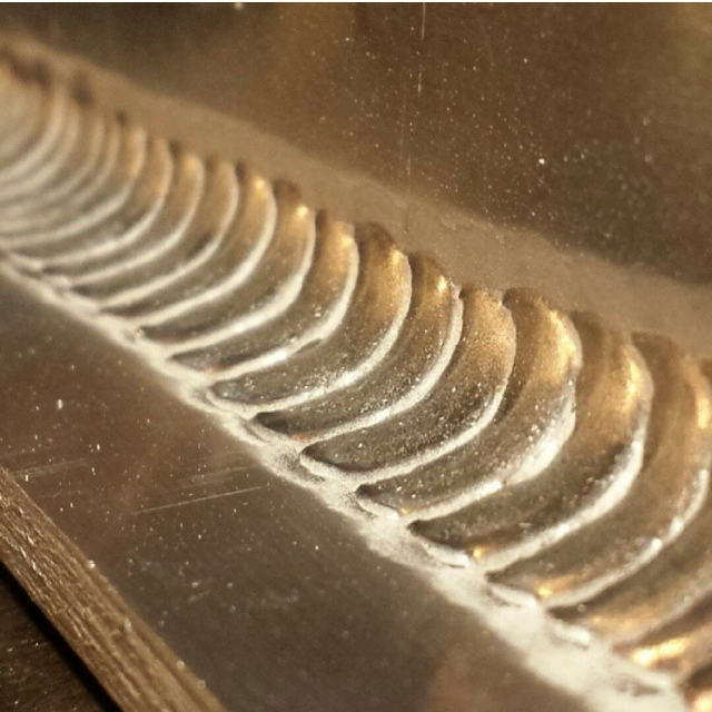

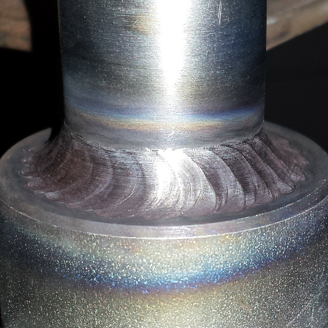

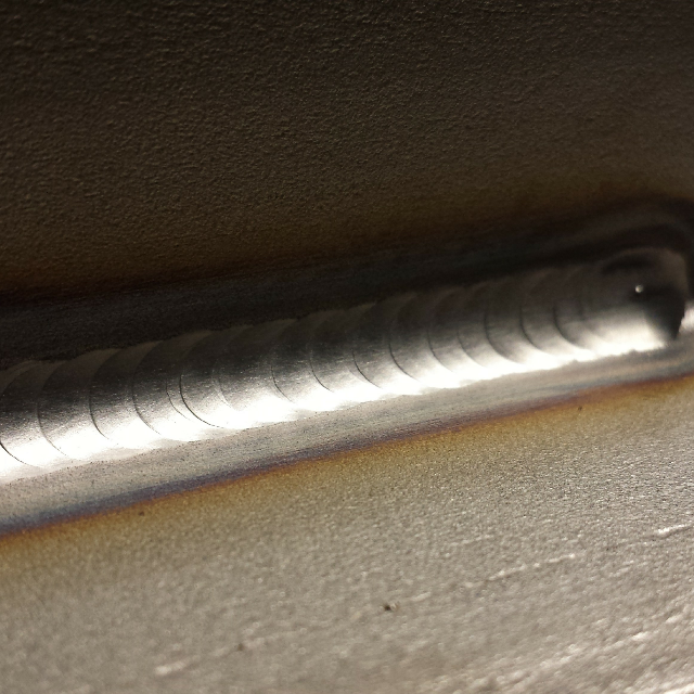

Heres a few of my welds as per your request.

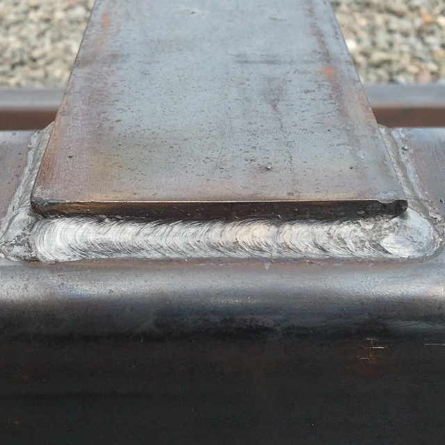

Anyway, here's a pic of a 3/16" repair on my car-trailer. The welds are strong as the base material, and better than most of the existing welds from the MFR. Which broke, (which is why I had to repair it). I use this trailer to haul the tractor and excavator since they are both less than the 5600lb capacity.
378788d1402440157-welding-3-16-1-4-a-foxtrailer-repair1-jpg
Well....this one I would have used a wire feed with more power. Or a stick welder.
My millermatic 210 is a really nice mig for this kind of stuff - I would recommend that size to anyone who didn't need the extra power and duty cycle of the mm250 class machines.
