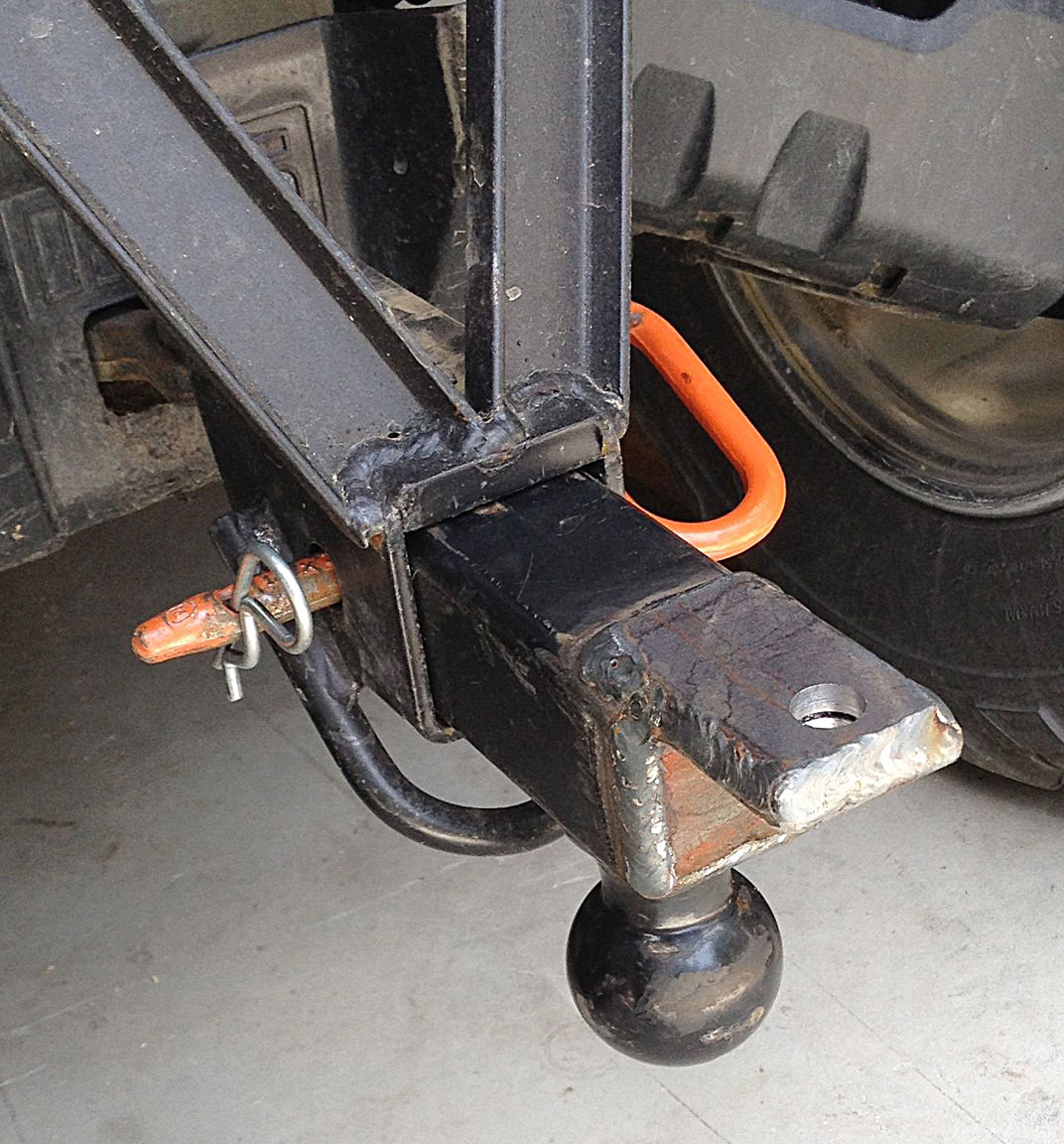

I'm not sure doing a groove weld on a 3/8" test plate is a definitive test for a 120 volt MIG. Groove welds by design make full penetration easier to achieve. I think a fillet weld break test would give a better idea of what it's limits are.
This is because a groove weld on 3/8" test plate will pass the bend test. Thank you for admitting it, I know it was difficult.:D

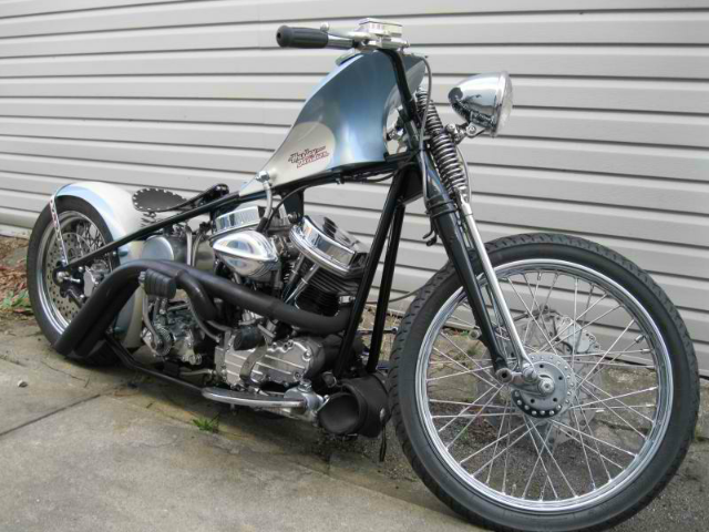

Thank you. I build for a living, my job title is welder/blacksmith and i repair and rebuild heavy equipment through Boilermakers local 5, and also run a small welding and fabrication shop for my self that is geared towards race cars, motorcycles and farm equipment. All i do is fabricate and build.
   / Welding 3/16" & 1/4" with 120v wire-feed #63
Nice ride Mike!! :thumbsup::applause:
I don't believe I've seen that pic on the other site - now my Road King is looking at me all nervous like "what? I'm still good right?" :laughing:

Thank you Dave. I put a lot of hours into that one. Minus the motor, tranny, part of the frame and some of the front end i hand fabbed everything as a one off. Tons of hrs.

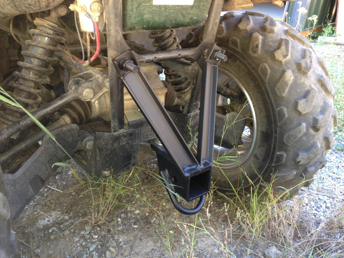

OK then can you tell me where this is going to fail, and what situation might fail it? It' has a large fillet on the backside too, so each of those supports has 4 inches of weld.
Undercut and sloppy means the equipment comes home still hanging. Cold lap means shlt is gone, on the highway, in a field, on someones head, or breaks off the back of a atv going up hill and crashes into your son with a pole saw hanging out of it that was following you. They serve a purpose no doubt, but just not for what most people believe. Dont be so quick on judging comments or advise.
Are you talkinng 'in general' or referring directly to this 120v MIG project that everyones seen pics of. If direct, can you give an expert assessment where it's going to fail?

Nah bud, i think you were just getting ticked off and swatting at everyone. I was speaking in general to everyone with the undercut/coldlap deal. And my "ONLY" gripe was that ground up weld on the base of the hitchball. I didnt have a clue that you didnt weld it till you mentioned it, so all is squared away with that lol.
I argued with someone a short while ago that you couldnt weld 1/4 aluminum with a 180a machine. He fought me to death till i proved results. Point being....i can do it, just as you pulled off quality results with your thread. Just not good practice for newbies that say.....yo, soto says its good im going for it! You know what your doing, and have experience and know how to manipulate the job at hand and make it work for you. Most people dont and only hear what they wanna hear and run with it. Thats all bud, all good hear, and didnt want a battle, but im a hard headed bastard myself and embrace it lol. Cheers brother!

I think this sums it up. Being in the tractor repair business this is what I see. The neighbor gets a little 120v wire feed. My customer says "hey can you weld this?", "sure" says the now professional welder. Now I'm out repairing the bird crap welds that lasted until the first time my customer used their machine. It's not that the machine isn't capable if used within its limitations, it's the wannabe welder that thinks that because he has a welder he can weld.
