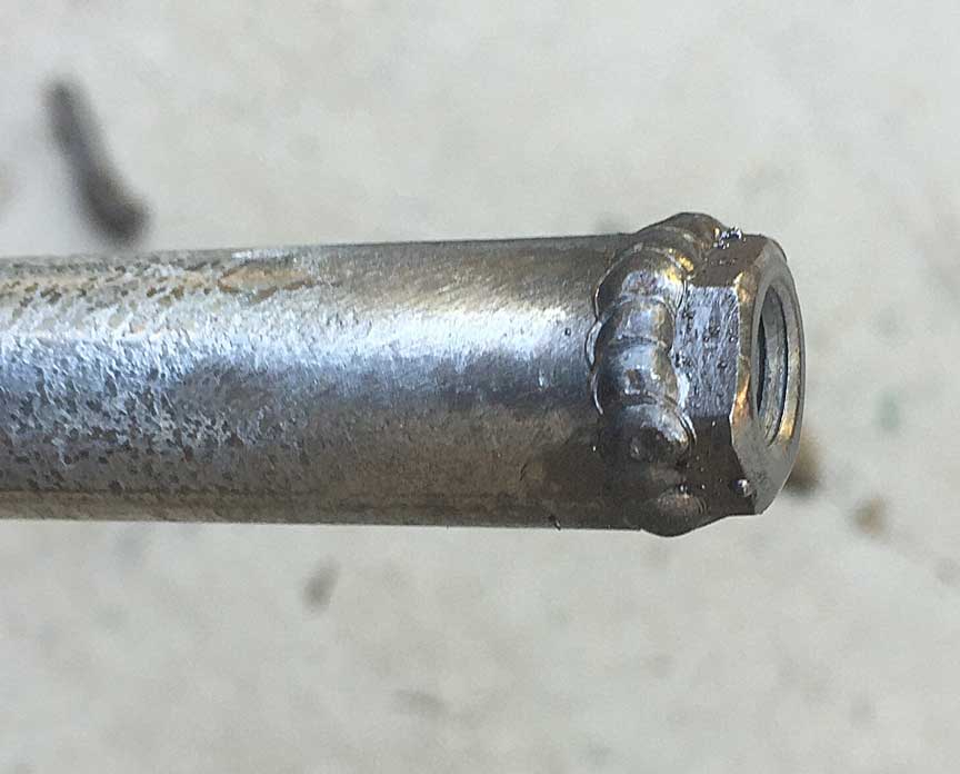

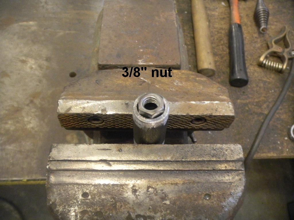

Heres an example with a 3/8-16 nut.

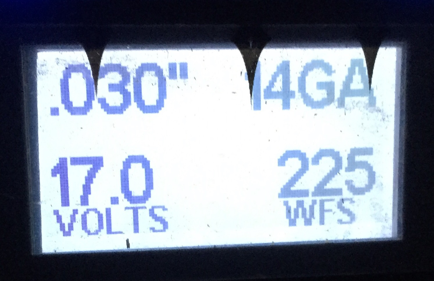

Probably should use 1/16" thickness settings on the MIG. This is using the 14ga setting, and its a little too hot. I wouldn't use 1/8" thats too much heat for this tiny part.
Not sure if this fits the bill for appearance. In my mind I thought I could have welded it nicer but in reality this might be as good as it gets (without grinding). If it were mine though - it would be rattle canned & "done" :D
Could try the pulse method. What is this thing for?

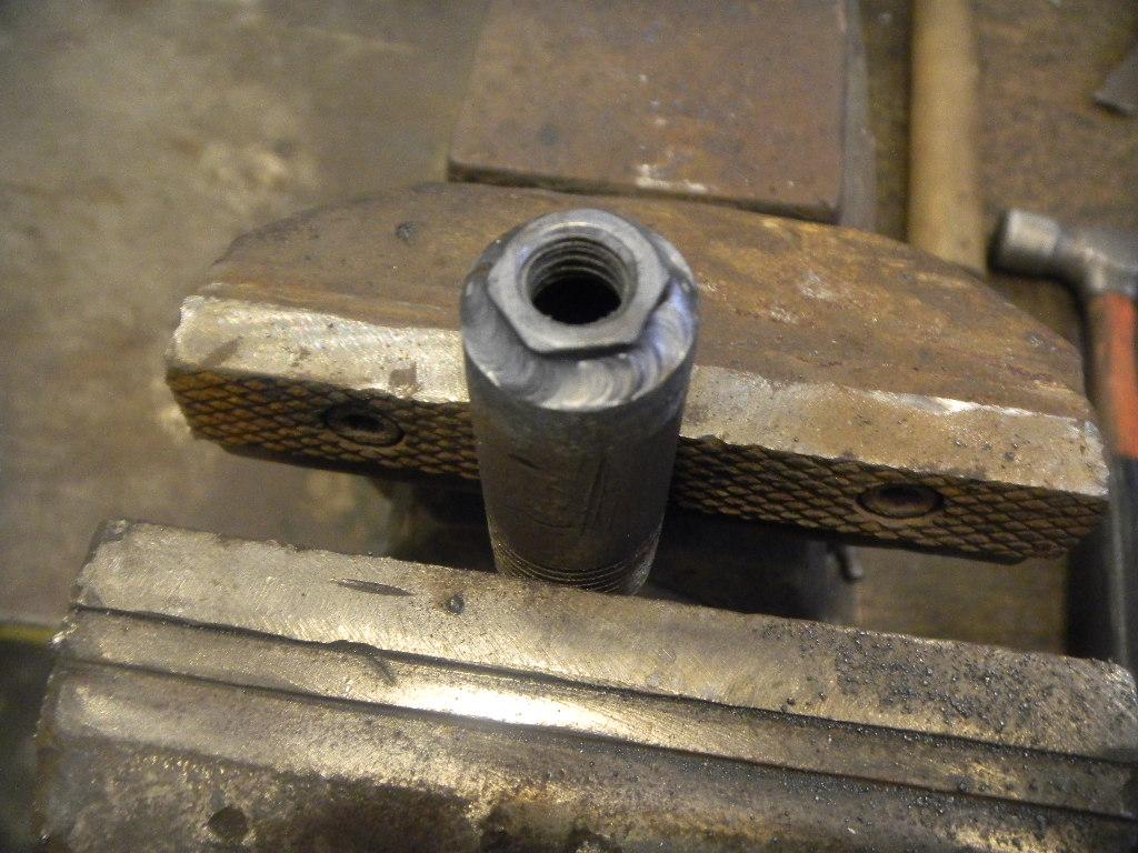

/ Welding a Small Part #66

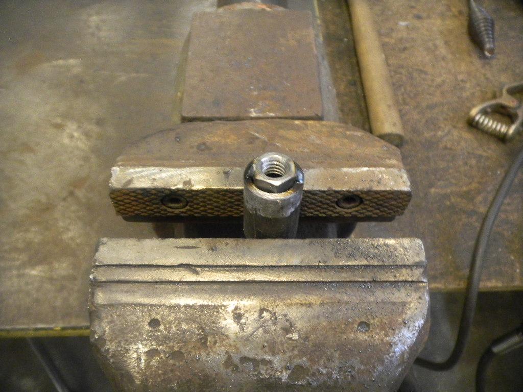

Tig welded.
#67
Sodo thx for illustration. That would do the job, I might be tempted to get the other faces same way.
Shield now do it MIG!

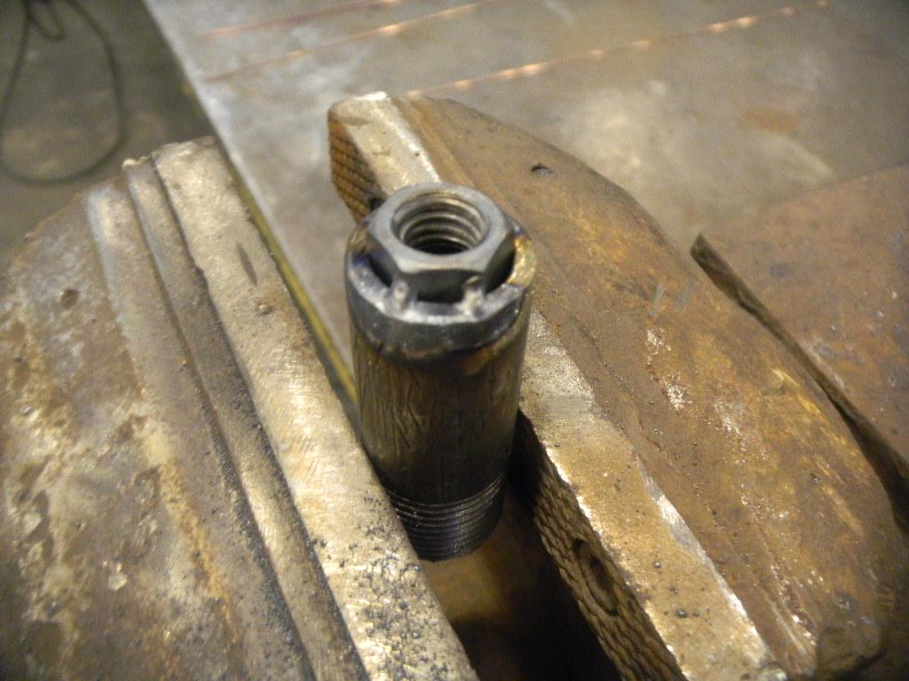

/ Welding a Small Part #68
TIG rules for small welds. Someday I will have one.

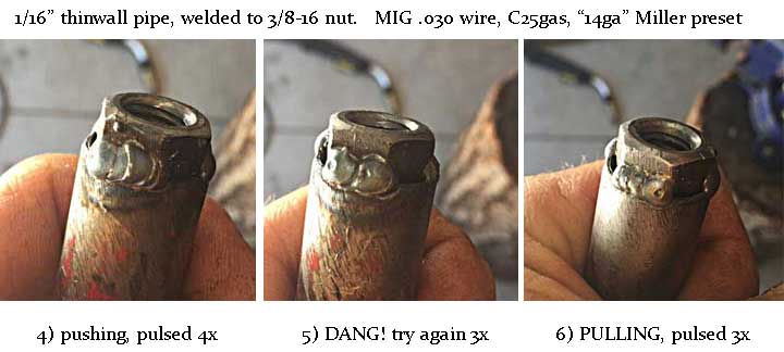

Here's welds 4,5 & 6. I think I got it.. By welds 7,8,9 I'd have it dialed in & ready for the final part. Hoping SA will get the MIG out!
428802d1433793088-welding-small-part-weld456-jpg
I recall now that "pulsed" is not the proper term for this method.
/ Welding a Small Part #70

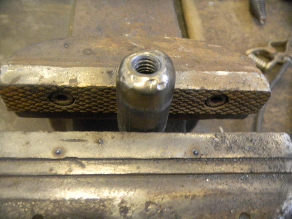

As requested;), Mig welded.

Awesome! A "flapper MIG !" :D
Homeowner models only have "dumb" presets but the pros prefer to dial in the amps, wire speed and grit. :laughing:

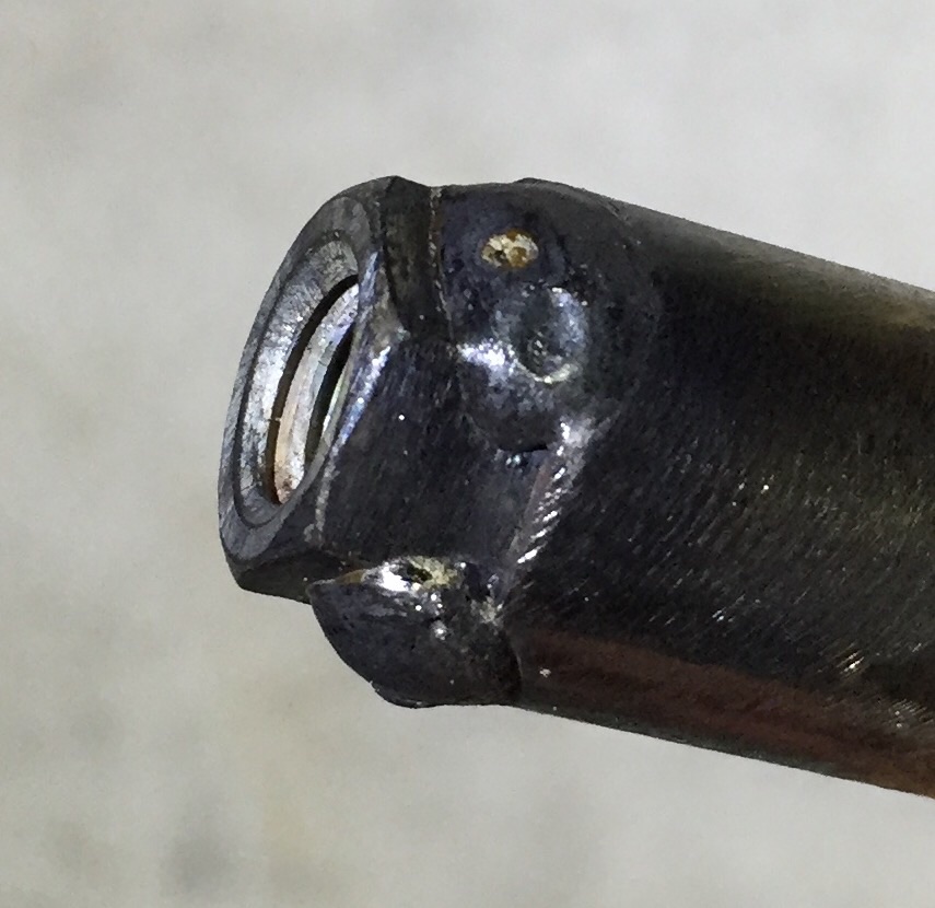

/ Welding a Small Part #73
Stick weld:
#5 (used) nut to cast iron gas pipe connector (all I could scrounge)
AHP in stick DC mode
68 seconds

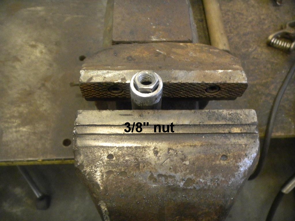

/ Welding a Small Part #75
Pat by the time you get to your welder this threads gonna be 12 pages :D

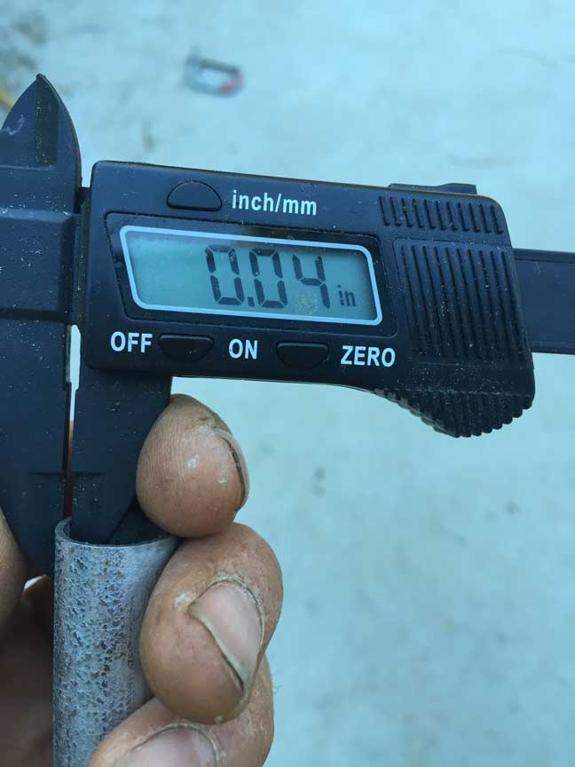

Heres another using EMT (1/2" conduit), and the 3/8-16 nut.
MIG setting still the same, 14ga (which is .10" thick) &.030 wire. This works pretty good.
428903d1433826243-welding-small-part-weld789-jpg
EMT is less than 1/16" thick
428902d1433826243-welding-small-part-half_emt-jpg

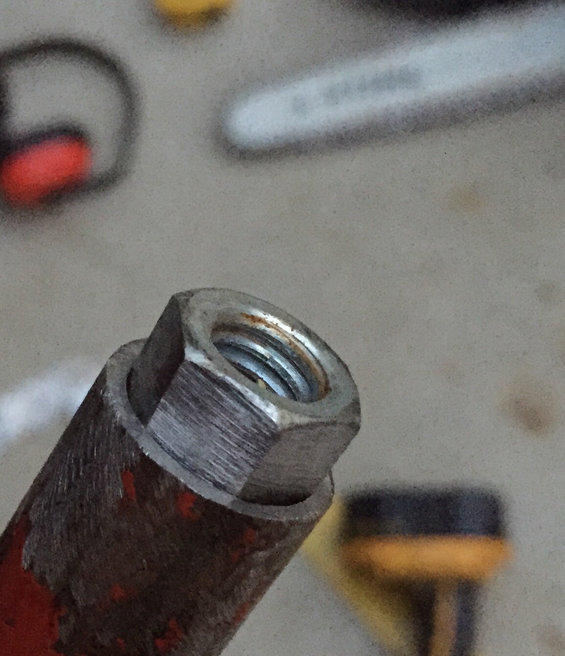

/ Welding a Small Part #76
If you are concerned about the strenght of the nut, see if you have any nut and bolt companies around and try to get a 2H nut. It will be much heavier and of better metal quality.
/ Welding a Small Part #77
OK I see what this part is for. NOT a precision welding project (other than for "sport") :D
428196d1433437959-hydraulic-quick-attach-mockup2-jpg
Seeing as this is an attachment to a hydraulic cylinder I think 3 tacks then MIG it all the way around in 2 or 3 welds then grind (if necessary) to fit inside that bore. What Shield Arc did. Not too hot, with concern for the 3/8-24 thread inside. I'd still use a 14ga setting. Looks like the whole part is hidden inside that SSQA pin (?).
#78
On the hardware, these days I get almost everything from McMaster Carr. They have a shipping center in Los Angeles. They have the extra wide extra strong nuts. The nut I am using is a high hex nut, same width as a regular nut to fit into the space available, but about 50% longer, I want the extra threads on the cyl rod end.
On precision, agree, it is not the space shuttle, but the end product has to be straight and concentric, that is why I went to the trouble of making a press fit lip to seat the nut in the correct position on the tube prior to welding.
I will be happy with any of the welds shown! And appreciate the advice and illustrations provided. Many thanks.
/ Welding a Small Part #79
You're welcome. We all had fun- I hope.;)
/ Welding a Small Part #80
The best way to make that concentric is to put a taper on the nut, and have the thru hole fit tightly on a shanked 3/8-24 bolt. Snug it down then do your 3 tacks it will be very straight.
